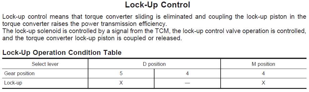

Here is a copy from the manual regarding the way the torque converter lock-up.
TC Lock.jpg (37.33 KiB) Viewed 15160 times
I also did a quick test this morning and can confirm that when in full auto (D), high range, the torque Converter (TC) start to lock at 120 to 125 Km/h depending on the load.
When in Tiptronic, high range, fourth gear (4) the TC start to lock at 105 Km/h.
When in low range, Tiptronic, fourth gear (4) the TC will start to lock at 50 Km/h BUT
When in low range, Full automatic (D) and fifth gear (5){I tried to count them from pull away} the TC start to lock at 40 Km/h.
Backing off on the throttle in low range or high range did not engage TC lock as explained by you the operation seem to be on the Ford. This in the 4.8GRX Autobox is handled by an over-run clutch within the gearbox to perform the engine braking to perform the action.
Looking at this you would need to keep this in mind when driving sand. If you are not able to get to fifth (full auto ), low range @ 40Km/h you would be better off going Low Range, Tiptronic, fourth (4) and maintain 50 Km/h as a minimum to get the TC to lock.
There might be some clever guys that can elaborate on this and possibly suggest better ways of utilizing this design and would appreciate any additional feedback.

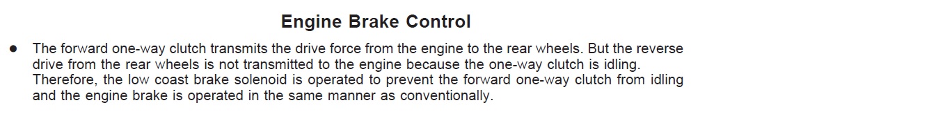

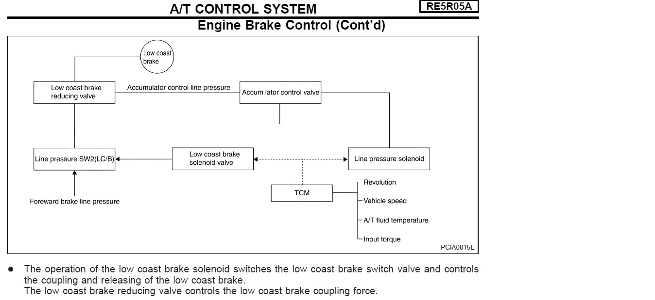

Guys, how does it work in overrun? In "D" at anything much below 120km/h, there seems to be no engine braking but if I go to manual "4" or lower there is engine braking. That leads me to believe that below 120km/h, if you want engine braking you get lockup (or some degree of lockup) only in manual "4" or lower.
Bruin Beer
Posts: 312
Joined: 15 May 2012 19:49
Full Name: Riaan Delport
Nickname: Rooian
Been thanked: 21 times
Re: Please explain how the gearbox work on my tiptronic
Post by Bruin Beer »
Clem,
This is a copy from the manual:
Over Run1.jpg (73.53 KiB) Viewed 15135 times
Over Run2.jpg (126.98 KiB) Viewed 15135 times
Hope this helps.
