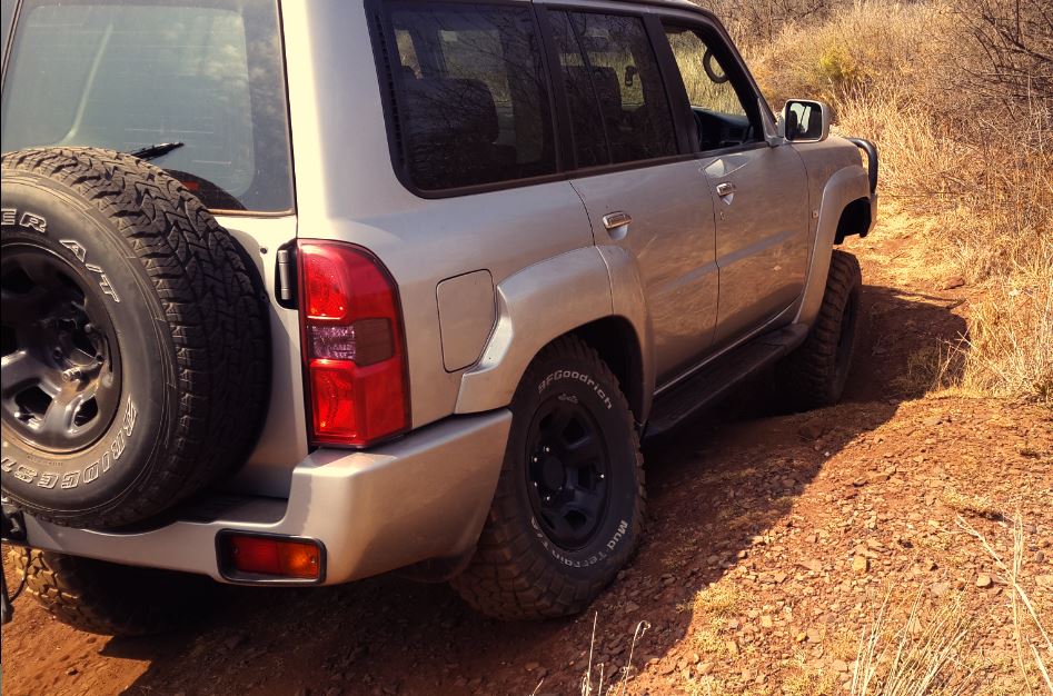

I went to Bass lake on Sunday to ride my 4.8 offroad for the first time. I could not get that silly locker to engage the light just flashes.
I have a 2009 model and it seems that the patrol had never been offroad before.

I was in 4 low and diff lock switch on. I then road over some axle twisters and got the one rear wheel in the air. The wheel in the air just spun so the diff lock was not engaging.
I think it could be a blocked pipe or relay problem. I will try changing the pipes around on Saturday and check power to the relay.
I have the TJM 100mm lift with good travel and muddies so diff lock was never required.

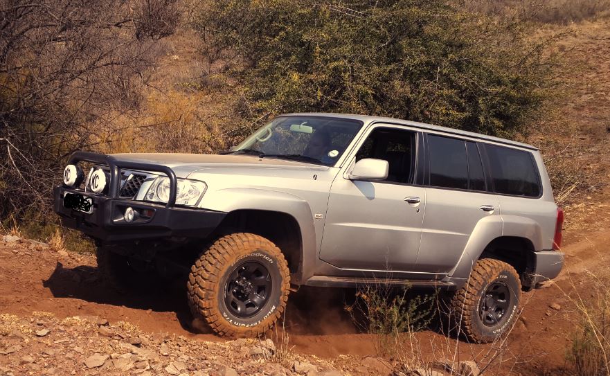

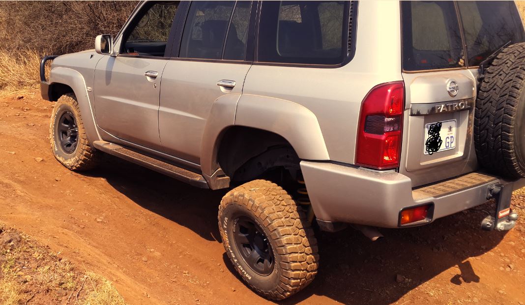

are you sure that patrollie has a 100mm kit in ????cant see nicely on the pics becouse you are flexing to much
