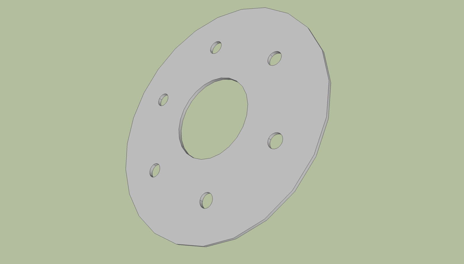

And it would only be an emergency use anyway in my case. Any chance of a picture of a spacer sometime Grant?Grant wrote:Other option is to have spacers made. I have had custom units made and they work very well.

I can take my tyre off on the weekend and take a photo of mine that Grant organized for me
- Been thanked: 473 times
Re: Rim/Wheel Options
I drew this up quick in Sketchup. The OD is just a guess, as well as ID and PCD. but this can be measured easily from the hub. Unfortunately Sketchup doesn't draw curves.... so it looks like the edge is made up of straight edges....
The thickness is 6mm. You can use down to a 3mm plate if you wanted to. I wouldn't go thicker than 6mm as you will want to lengthen your studs to ensure sufficient thread inside the wheelnuts.
