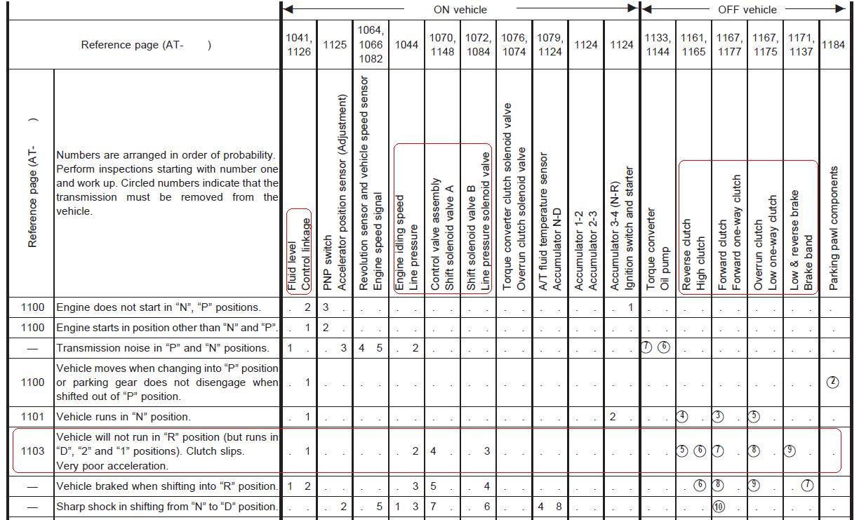

Here is the fault finding sequence from the workshop manual:
Hope it helps
