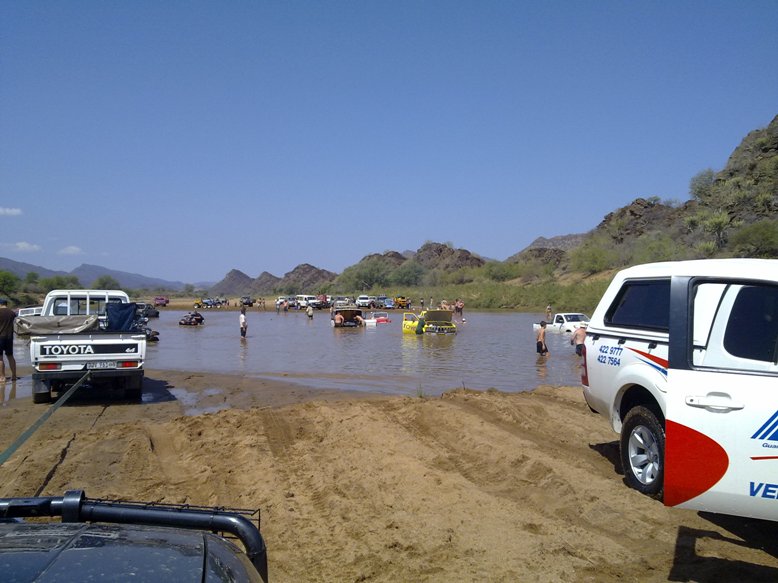

Deep crossing. Behind the LC pick up are 3 4x4's, a Range rover in the middle, the Ford on the right was properly drowned. Hilux on the right was saturated
Stuck 4x4's.jpg (89.16 KiB) Viewed 3055 times
I've been to the Olifants river challenge this weekend and experienced it first hand. One part of the river was DEEP. 60% of the vehicles trying to cross, got stuck and some engines took on water, others' electronics got wet, and it ended up being a mass rescue effort. A Land Cruiser pick up took up the challenge and I used my Patrol as an anchor, we took out 5 4x4 in a row. Then i crossed back to recover a stuck Ford bakkie. I must say I was very impressed with my Ironman 12000pd winch.

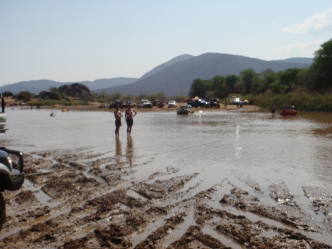

Patrol's nose on the left, Ford way on the right. I was anchored by 2 other 4x4's. Team work and spirit was Great amongst the drivers!!
So, water + electronics = :helpsign: . Keep it dry and fit a snorkel.
