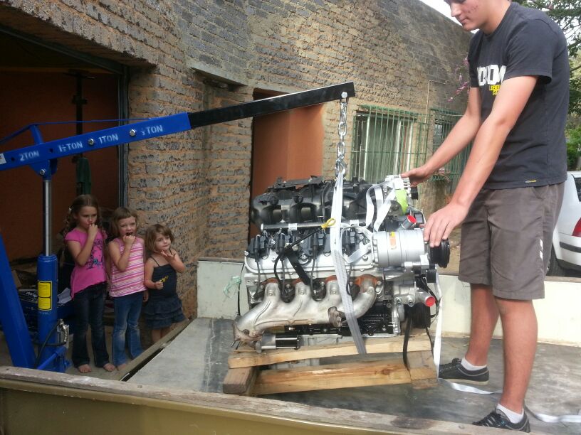

Engine loaded at US-Powersport
LQ9 15~3~2013.jpg (93.19 KiB) Viewed 17924 times

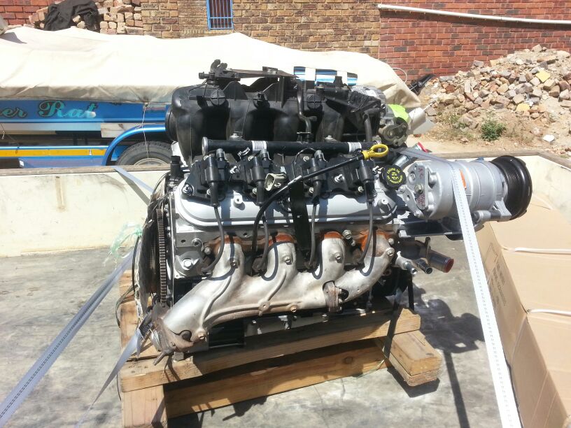

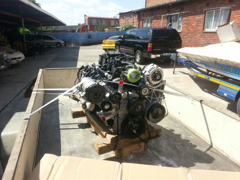

LQ9 15-3-2013.jpg (102.99 KiB) Viewed 17923 times
Do I keep manifolds or not?
LQ9 15 March 2013.jpg (112.23 KiB) Viewed 17923 times
more pics
Re: LQ9 V8 conversion
Looks good!!!!!I would speak to frans on the manifolds....all I can say a lot of people have had problems with branches on 4.8 wwith regard to lack of flex......looking forward to see the dino results :salute:
