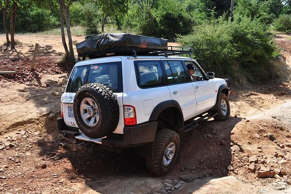

En die foto hierbo:
That was me flexing in the dongas at de Wildt yesterday
Dankie Oom!
Dankie Oom!
