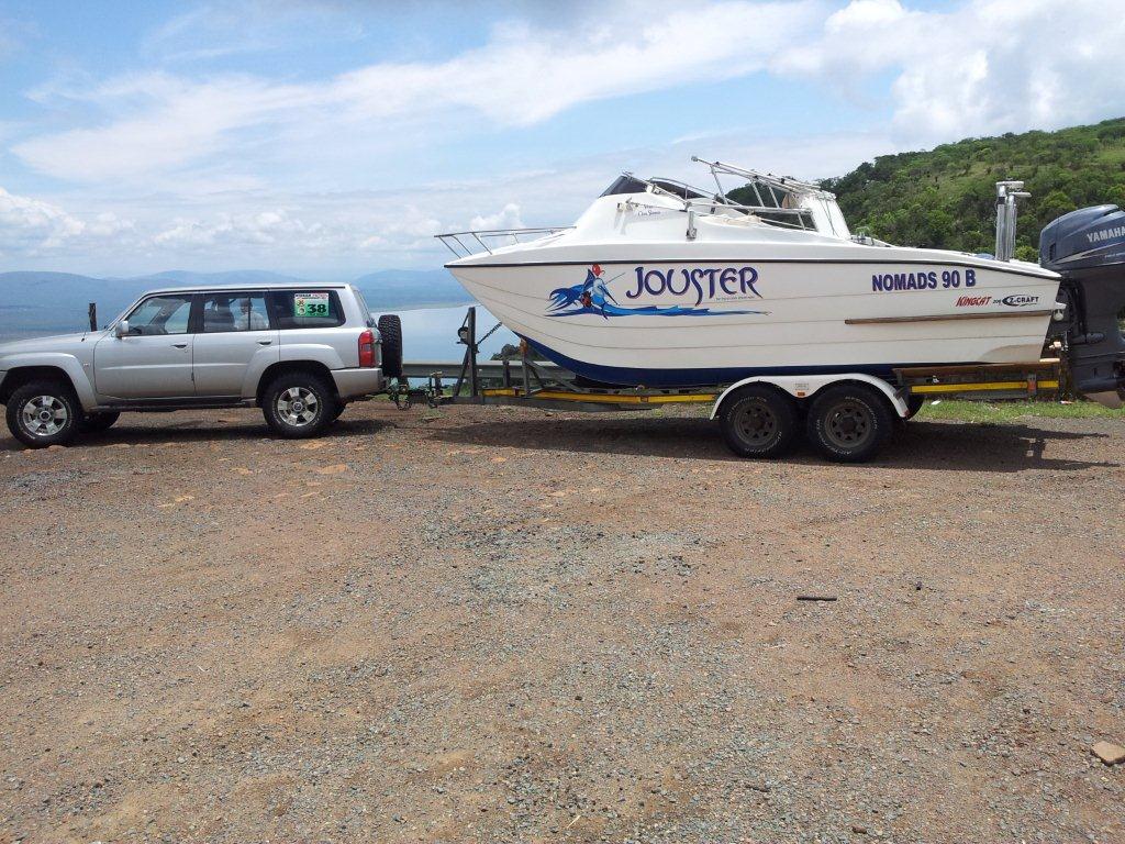

I tow a really heavy rig (3 tons) with my 4.8 and do not experience that problem normally.
I select 4th in manual mode and basically leave it there and tap it down to third when I need to.
In my experience, the hunting is caused by a bit of a heavy foot on the pedal. A friend drove my vehicle with the boat when I took a rest between Piet Retief and Bethal two ago when comming back from Sodwana while I rested, he had a heavy foot and I noticed the hunting. Not only did the vehicle hunt but I also noticed the gearbox temp starting to rise well above what I had experienced as normal while towing at moderate speeds and throttle setting (fuel use also soars). I find a good towing speed to be around 100kms, although at the coast the beast wants to run at 120 on the flat if I let her go - slow down and car will last longer and lower pettie costs.
Another tip - avoid towing in 5th!
- Troll and Boat on top of pass at Jozini Dam (Nov2011)

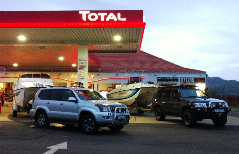

I tow a similar Zcraft skiboat as Chris with my Patrol - I have 305/17 tyres on which contribute to some hunting between gears dependent on driving style - found it easier and more mechanically friendly to drive as Chris has suggested.
I traded my Discovery on the Patrol because it used hunt properly towing the same boat - to the point that the autobox would get hot and then go into some "protect mode" which had me crawling up Schoemans Kloof.
Peter
Peter
