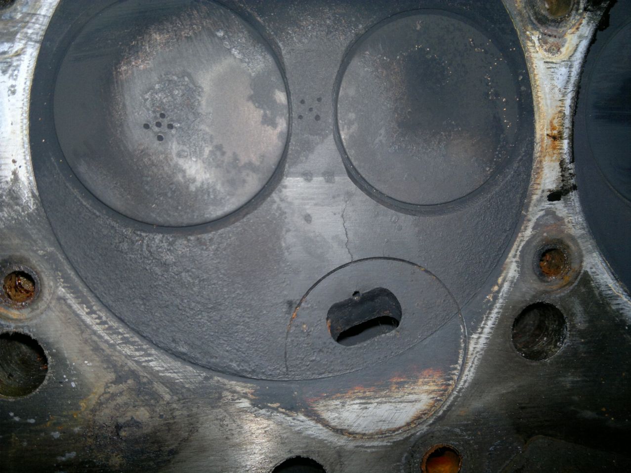

About a month ago my 99td42 started an overheating issue, so I started by replacing and checking everything water pump, thermostat,fan and visco clutch radiator and even belts and pulleys. Unfortunately a month later still the same and getting worse so this morning I took the head off and sadly there it was a crack on numbers 34and5 as Well as all the pre combustion chambers! Sleeves have a slight ridge But pistons look great from above so I'll take them out today or next week and post an update.

Your precoms will almost always have small little cracks on them. This is normal and acceptable.
The head is the main problem. Here you cannot compromise. I bought a new non genuine head from %$@%&&.... but anyway it turned out that the water ports were not allowing water to flow freely, and one was completely blocked. So Genuine Nissan is the way to go. Mark White Nissan assisted me with getting a new head and head gasket. Shout if you want assistance here. I think I still have Nissan the part number. I believe that the head I now have from Nissan is the head that can handle a turbo. I'll have to hunt down the e-mail with the part number.

That photo was of the non genuine Nissan head that failed on me after about 10 000km

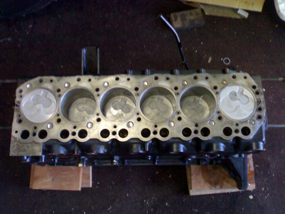

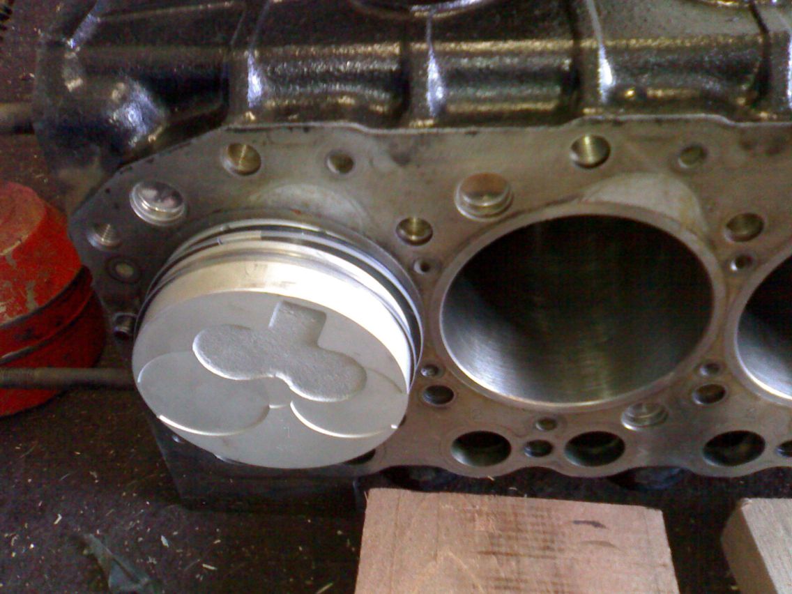

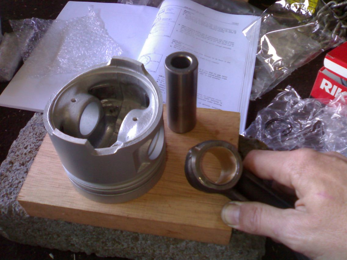

Well Sjoe thanx everyone for the tremendous response, the pistons look good from the top But the sleeves already have ridges run in the so they'll have to come out so its new sleeves rings big ends and mains and obviously gaskets and then the head and the aftermarket turbo and all the add ons for that. So at this stage I'm starting to lean towards a complete td42t motor if I can find one. As to the question of Why it had an overheating issue I still don't know, it never lost or used water never smoked badly or was low on power. The guys from silverton says its the age of the radiator so I'm having a new one built anyway wil post pics of everything as soon as I can. The pistons will be out by monday!
