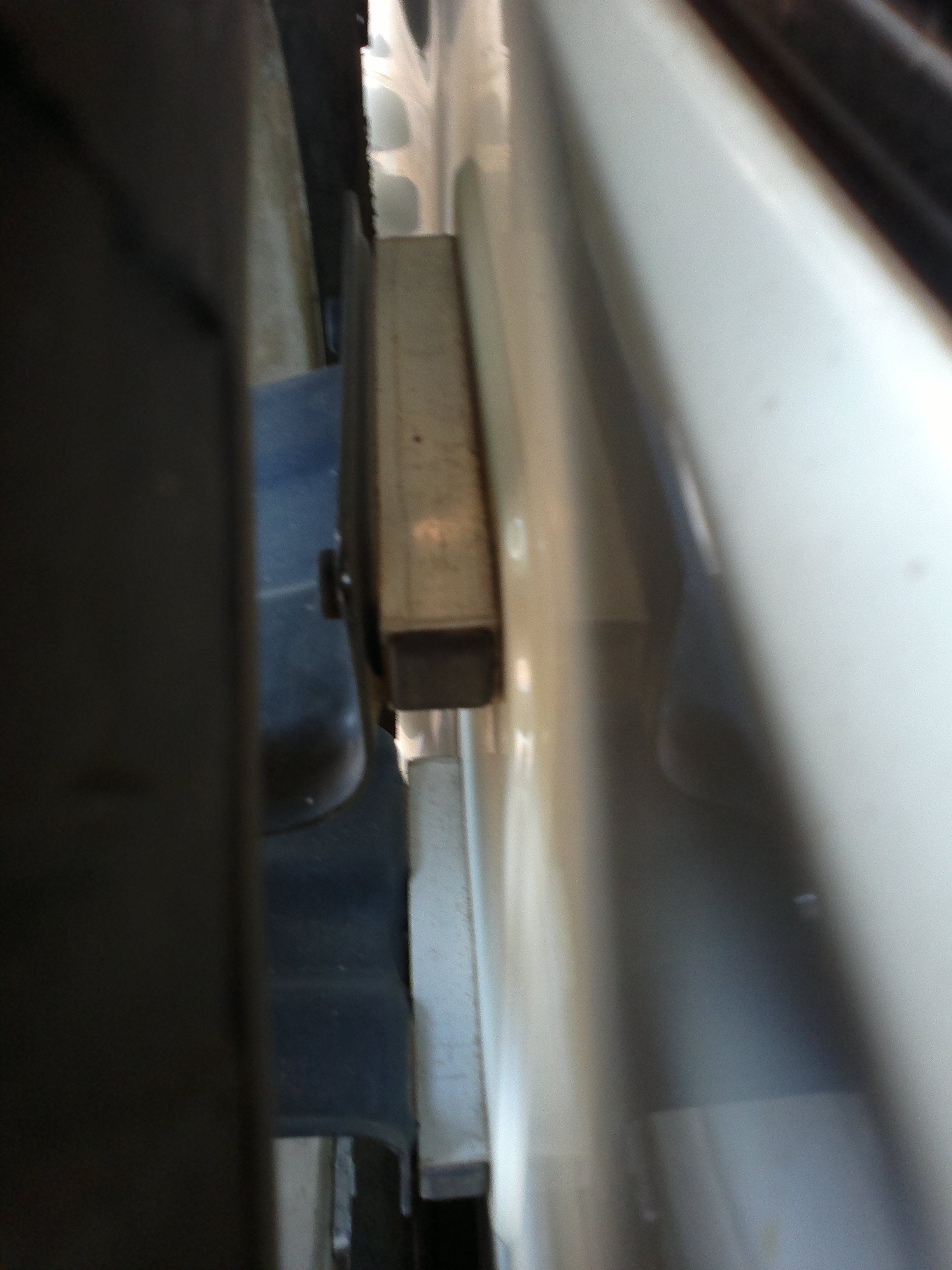

Re: 285/75/16 Spare tyre wont fit onto rear carrier
I just used 2 pieces of 20mm aluminium square tubing plugging the ends with plastic chair plugs. Most expensive part was the four longer high tensile bolts. Easy peasy
