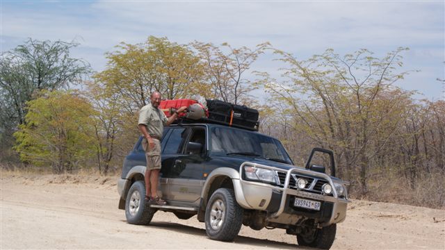

Well Herbie, empty the ride very nice - the wife has a very bad back and she prefer the Patrol were ever we go.
Last November we did the Botswana - Vic Falls trip with the Patrol very heavy -- 80l freezer, kitchen unit, roofrack, extra 50l fuel on the roofrack, extra deep cycle battery and plenty more and could not feel and difference in the ride comfort. It is just awsome!
On the photo it looks like there was a little sag in the back.
