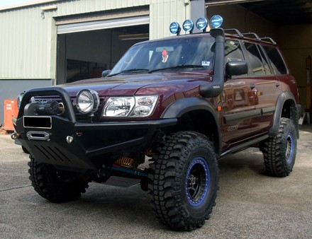

Why does this happen,have allready bought a new set,am just being carefull before i have them fitted. This is the bumper i am having fitted to the Trol,any inputs appreciated.

Can't help with advice, but that looks like one mean macjine. What tyres is it wearing?

That is Simex. Wish it was in ZA. The tyre is useless on tar, but nothing compares in the dirt and tar.Jorrie wrote:What tyres is it wearing?
Who is making that bumper for you?

Kobus from RED PEPPER is doing the bull bar back bumper and dual rock sliders.
