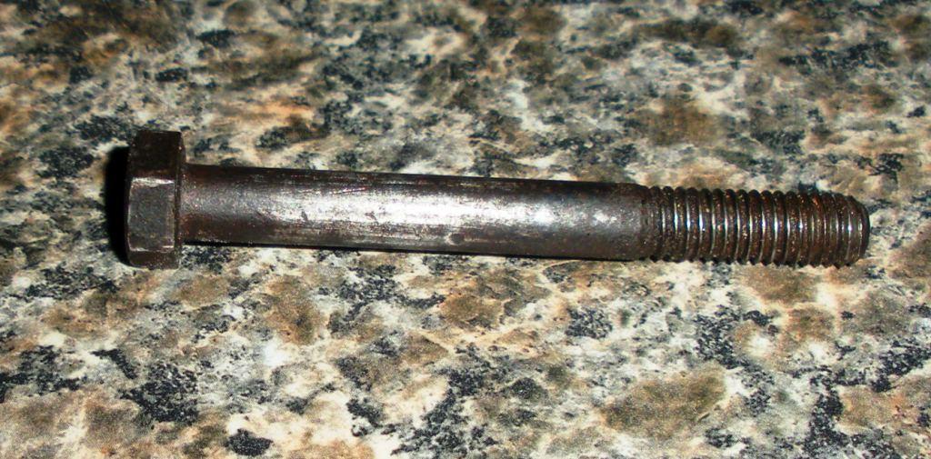

Re: Back diff and nuts getting very hot
I changed the discs, pads and found the calipers in order. To my disgust the problem had not gone away. After cleaning the bolts holding the caliper on, I found one of them to be catching ever so slightly. Below is a pic. Changed the bolts an bob's your uncle.
- Caliper Bolt.jpg (133.86 KiB) Viewed 3082 times
