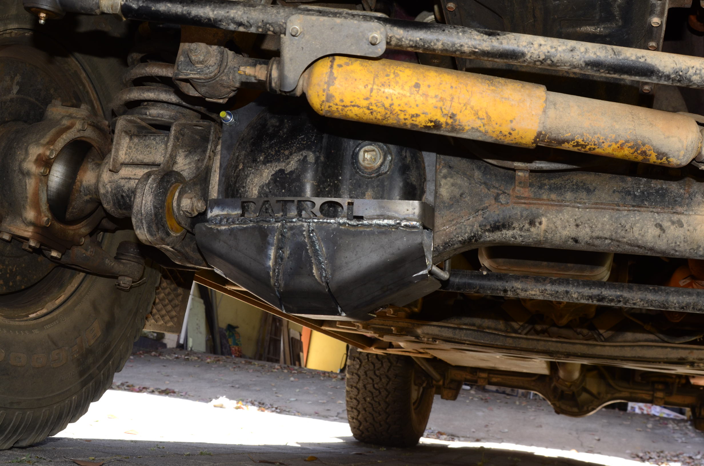

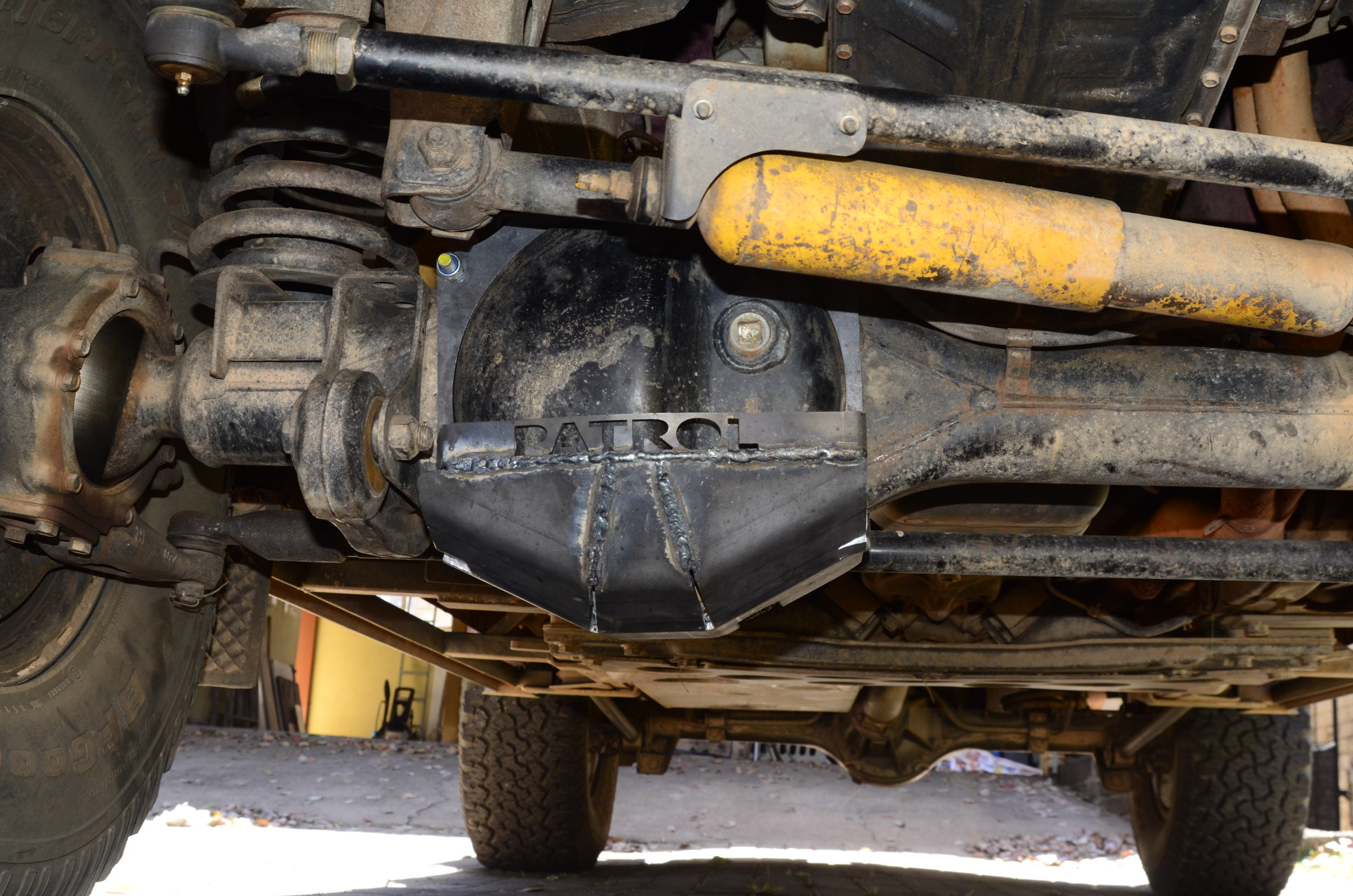

I finally got around to bolting the prototype of my diff guard onto my car this weekend:

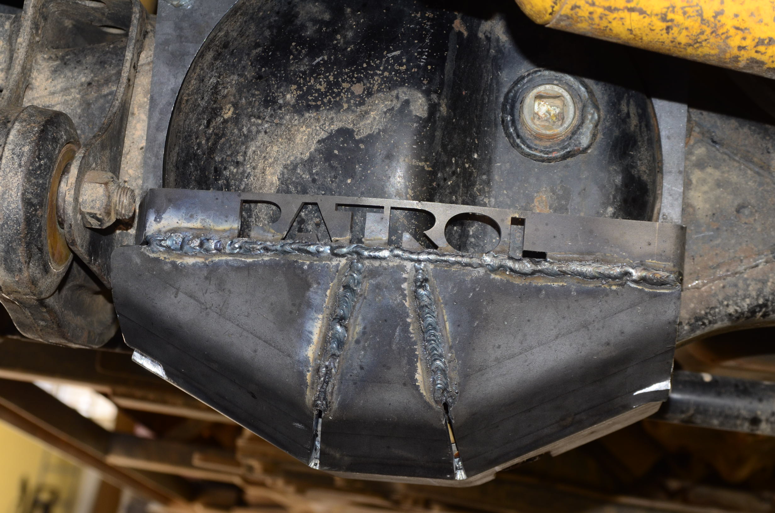

It has a flange that fits around the closure plate of the diff and is bolted to the axle casing using two M10 U-bolts bent from threaded rod. The flange is 8mm thick, the prection plate is 5mm thick and the nameplate is 3mm thick.
I have checked, it fits onto the 4.8 as well, so it should fit onto all the Y60 and Y61 models.
I haven't driven into anything with it yet though.
