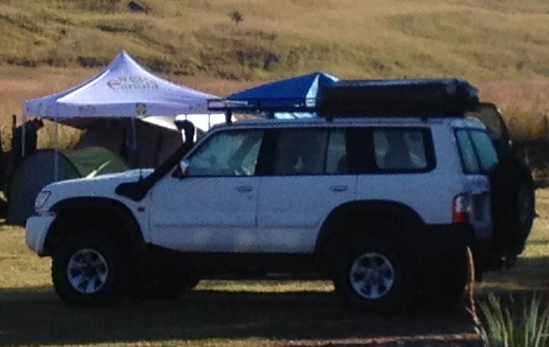

I have a 2" suspension lift plus a 2" body lift.
Besides the additional potential travel of the wheels, the body lift also helps to improve the approach angle a bit.
Other implications of the body lift is:
a) Your rock sliders (the kind that mount to the chassis) can be angled further upwards to benefit from the body lift - but then will not fit to the non-body lifted Patrol (if you were to sell it at some point).
b) The front bumper will leave a gap between the bumper and the body - since this is mounted to the front of the chassis. So the mountings to the front bumper needs to be adjusted to eliminate this unsightly gap. While my new front bumper was still being made by Ben, I needed the car and temporarily had the old factory bumper remounted.
The picture is added which illustrates the "gap" I am referring to.
