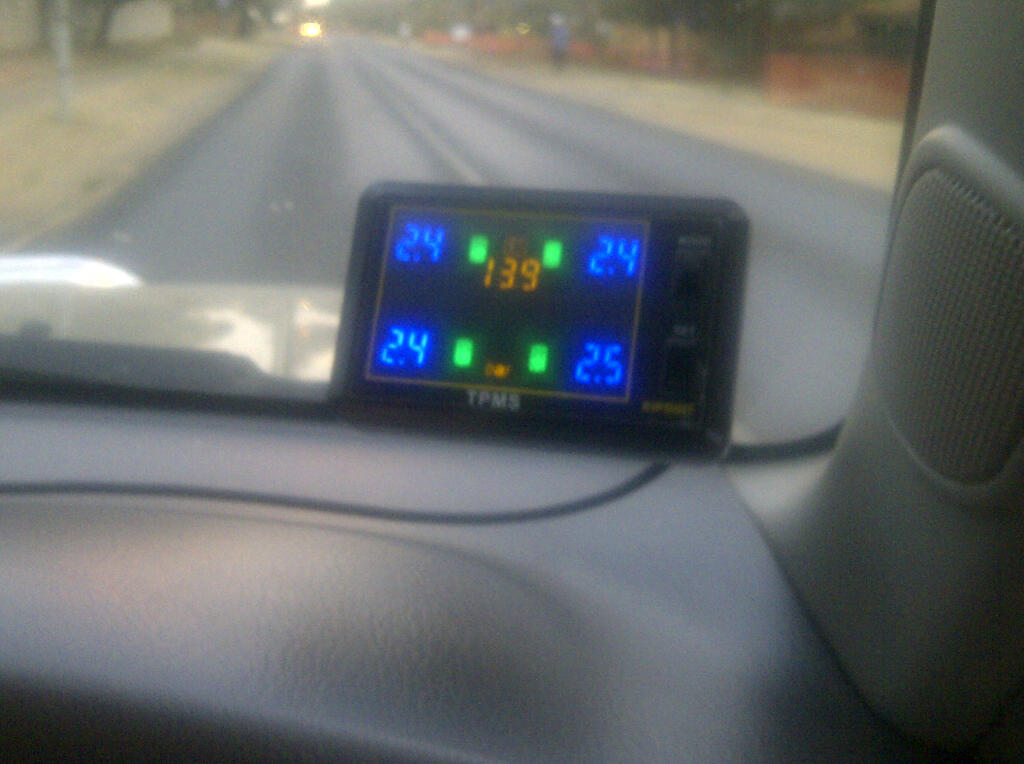

Can you post a picture of what the display looks like, one installed?

I am on my phone as you can see the spelling is bad but will try tonight :thumbup:

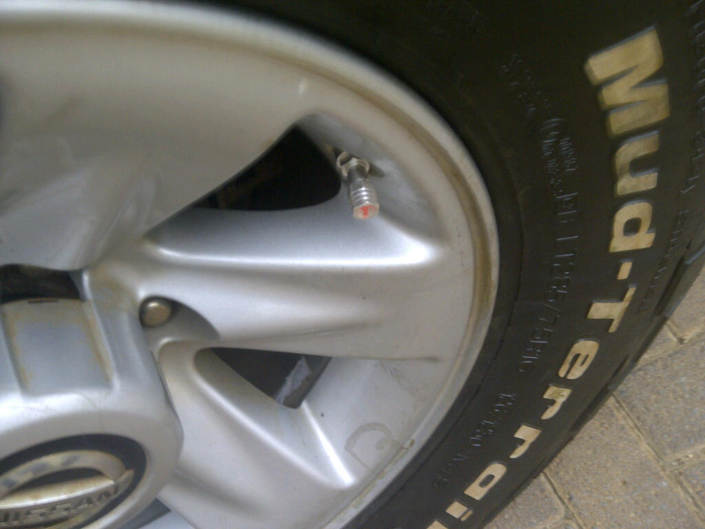

Tinus asked me to post these photos:
I will post some better pictures once I have installed my own set.
Just some additional info: Friend Marius (the guy importing them) has been running a set in his own car for about 6 months now. In that time he has done trips to Bots and Moz, and so far all is working well. The unit displays battery voltage (Marius has his connected to his dual battery, as an additional check on that batterie's condition) as well as readings for each wheel. This can be either pressure or temperature, or it can cycle between them. However, no matter what is on the monitor, a change in tire pressure of more than 25% from setpoint, or a rapid change in pressure, or a temperature above setpoint, or voltage dropping below setpoint will trigger an alarm.
It does not have an off-road mode, but in my opinion this is not important, as I do not always use the same pressure for off-road use anyway, and it is pretty simple to change any of the setpoint values.
There is also a unit available for six-wheel applications, and spare sender units can be sourced seperately.

Yes, Savuti, the sender unit is inside the rim.
The valve is effectively a normal valve on the outside of the wheel, and a standard valve spanner works on it.
You would need to re-program after changing pressures, or else it will keep sounding an alarm, but the programming is pretty quick and easy.
Re: Tire pressure theck magodi
That is the same as normal valve even the inside of the valve can be replaced with stanadard valve
We use the quick deflating tool with it sensor sits inside rim will get a pic and post it :thumbup: :thumbup:
