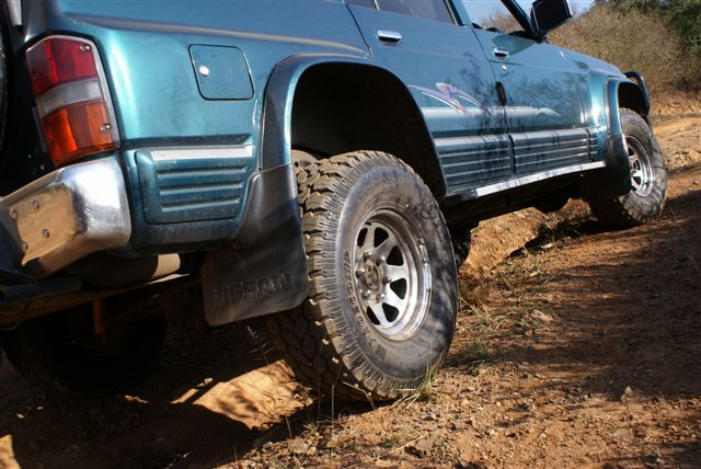

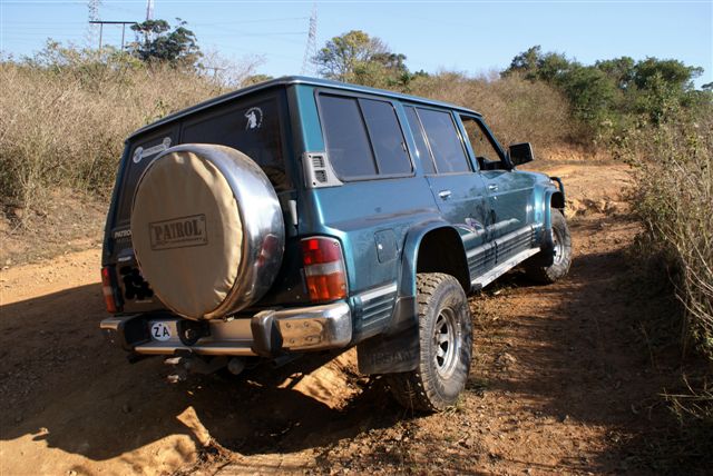

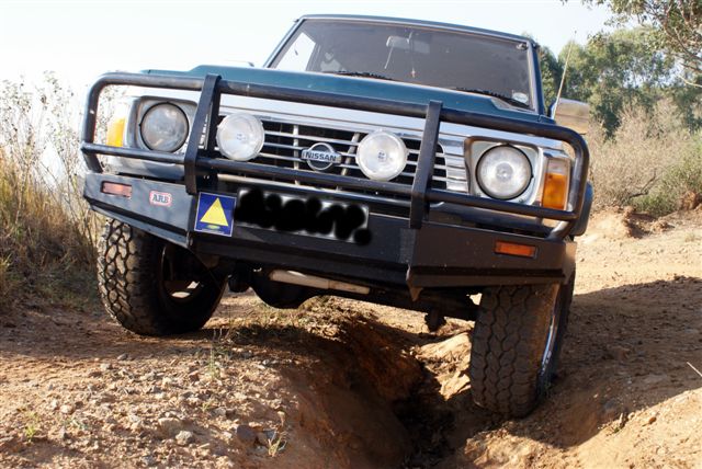

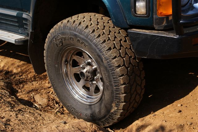

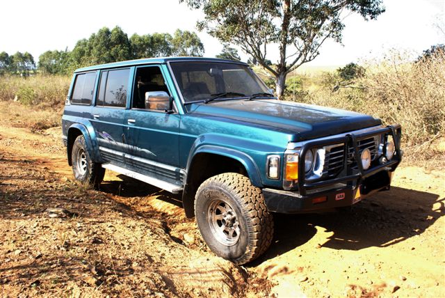

mORNING ALL
Got my tyres yesterday, at least my lorrie is not shaking , rock & rolling anymore when I hit 80km/h. Got 5 tyres for R7400 , they are running a special buy 4 and get the 5th one free, so it comes to R1480 per tyre, balanced and wheel alignment. This also includes VAT. Cannot actualy hear them much on tar and took a drive to the quarry for some dirt road, they say it has a 3 ply but it is defnitief more FLEX/SOFTER/SUPPLE than a BFG A/T. Going to uMfolozi game reserve on saturday and sunday and will run them at 1.6bar on the dirt road, currently at 2.4bar they are somewhat bumpy on the dirt.
Here with some pics
The best part it comes with a mileage guarantee of 68 000 - 80 000km but you need to have them rotated & balanced every
7500km
Here with some pics
7500km

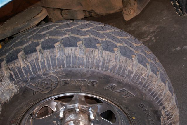

I also fitted my Pro Comp extreme AT's last week. They are 285/75/16. I will try them in Lesotho and the Namib dunes in August.

Just remember, they are directional tyres. The V pattern on the tyre grooves shows you the direction your tyre rotates. Your right hand side tyres are facing the wrong way. You wil experiance aqua planing on wet roads. ( water build up between the grooves)

Wheels I saw that this morning when I took the pics, went to the dealer he also saw and apologised, will be corrected on Thursday, now I know why you are called wheels ( Jy ken jou wiele )
