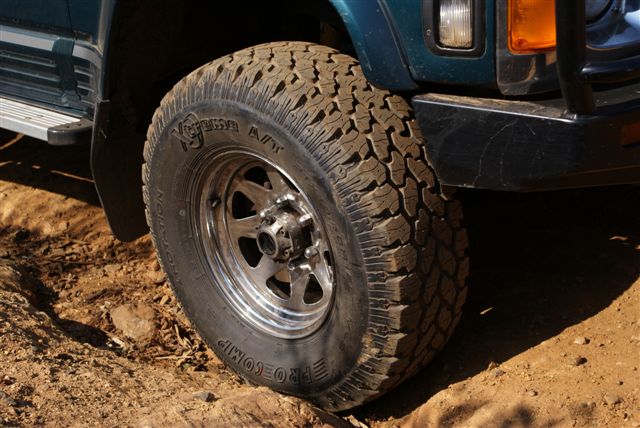

Jules what do your 7jj rims look like, any pics perhaps?

Re: Wheel and tyre advise
Post by Jules »
Hi Russ
Original Patrol rims
Pro Comp pic 5.JPG (63.61 KiB) Viewed 12205 times
