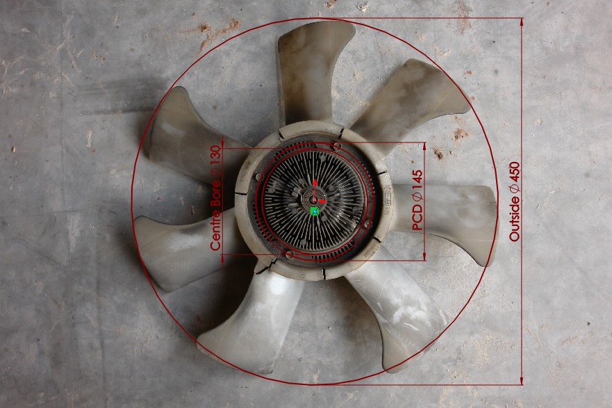

I have just spoken to Elaine, she has bought the business it is called Auto Cooling now ( 021 - 98two711four ) I have attached the pic that Marinus Potgieter have previuosly loaded, she has 3 sizes in the P64 so I need to measure some tonight, price is R450 I presume excluding VAT

Hi
These are the measurements they required when I ordered mine.
Hope this helps.
Hope this helps.
