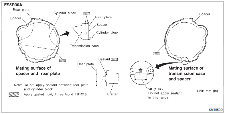

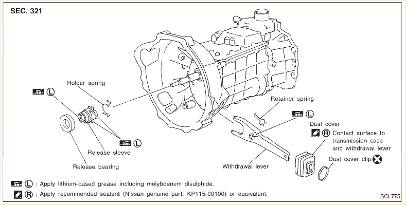

Sems to be true! Nissan's electronic service manual shows that sealant must be placed on the dust cover of the withdrawal lever, as well as the mating surfaces between the transmission and the engine.
I remember seeing a rubber seal/grommet at the bottom of the bellhousing that you can remove to drain any water that might have made its way inside...

Be careful here boys, i just noticed, marked in the top corner of the diagram, that this is the FSR30A box,which i believe was only used with the RD28 motor. As far as im aware, and according to my manual, All TB42,TB45,ZD30,TD42 models made use of the FSR50B box. And i cant find any literature on Sealant in regard to the 50B box.
Maybe just check if you can find the 50B box on that Electronic Service manual first.

Re: Clutch Kit
Hi Russ
Here is what I find for the 50B. Also spoke to Alleric in Stikland who also confirms the use of silicone if you are someone that is likely to do water crossings.
