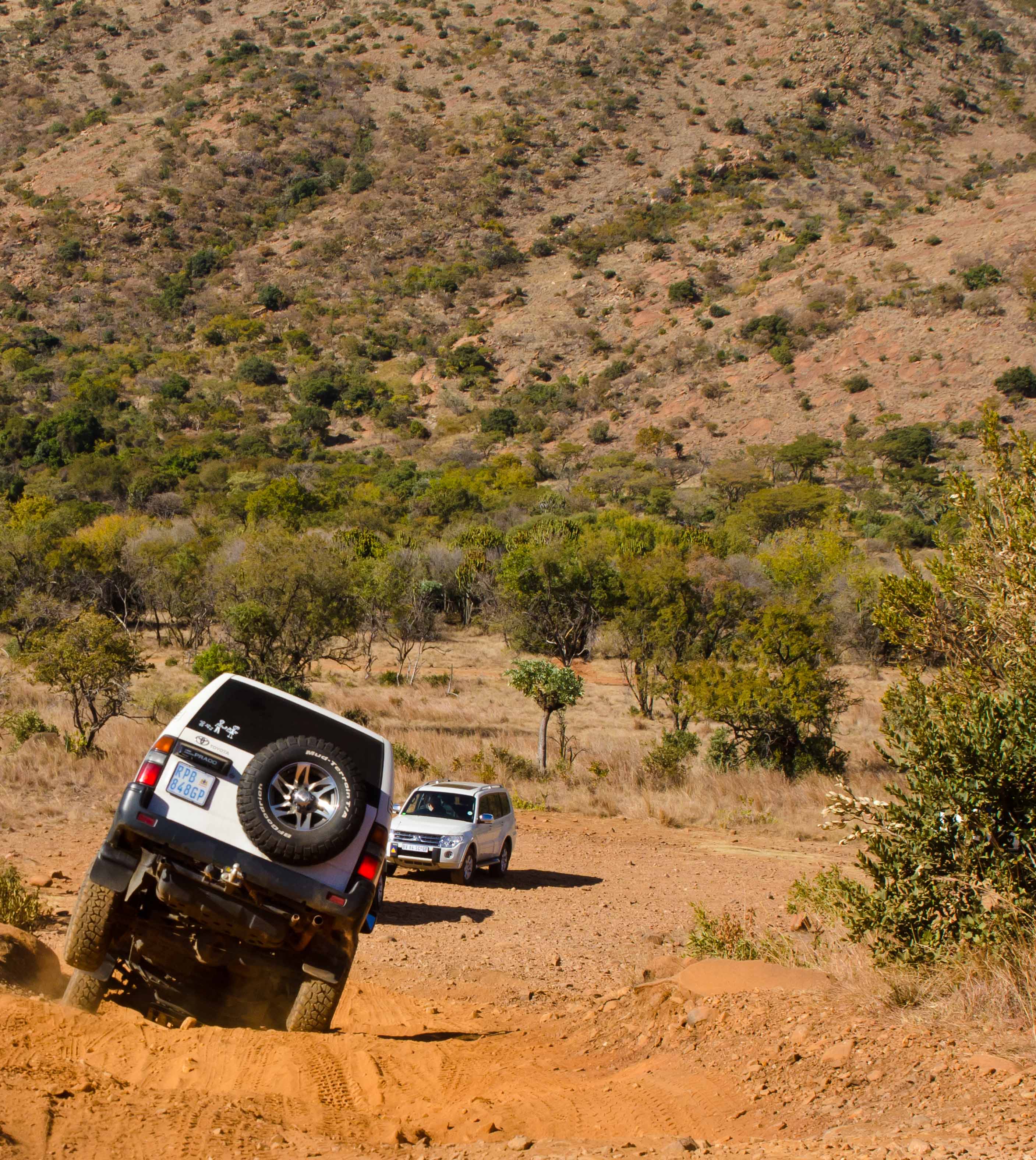

- Posts: 3462
Re: SWB vs LWB
Credit to ou BOEZMA as well - he also reversed up the trappies at De Wildt -- and the down NEVR got that angle as on the pict
BUT with the Terrano [even teh 5-door LWB] with it's much more restricted articulation .. eisjj, daai ding het my paar keer laat sweet ..
