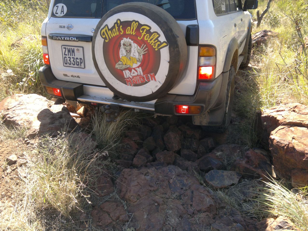

Also... my troll... like rest of same model.. has crappy rear lights and stop lights in bumper while the main cluster is globeless and thus useless... any views on how to rig these to work.

Those body tail lights..... I did mine before my boss drove into the back of me one night. Got a new set from UAE, via Wilfred, for easily half the price and theses included the globes and indicator lights.... basically a plug and play.
But going back to your original set, you get the globe holders from Midas.... gently cut a hole in the light backing and spot silicone it in place. Then the crappy part is where I went wrong.... I cut the existing plug from the wiring harness off.... don't do that.... strip insulation and connect each relevant wire to the correct globe. ( should you manage to get tail lights like mine... you will thank me when all you have to do is just plug it in )
But getting back to the the existing tail lights. On the one side there is a reverse light and on the other there is a red lens. I made that a fog light. I ran a new live wire from the little yellow fog lights I fitted a few years back. This was handy cause of the crappy bottom bumper lights. Then I made the normal tail lights the bottom red lens as well as a stop/brake light. The top I made a brake light only. Some guys here have made the top red lens an indicator.... so the choice is yours... the wiring harness is right there ( except for the fog light )

personally I think this is by far the best option...... you will have legal indicators and the back end of the patrol will be seen !!!
