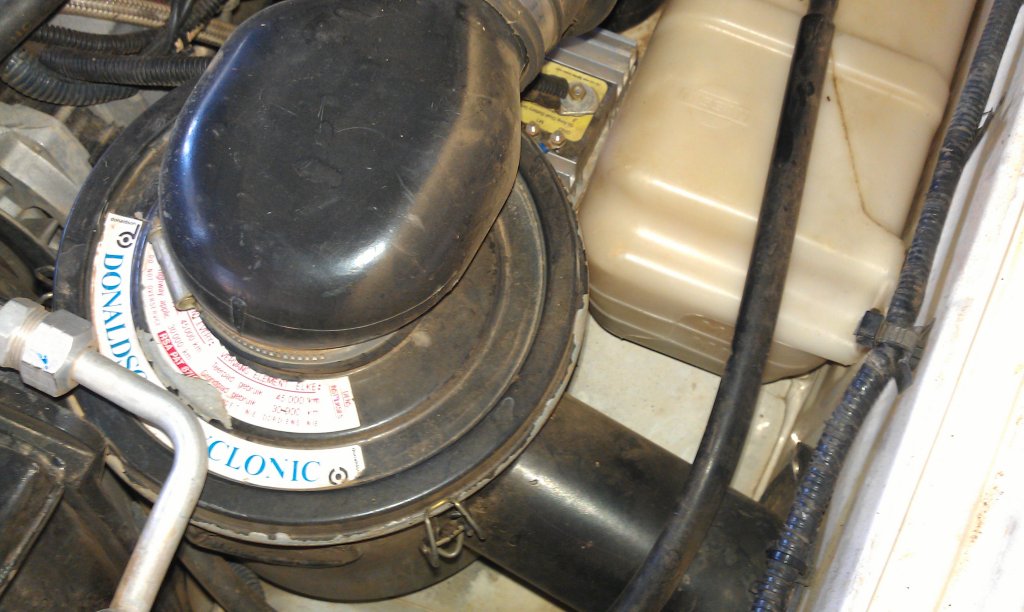

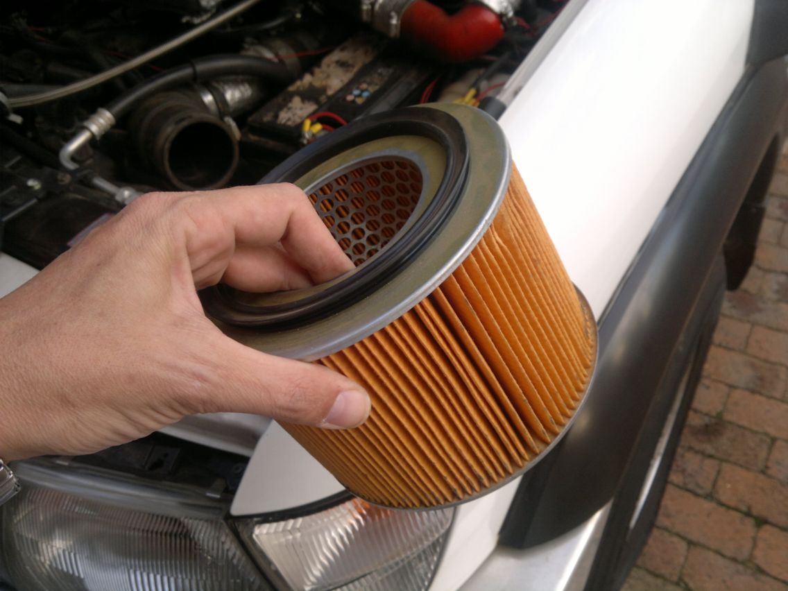

I am battling my donkey off to get an air filter for the Maiden. The GUD catalog shows it as a GUD 1001, but that is a pan type filter if I'm not mistaken. Mine looks like this
I could have sworn I got one from my spares shop, but they cant recall it either....... the filter housing is a genuine Nissan part and has a V100 stamp on it ( part number??)

That is not factory setup from a TD42 motor.
That is the unit the chaps use when they need to relocate the housing when turbo set-up is installed.
Based on the fact that the housing says Nissan - Perhaps its from a nissan small bakkie/car ?
I would email / call Donaldson Filters - give them the dimension etc, they should be able to help you out.

Cedric what i have done on a lot of generators ect is to take the sample to them and tell them that i need one off those !!!
i got the honda v twin filter from diesel electric in wineburg to match it for me it fits on some korean cars but not in their books
once u have the fram or gud no you will be ok!!

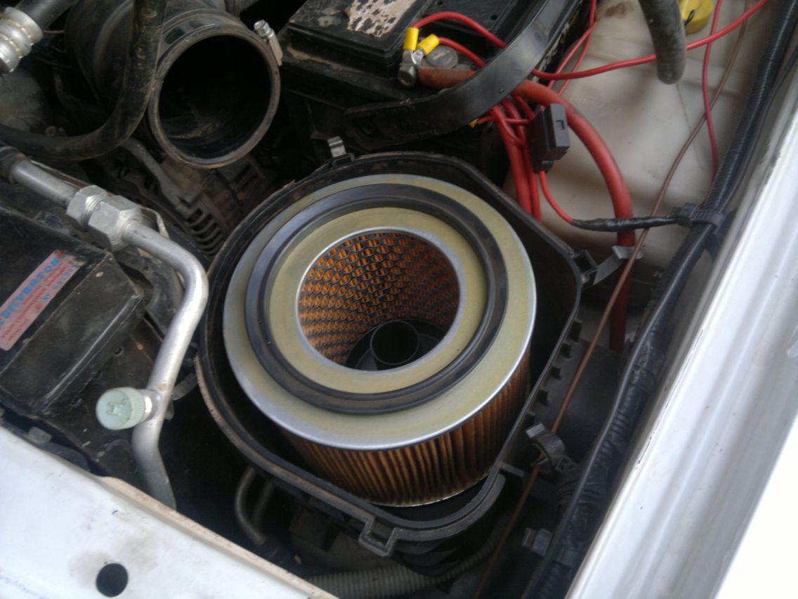

Cedric that looks like the 3.0 housing , looks just like the one on bear , if needed i can check tonight when im home if i have a filter number on mine
I know that its a common practice is Aus to retrofit the 3.0 filter onto the 4.2 for more space

Yip, exactly. My bet is ZD30 from the hardbody.

Russ the zd30 in te 3.0 Patrol comes with that filter form the factory

Russ / Cedric here is the standard 3.0 Diesel GRX Troll filter housing and part number
- The housing
- 20120416_172242.jpg (2.5 MiB) Viewed 2266 times

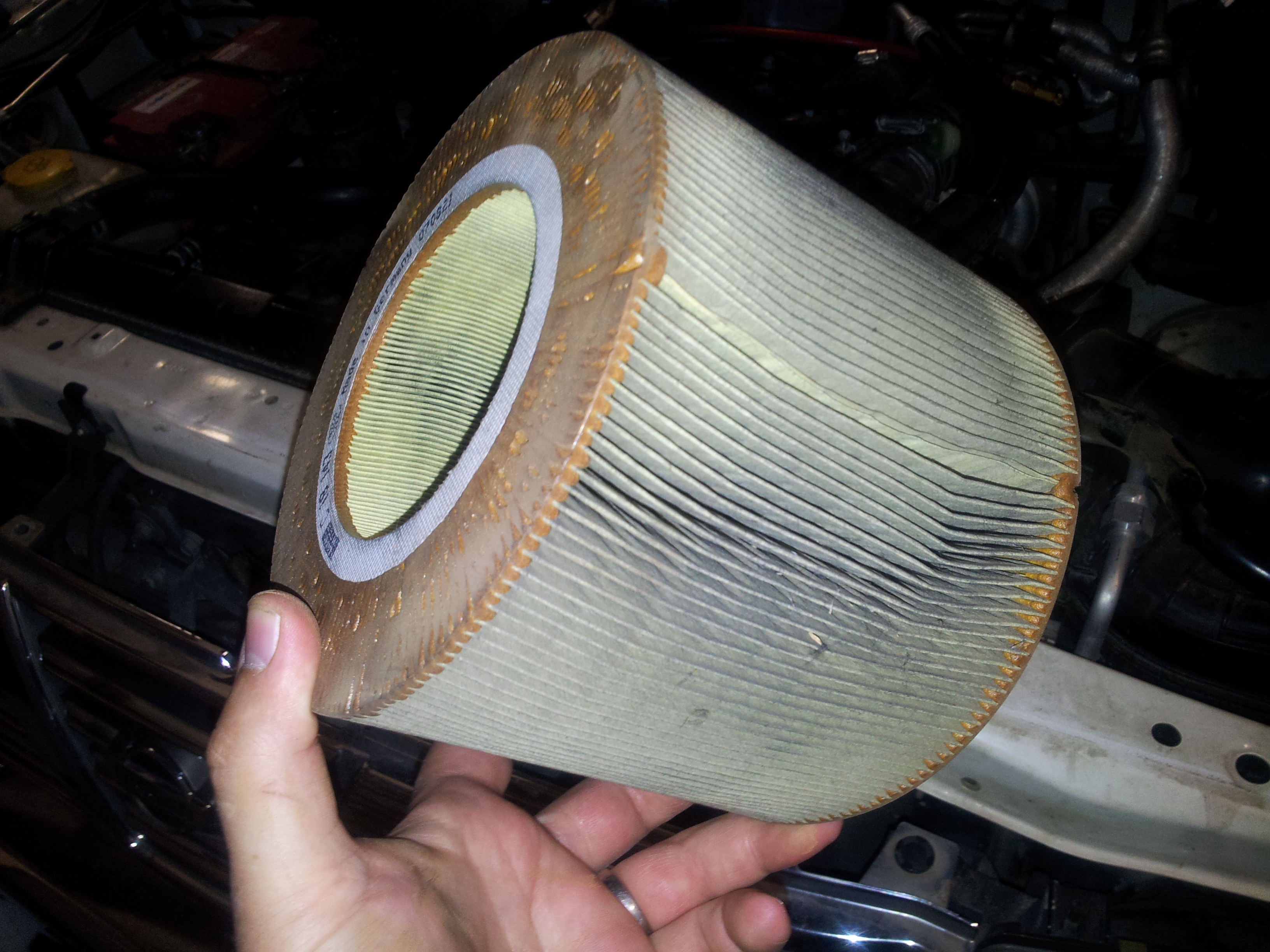

- The filter
- 20120416_172308.jpg (2.82 MiB) Viewed 2266 times

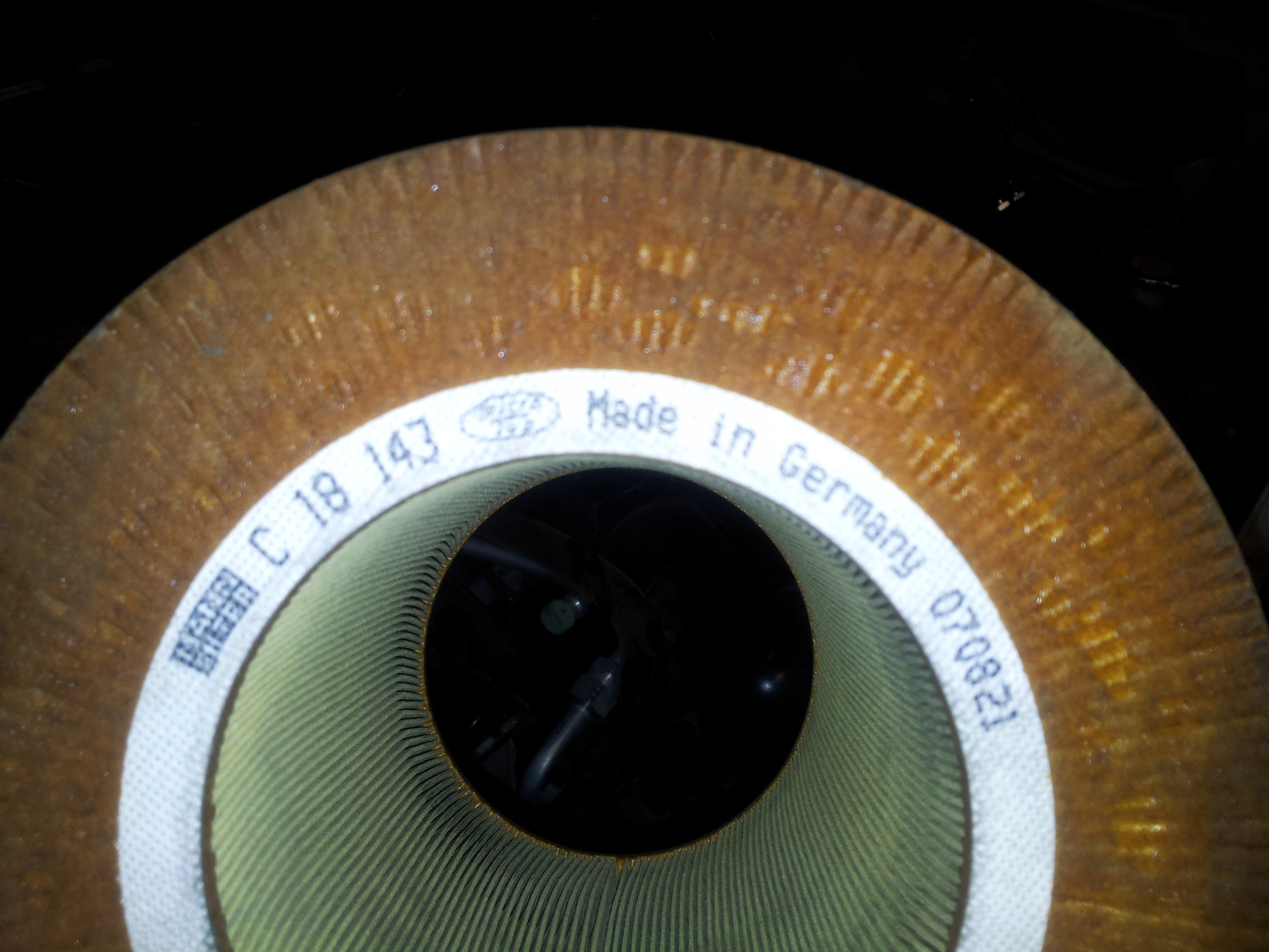

- The part number
- 20120416_172319.jpg (2.18 MiB) Viewed 2266 times

- Been thanked: 473 times
Re: TD 42 Airfilter..... Part number
That's pre-zacktly the filter....
What brand is that..... It doesn't look like a GUD or Fram stamp

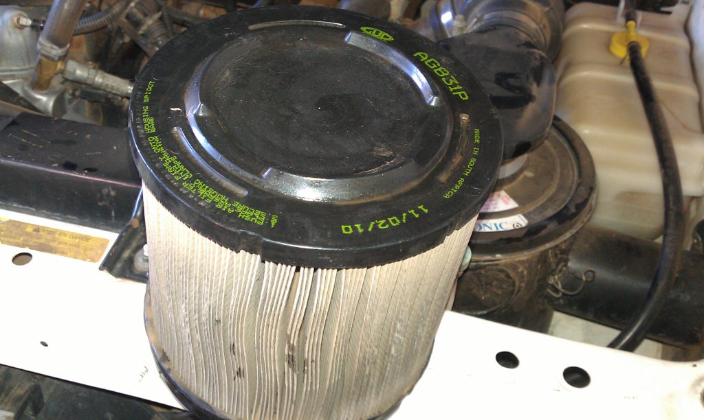

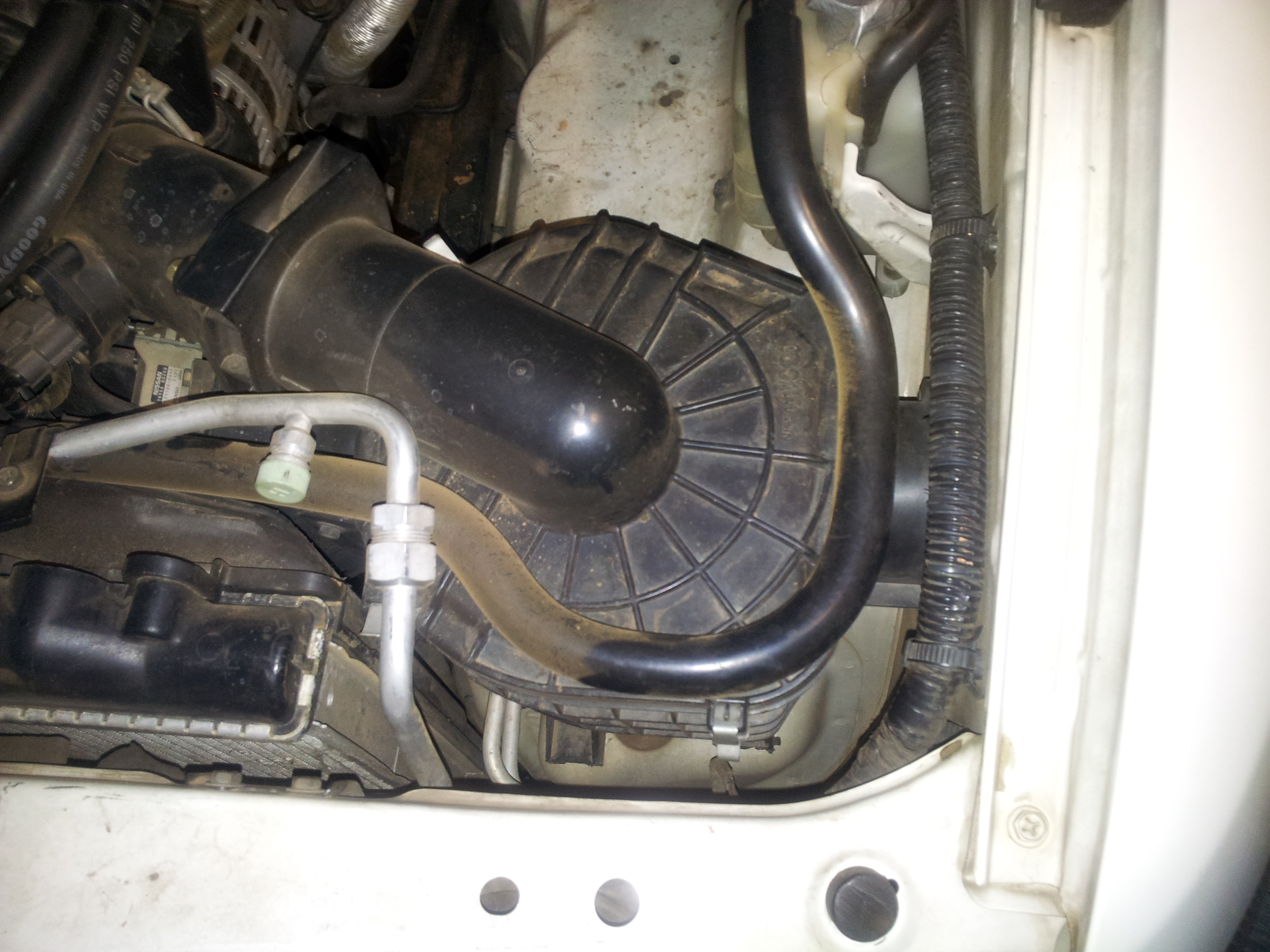

Another Patrol, another air filter housing:
But my filter has a GUD part number:
YMMV...
YMMV...
