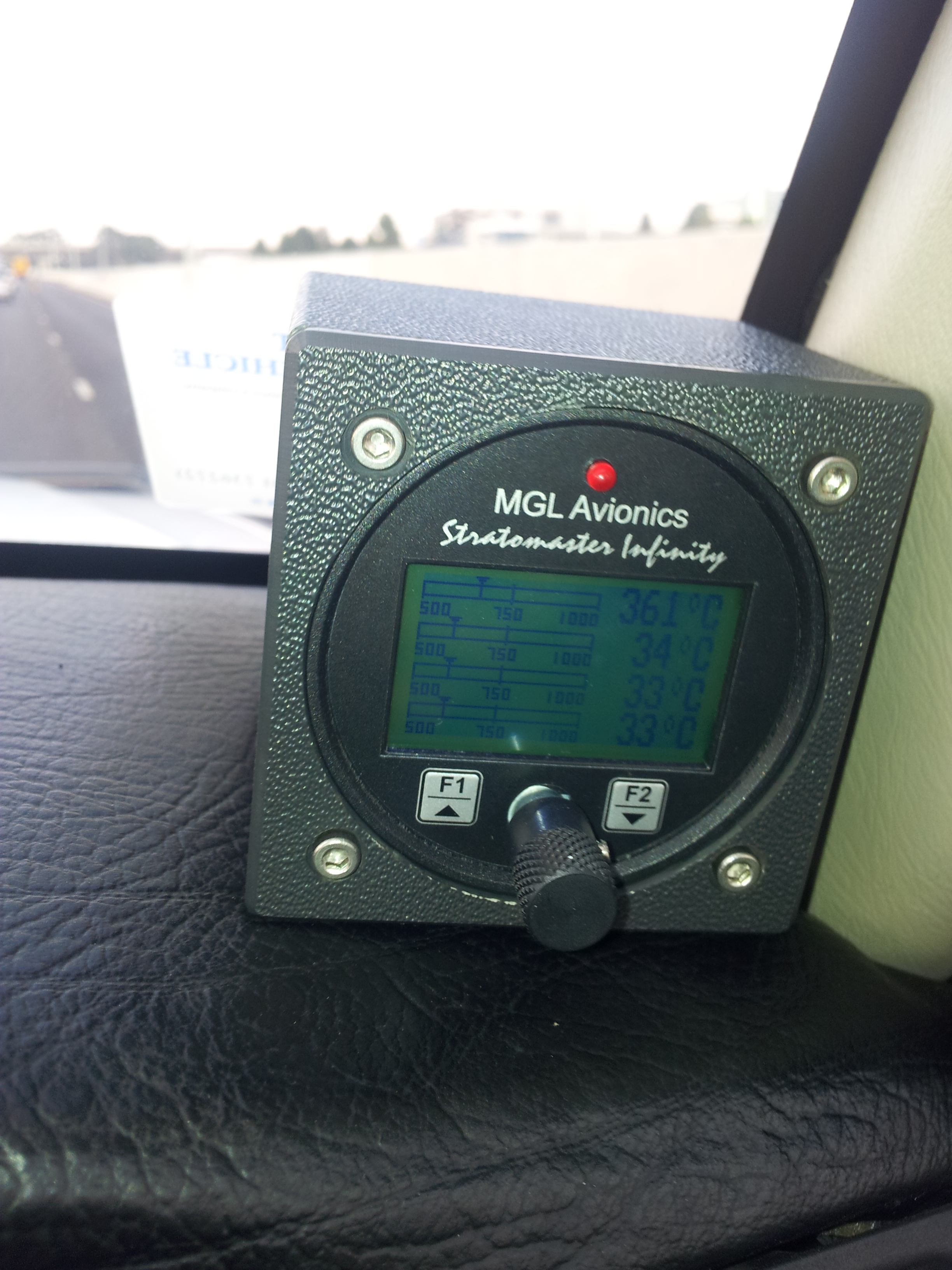

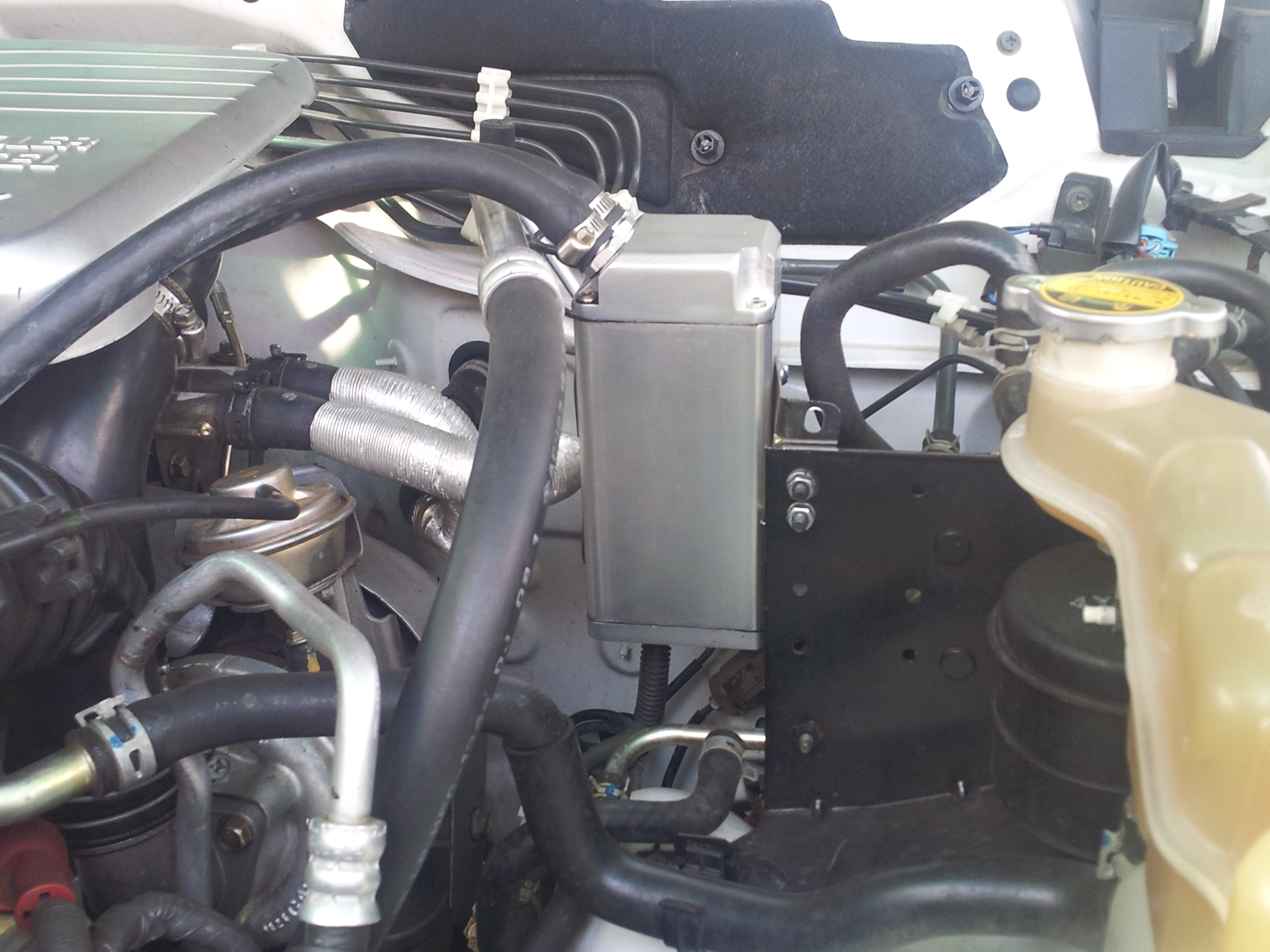

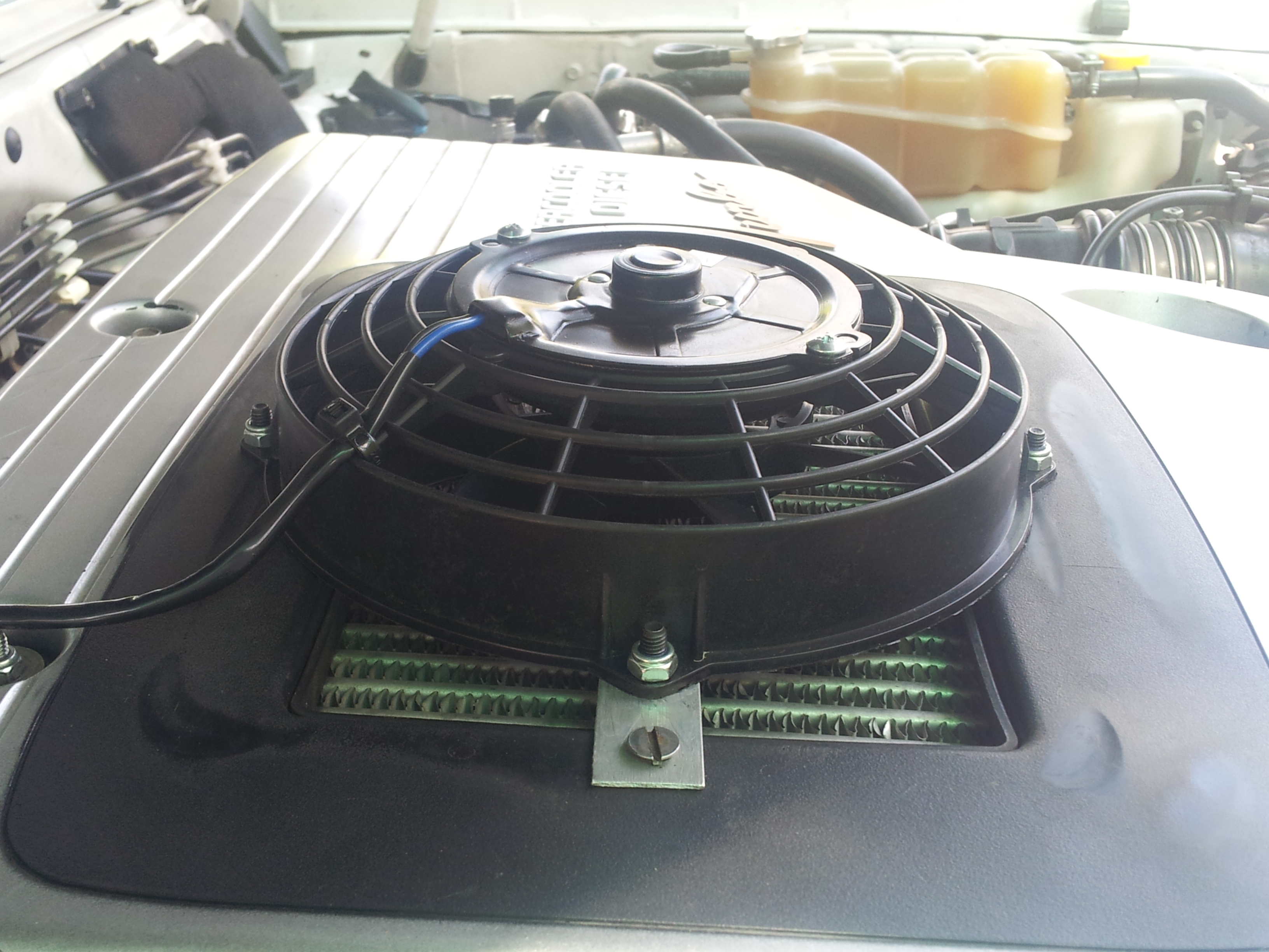

EGT , oil catch can and intercooler fan install pics
EGT Gauge install - R3500.00
Catch Can install - R180.00
Intercooler Fan - R200.00
EGR blocking and UNICHIP still to come - R?
Preventing a blown engine - Priceless...

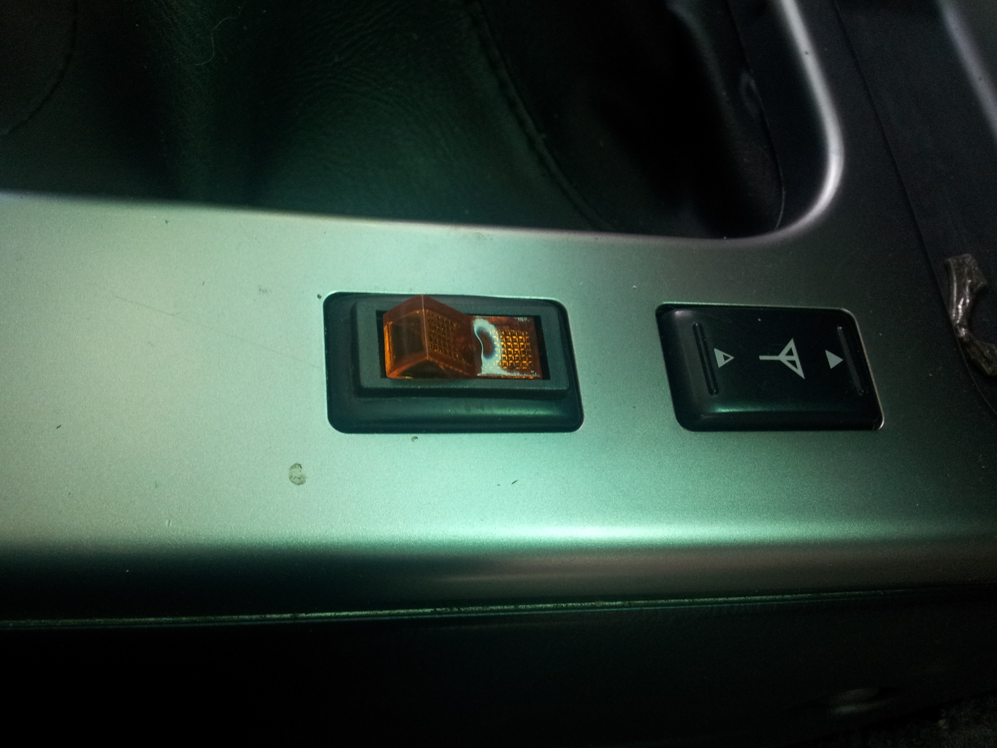

Baie mooi
Waarvoor is die switch in die console, sit jy die intercooler fan aan?

Hi.
The switch is there to switch the fan on and off which is not needed I just like to have control.
I just did a trip to Cape Town towing an off-road trailer. My max EGT temps went to 600 C when climbing and average of 450 to 500 on the flats at 120KM/H. As soon as I went above 120 the temps climbed. I would recommend anyone towing not to go above 120 and stick to around 110, this way the temps stay nice and low.

Re: EGT , oil catch can and intercooler fan install pics
I like that fan! What model is it?
