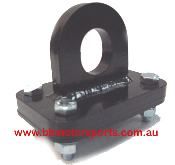

Something like this X 2
- wsOBBHP.jpg (213.8 KiB) Viewed 2859 times

I might weld on as well. I dont want them stollen now. I stay in the Cape you know
OFFROAD ADDICT
Re: PIN TAIL TOW BALL
I prefer them bolted!
