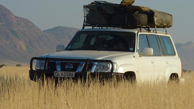

2010-06-28 Camp Syncro - Puros.JPG (59.38 KiB) Viewed 8409 times
With everything on top including 4 Jerrycans and not towing anything I got the following consumption while doing 120 on the main roads...
km/l l/100km
4.50 22.25 Stellenbosch - Van Rynsdorp
4.27 23.44 Van Rynsdorp - Noordoewer
4.60 21.75 Noordoewer - Mariental
4.86 20.58 Mariental - Aranos - Gobabis
4.80 20.82 Gobabis - Waterberge - Otjivarongo
5.01 19.96 Otjivarongo - Kamanjab
5.31 18.83 Kamanjab - Opuwo
3.63 27.57 Opuwo - Okongwati - Van Zyl's Pas - Puros - Sesfontein
4.25 23.51 Sesfontein - Warmqelle - Swakopmund
4.68 21.35 Swakopmund
4.42 22.60 Swakopmund - Sossosvlei
4.65 21.52 Sossosvlei - Aus - Rosh Pinah
4.02 24.86 Rosh-Pinah - Sendelingsdrif - Alexanderbaai - Springbok
4.36 22.96 Springbok - Stellenbosch
