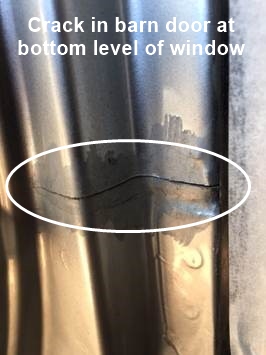

When I bought my Patrol, it had a significant crack on the outer skin of the right barn-door side,
more or less in line with the bottom of the window.

In my opinion the root cause of the barndoor cracking is the design of the door itself.
The crack on all the Patrols with this problem appears to be always exactly in the same position.
The doorframe has been reinforced with an additional panel on the inside.
The crack runs within 1mm above this reinforcement plate.
(See Image 1)
When closing the door one needs to apply a certain force in order to ensure that all 2 door locks (bottom and top) engage properly, otherwise the “door open” signal on the dashboard stays lighted. However, forcefully closing the door puts a bending stress on it. The stress is highest in the middle of the door - at the bottom of the window. It has the same effect as bending a thin piece of metal up and down over a table edge until it breaks off.
In this case, it is the reinforcement inside the doorframe representing the tables edge.
I am quite certain that this problem would not occur If this reinforcement piece were to be significantly longer at the top. The forces created when closing the barndoor will obviously be even higher when the hinges are worn causing, a sagging of the barndoor.

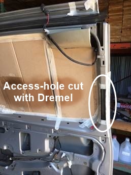

1) I stripped inside door panel, wiper blade motor assembly, door lock top, connecting rods + cables.
2) I cut a strip ~ 150 x 20 mm on the inside of the doorframe as access-hole with a Dremel tool at the height of the cracked outer skin.
(See Image 2)

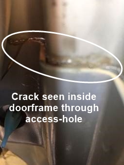

(See image 3).

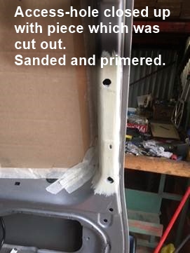

This picture was taken through the access-hole and shows the crack of the outer skin from inside the doorframe, exactly were the reinforcement piece ends.

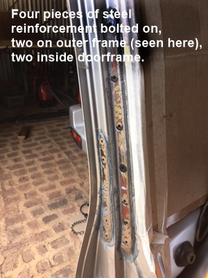

3) I decided to do a sandwich reinforcement which wedges the cracked panel between two outer metal strips and two inner strips.
The outer strips are ~ 6 x 400 mm for the bigger one and about 3 x 200 mm for the smaller one. Holes for bolting were pre-drilled, and the holes in the inner strips threaded.
Outer and inner strips were coated with a layer of metal epoxy, then screwed together with bolts.
Nuts can’t be used with the bolts since it is too difficult to attach them in the time available (speed was needed due setting time of the epoxy). The use of nuts would also limit the space inside the doorframe to the extent that movement of the connecting rod (door locks) could be impaired.
The epoxy layer between the reinforcement strips and the body skin fulfills two functions:
a) It ensures that the reinforcement metal strip bonds 100% with the vehicle skin and not just at certain points as with a screw connection or welding points.
b) It gives additional strength.
(See Image 4)

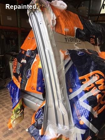

After the reinforcement process as described above was complete, the remaining task was to smooth out the reinforced area, then apply primer and paint.
(See Image 5,6 and 7)
