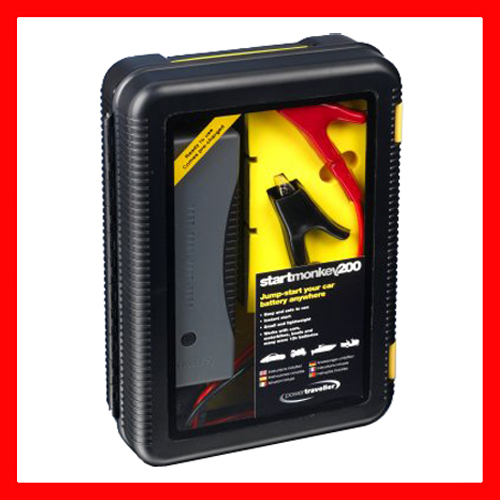

I read an old post (I think Jan Dup..) something about the start-monkey200 for assisting start with flat battery. I am quite interested in such an accessory, so has anyone tried this and can report on the effectiveness. Is the 200 strong enough for the typical patrol battery, or should one get a '400??
Start Monkey 200 Jump Start Kit for 12-Volt Auto Battery
Description:
The startmonkey200 is the world's smallest "jump start" system for car batteries. The startmonkey200 can restart a standard 12-Volt car battery between 15 and 20 times on a full charge thanks to its High Energy Dynamic Polymer Battery. And it is packed with high-tech features to give you total peace of mind.
The startmonkey200 has 2 output channels:
a 12Volt, 120Amp jump start output for your car battery
a 12Volt, 100 watt max, 8Amp DC output for charging your portable gadgets
NOTE: You must ensure that your car battery is 12 Volts (if 5 or 24 Volts - DO NOT USE with startmonkey200).

- !C!W,6gw!2k~$(KGrHqIOKnMEz4Ohhmi5BNCl6itdO!~~0_12.jpg (114.68 KiB) Viewed 5167 times

I have always juged a battery on its size a 95 A that starts a 4.8 about 10 times has a weight of ± 25 kg so a little 5 kg job I don't know???
I have had a flat battery a couple of times and when you couple a full 110 A battery for 5min you some times get it to start . I would rather spend thenm oney. On a set of 25mm jumper cables and proper clamps bring it to me and I will crimp them for you so that you can jump start from your second battery even if its in the back of the car

This seems to be an awesome little machine and will be very handy, even taking it out on the boat for extra peice of mind. Can just park it under your car seat and leave it there.
It just supplements your main battery and lifts it to a level where it can start the car - eg it probably will not start the car on its own.
If it works as advertised, I think will be well worth it. Can probably get from overseas for about R1600. If anyone interested let me know and I wil get a few on my next trip.

Looks like a great idea. However with the diesel's I don't think it would work. If my Trolls battery is to low to start the only way I can get it going is by pulling using another vehicle. Second or third and off you go.. On three occasions I tried to jump start. No way on earth.

agian lets have a look and see but i dont think so mabe for a gets or uno or as chris says outbord motor . starting a big engine is all about a/h and a/h get stored in big batteries

Grant - that note of Tinus' - The jumpers must be up to it - is very true.
in 2009 we were in Richtersveldt na we cam upon a local who's Toy was in a ditch - BUT the battery was dead..
So Ben-Hur tried wih his jumpers, no go. Then Cobus tried with his jumpers - again, no go.. The I got my jumpers out [DIK drade met STEWIGE clamps]
First crank, that Toy started..
So - yes, the jumpers does make a diff. Big time.
Re: Sart Monkey200/400
also next time you try and jumpstart a car put the jumpers on have a coke or a beer a camel or two and then crank the engine .........when you do it like that you putting some volts back in your battery and it saves starters ect we once started a 8 ton truck that was stuck in the mud by letting the alternator of the assisting car just do its work .the problem again is the amps that the starters pull and when it needs it and its not there the voltage falls and everything goes wrong .........so next time try it is works believe me !!!!!15min makes all the diffrence

I have welding cable set up as my jumper cables. I hear you but nobody will convince me. I have had four experiances and no chance. Rather pull out the tow rope and there you go.

Like I have said I have welding cable set up as my jumper cables after I learn,t my leason in the late 90's when we went to the Moremi and did not feel the need for a daul battery system. When we tried to start the Troll using jumper cables we literally melted the terminal fo the batterys.
Valuable leason learnt - I now only use Deltec Batterys.
