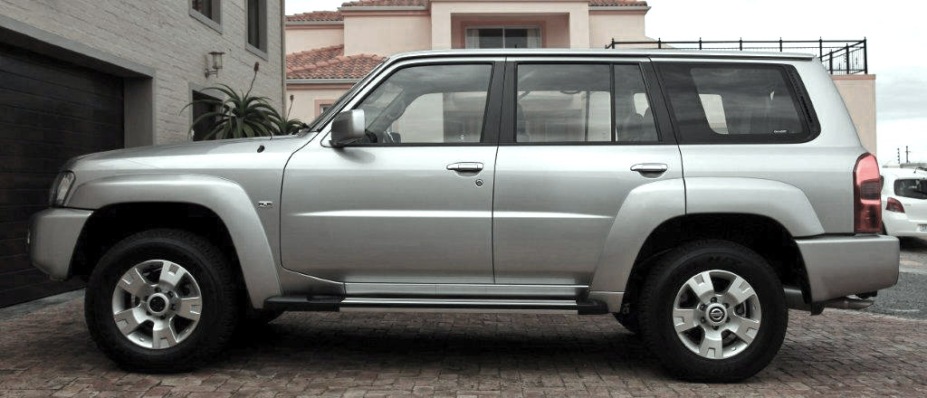

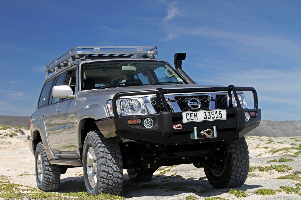

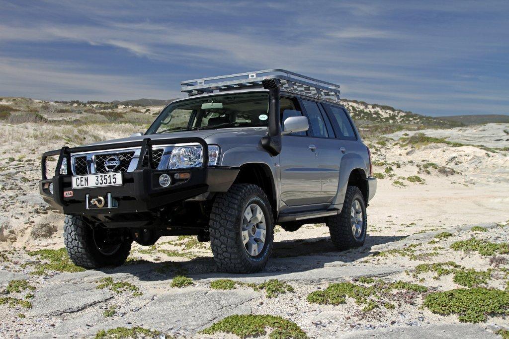

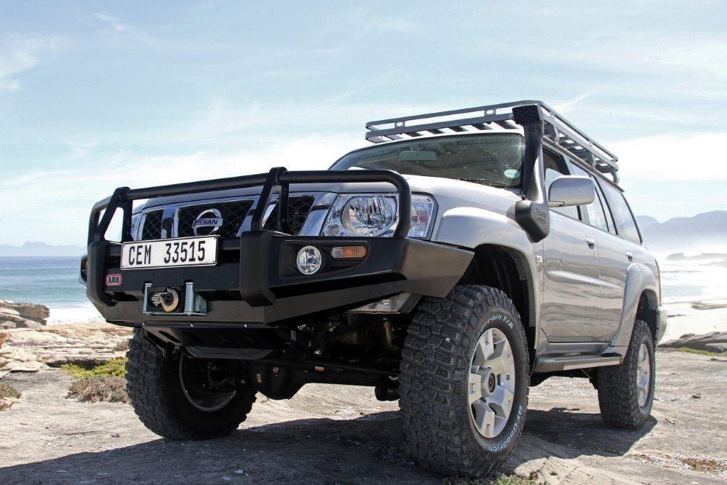

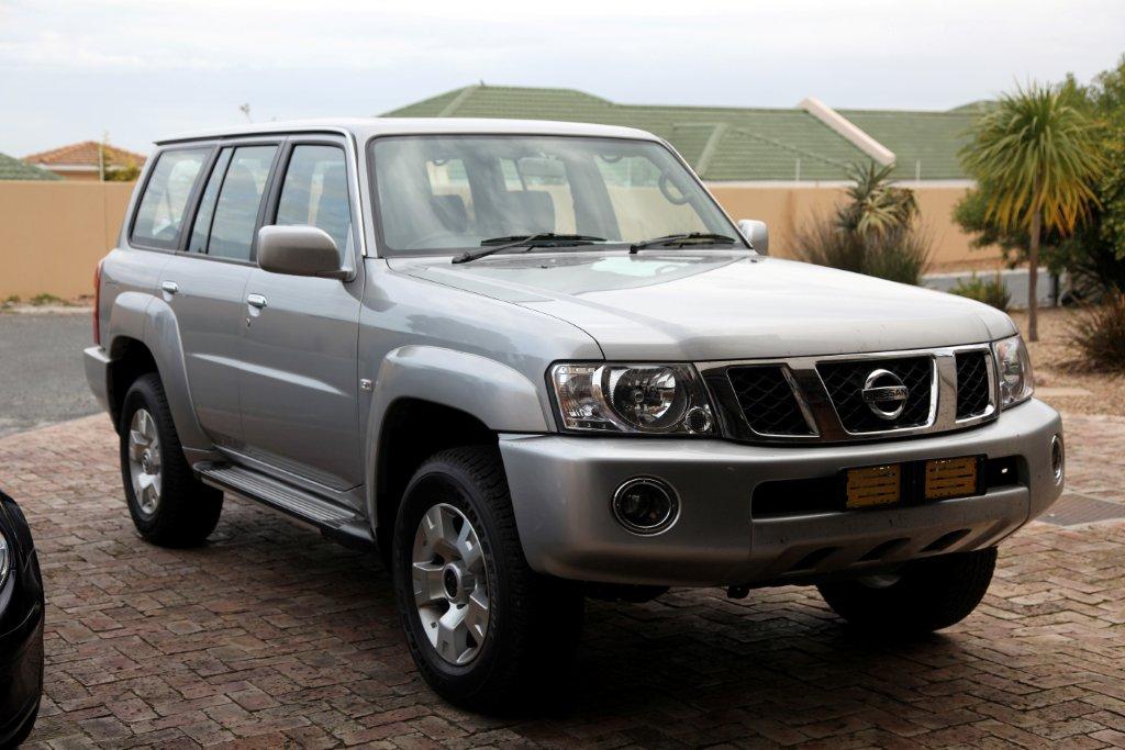

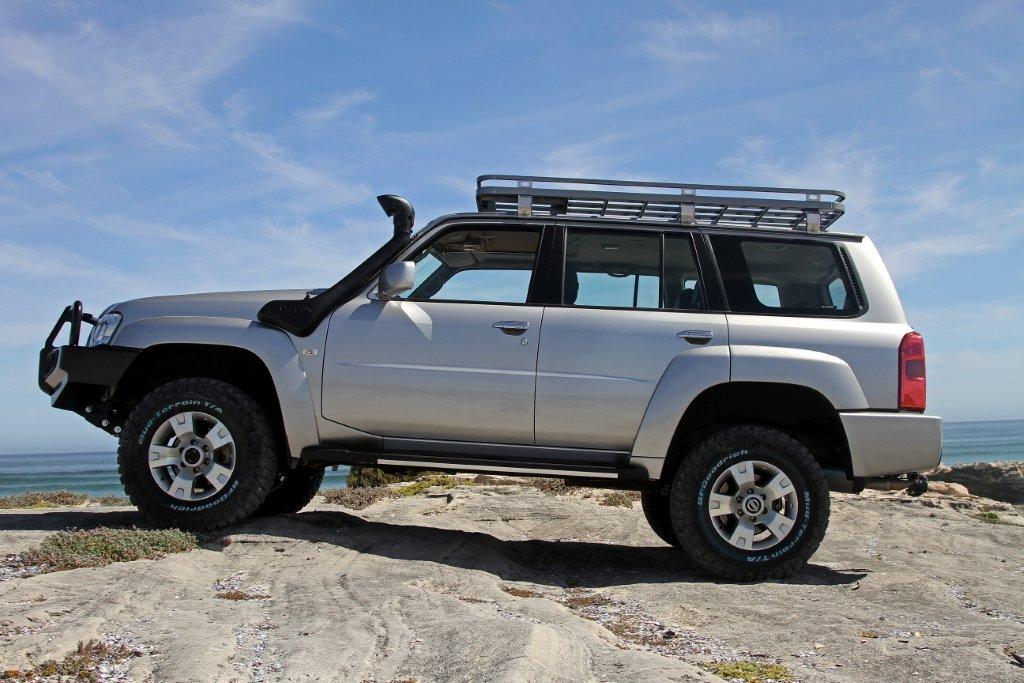

Hiers 'n paar voor en na fories van "KATVIS !!"
Voor
Standard 4.jpg (113.6 KiB) Viewed 2709 times
Na
Patrol 1.jpg (116.72 KiB) Viewed 2711 times
Voor
Standard 1.jpg (100.13 KiB) Viewed 2711 times

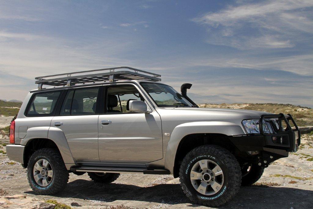

Na
Patrol 3.jpg (107.24 KiB) Viewed 2711 times

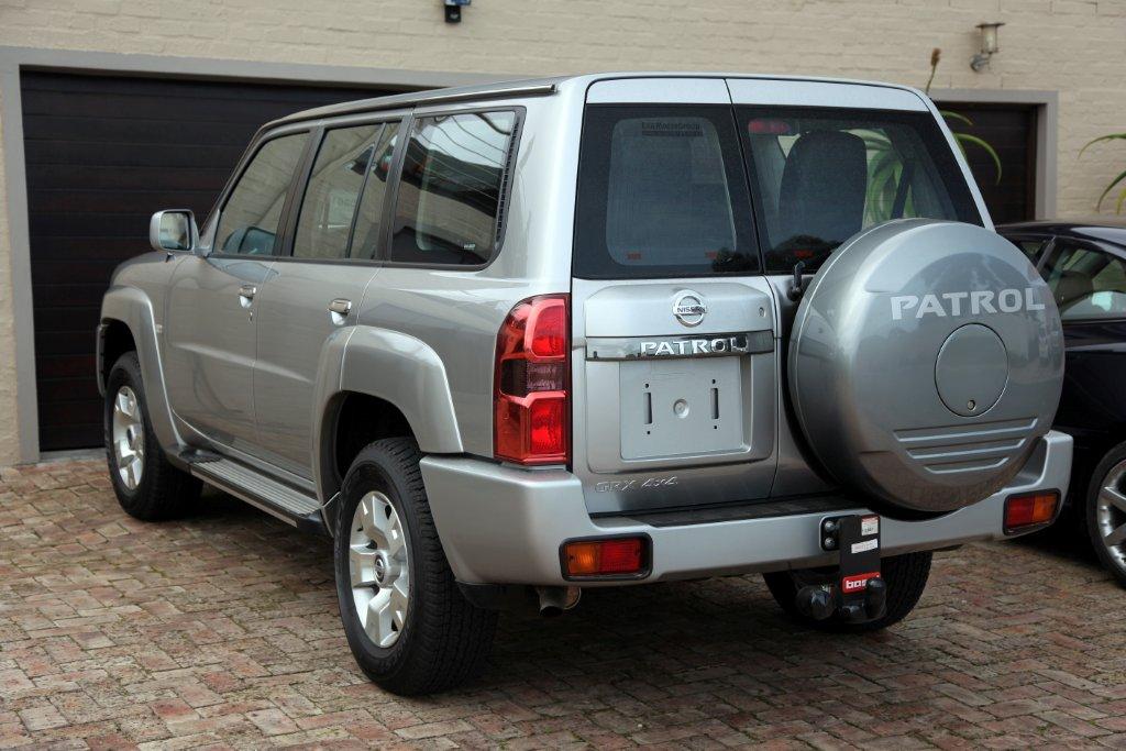

Voor
Standard 2.jpg (108.23 KiB) Viewed 2711 times
Na
Patrol 6.jpg (57.1 KiB) Viewed 2711 times
Posts: 6137
Has thanked: 1125 times
Been thanked: 1036 times
Re: Het jou Katvis !!

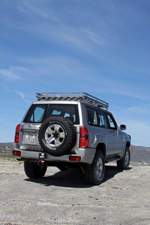

Mooi so Jan. Hy lyk sommer klaar baie beter.
However I would like to make one or two suggestions (not critisizing, just trying to help you get the most out of your beautifull new toys):
1) move the roof rack backwards 100 or 150mm, so that the mouting feet are right above the roof pillars. There are two reasons for this: 1) It is a lot stronger that way, and 2) the rear edge of the roof rack should be approximately above the rear door, which prevents you damaging the roof if you slip while loading heavy stuff on the roof rack.
2) Get a spare wheel cover, as the tire will last much longer if protected from direct UV radiation. Those with the pocket in them are great as it is an ideal place to keep your rubbish.
Enjoy it, she's a beaut. :salute:

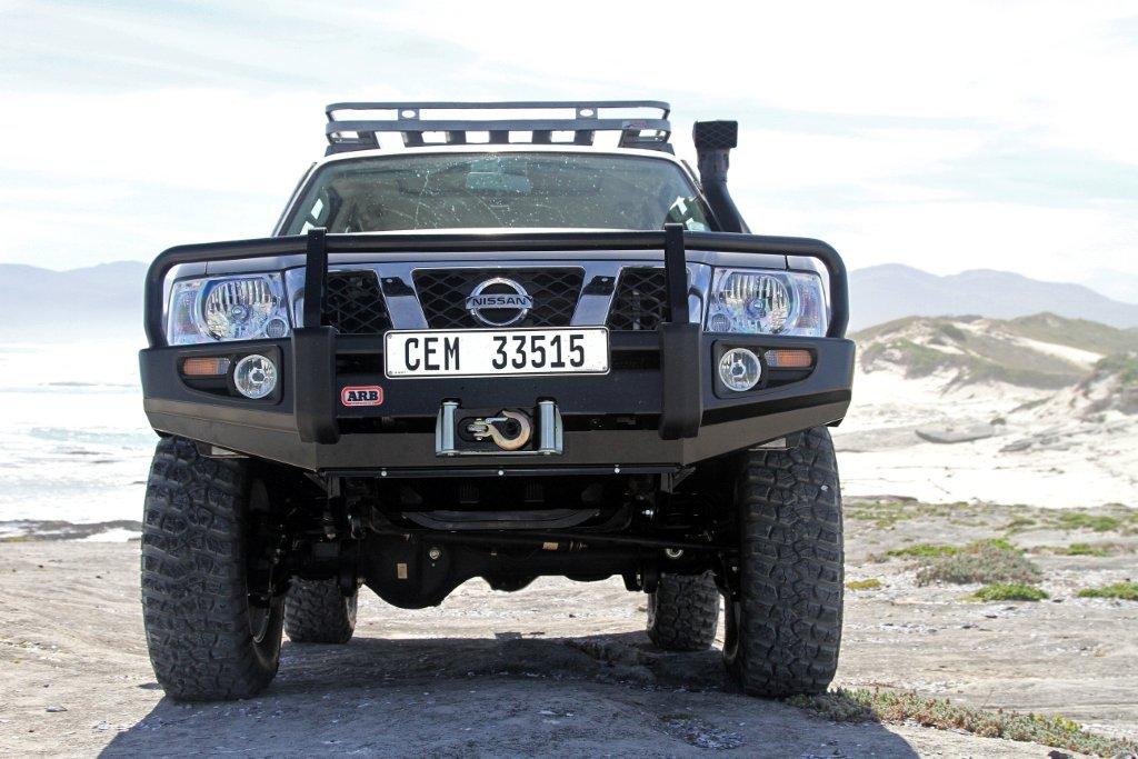

Nogge paar,
Patrol 11.jpg (108.65 KiB) Viewed 2709 times
Patrol 10.jpg (108.87 KiB) Viewed 2709 times
Patrol 8.jpg (102.06 KiB) Viewed 2709 times
Patrol 5.jpg (157.87 KiB) Viewed 2709 times
Gaan volgweek die 2de battery insit (in enjinkompartement - als reed geskuif) asook bashplate en laairakke/fridge slide - sal post as die ok klaar is.

Thanks Piet,
Definitely makes sense regarding the roofrack and wheel cover. I'm thinking of designing a logo for "Katvis !!" to go on the cover :think:
