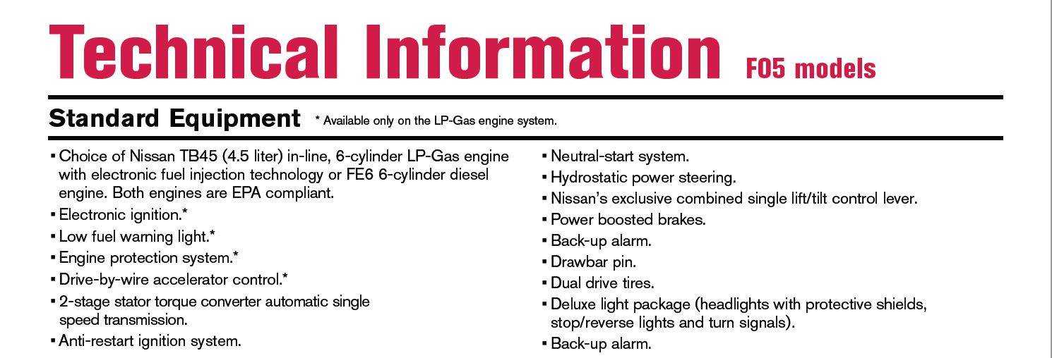

Although the TB45E is comprehensively eclipsed by the TB48DE in terms of performance, the TB45E is much cheaper to fix if things go badly pear shaped, by virtue of it being a much simpler motor.
Yip, the old TB45 soldiers on
. Someone has to build engines for forklifts
