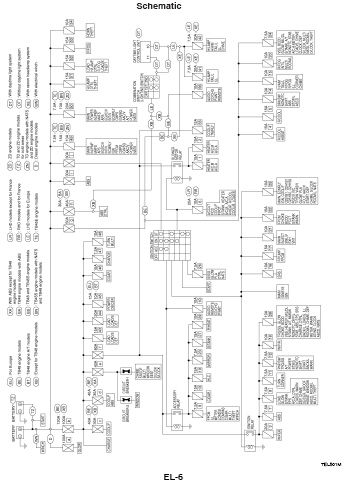

Gaan hierdie help?
- Schematic 4.8.jpg (65.83 KiB) Viewed 4028 times

Wynvat, according to the manual the rear power socket has a separate fuse to the front (fuse number 46, 15A). The rear power socket is also switched on and off with the ignition switch via a relay, which has its own fuse (fuse number 9, 7.5A).
The manual shows that fuse number 19 is the front power socket fuse, buy the way. The wiring diagram shows that the only thing supplied via that fuse is the front power socket.
