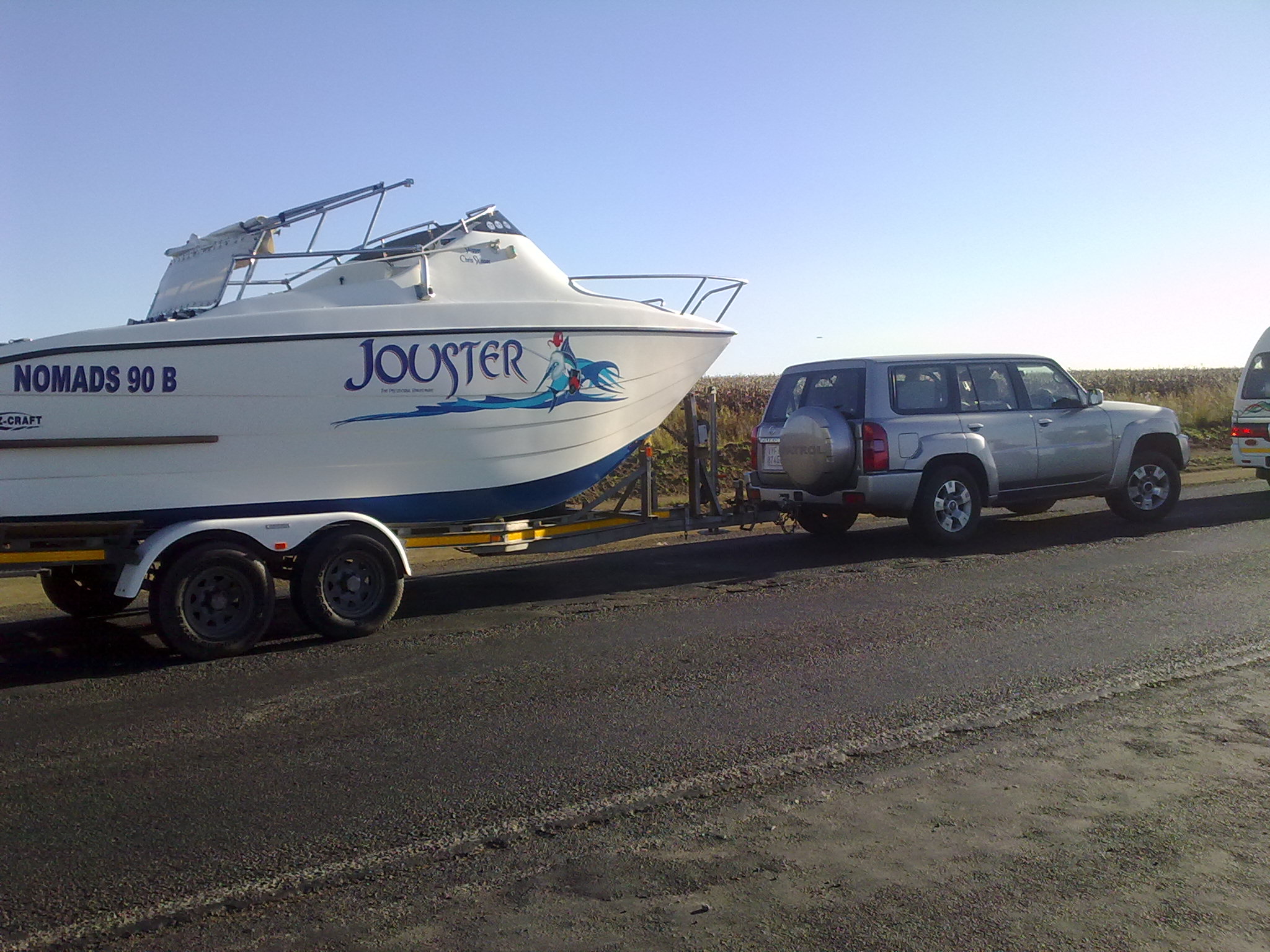

Hi
I had same concerns when I was considering moving to the tiptronic feature vs my old 4.5 manual.
Since changing over I have had the opportunity to tow my boat from the coast back to Pretoria for annual maintenance.
The Tiptronic performed admirably - I find towing a lot less tiring as no need to concentrate on gear changes to the same extent as before. I just leave it in 4th gear in the tiptronic mode (so does not use 5th for obvious reasons), and away you go. You can also then change down manually as required up hills etc with the flick of the wrist.
As you can see below, I have quite a heavy trailer...
As said on previous posts, I will not consider going back (unless of course if reliability became an issue).
Very interestingly - I had at least 15% improvement on my consumption vs the 4.5 manual when towing.
- 27042011144.jpg (563.94 KiB) Viewed 2012 times
