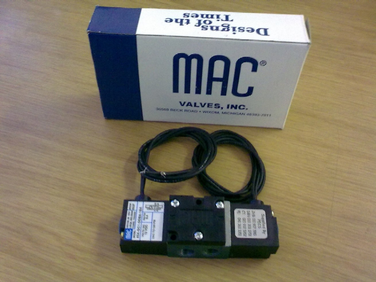

Hi.. We have had a couple of calls from some of the Patrol4x4 forum members that managed to find our details, these calls was in regard to the vacuum solenoid on the diff-lock (replacing the rather expensive OEM one), we offer a solution to the factory fitted unit at a much better price!

Gerrit Loubser wrote:The Aussies seem to replace the original Hitachi solenoid valves with a valve from MAC Valves. Have a look at these links:
http://forums.overlander.com.au/viewtop ... 3fe6bb388e
http://www.patrol4x4.com/forum/showthread.php?t=21781&
The part number that they quote for the MAC valve is: 45A-GC1-DDBA-1BA-M532F
The local agents for MAC are Pneumatic Electric Control Systems (http://www.pecspower.co.za/)
Now, we are the MAC agents in Southern Africa and stock these valves specifically for the PATROL, The correct part number of this vacuum solenoid valve is: 45A-GC1-DDBA-1BA-Mod-532F and the price at the moment (August 2011) is R617-00 excl. VAT. As a special offer to all forum members we will offer a 5% discount on this price.
For any details please contact Riaan - 0822695830 or Michael - 0119071910

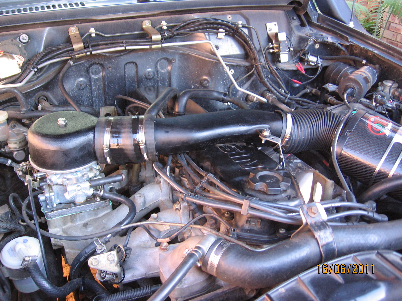

This solenoid works perfect for our Patrols, I have installed one which I bought from Riaan. Check out the picture I put it in the same place as the original one, just had to make up a bracket. If your problem is not electrical you should be fine installing one of these solenoids.
Cheers
Rudolph
