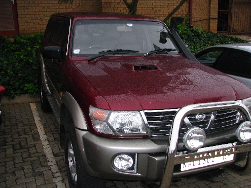

FOR SALE: 2002 Patrol 3.0 Di GRX - Automatic. Km: 232 000 - OME Suspension, New B/stone Dueller A/T Tyres; Red & gold; Leather seats; engine overhauled 3 000 km ago by Steves Auto Clinic - dieselpump being replaced due to ENGEN garage putting water contaminated diesel in the tank - Radio & 6-shuttle CD - Red & gold.
EGT [Madman] fitted; and you can speak to his mechanic at SAC -
Reason for selling? Too many 4x4 in my yard - dont have place for all and cant afford all 4. If you ask nicely,the ORYX Caravan can be sold with the Patrol [then the Oryx price will come down]

Advantage with Agarob - The engine is still under guarantee; the service book is complete up to date [missed one service in all its life] - so you are safe from "handgranade" experience for many many years & miles to come ...
noudat ek soi daaraan dink ... hy si nie meer te koop nie..
