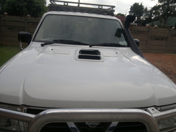

Since my 4.2 conversion and everything else that came thereafter (the running hot problem) I have been talking about this......and eventually got around to get it done. Thus...as for now.... I am done with doing modifications to my Patrol - and he is running as smoothly as can be.

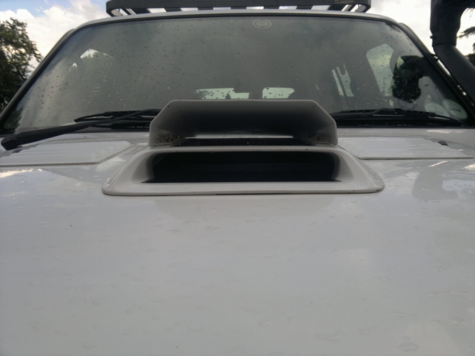

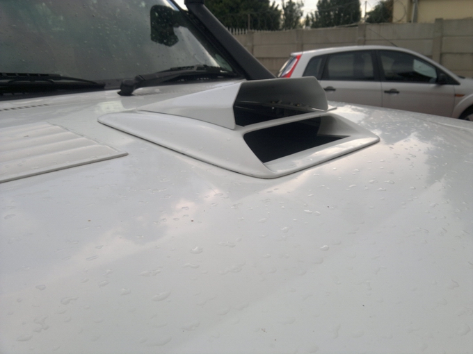

I had the additional vents done and even though a little bit smaller than what I thought I am still 100% satisfied that it looks well and WORKS WELL!!! If you look at the Patrol it actually looks like it could have come like that - straight from his mamma. :thumbup: Thank you Dino at Burnco for a job well done!!! :clap:
Right side Air Duct
Same from the front...
Left side Air Duct
And the complete bonnet.....

I assume the purpose is to create a suction to get hot air out of the engine compartment?

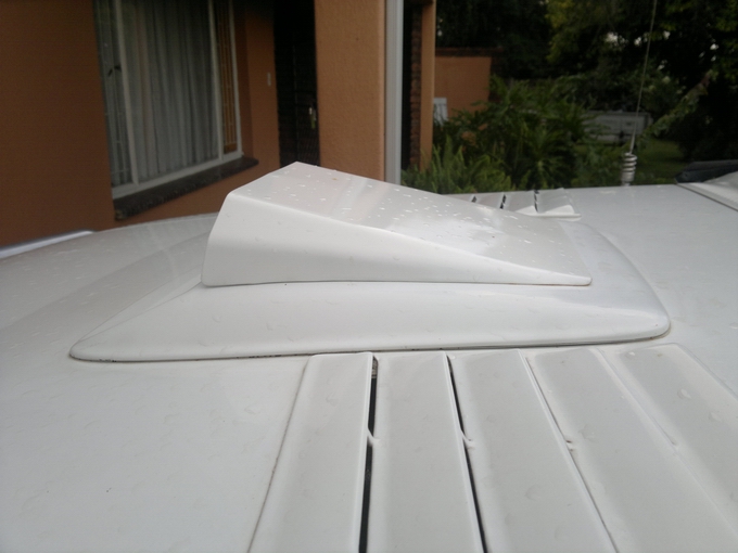

Pieter.... I was still having relatively high EGT's on my Maiden, and figured that due to the intercooler being on top of the motor, with a shhhhhhhhh load of heat from the motor and the turbo causing heat to be transferred to the I/C itself, I figured that I needed to get more air into the I/C to help get the heat transfer down. So I did a little mod on my existing scoop on the bonnet. and did a test run from JHB down to the Cape, then up to Kimberly, then to Bloemfontein, and back to JHB, with remarkable differences !!!! I seem to have the EGT's down by around 30 - 40 deg C..... :surprised: :surprised: :surprised:
I wanted to use a Subaru scoop, as they have a huge mouth opening, but there isn't enough space on my bonnet.
