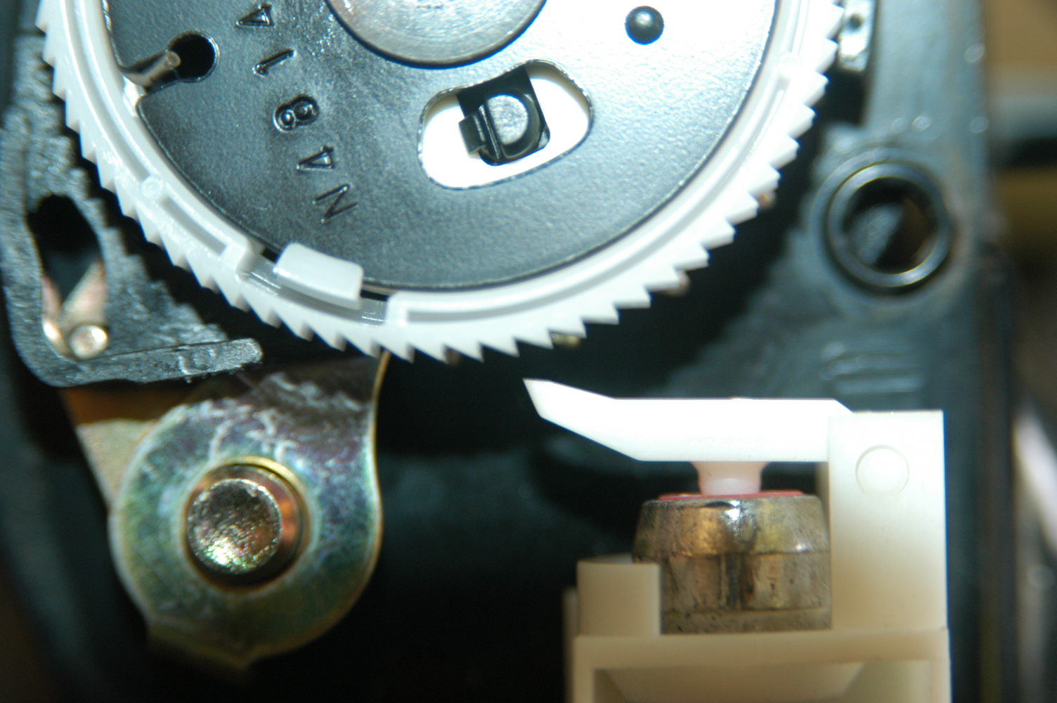

Standing with the reel in my hand, I noticed this, which of course is like showing a bull a China shop:

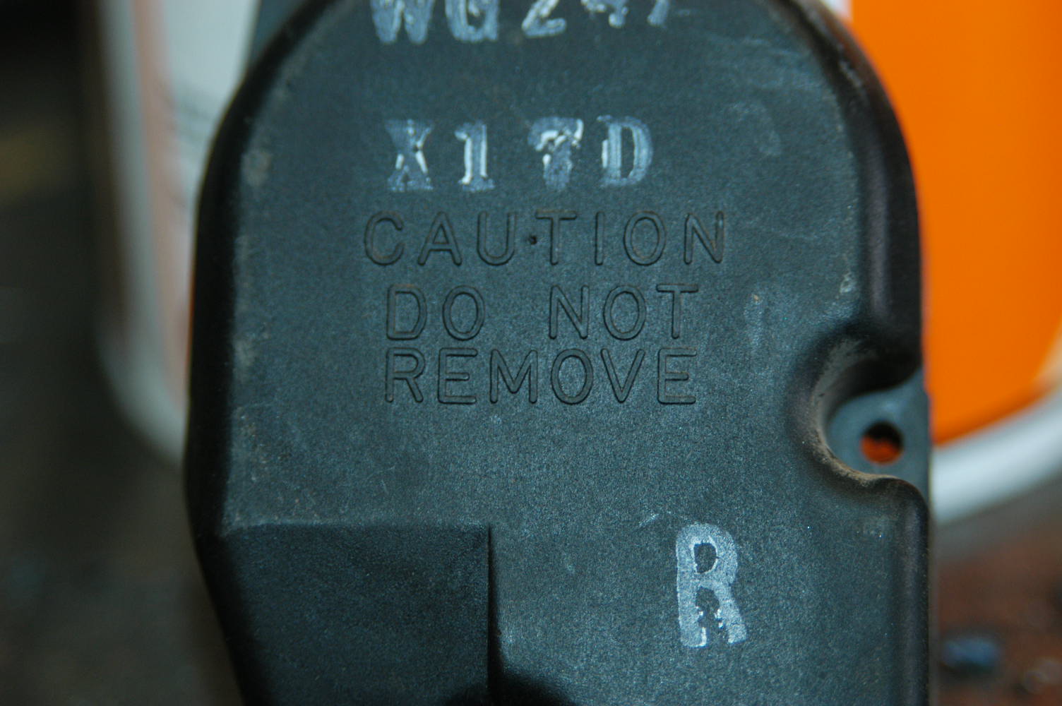

Behind the cover, I found this:

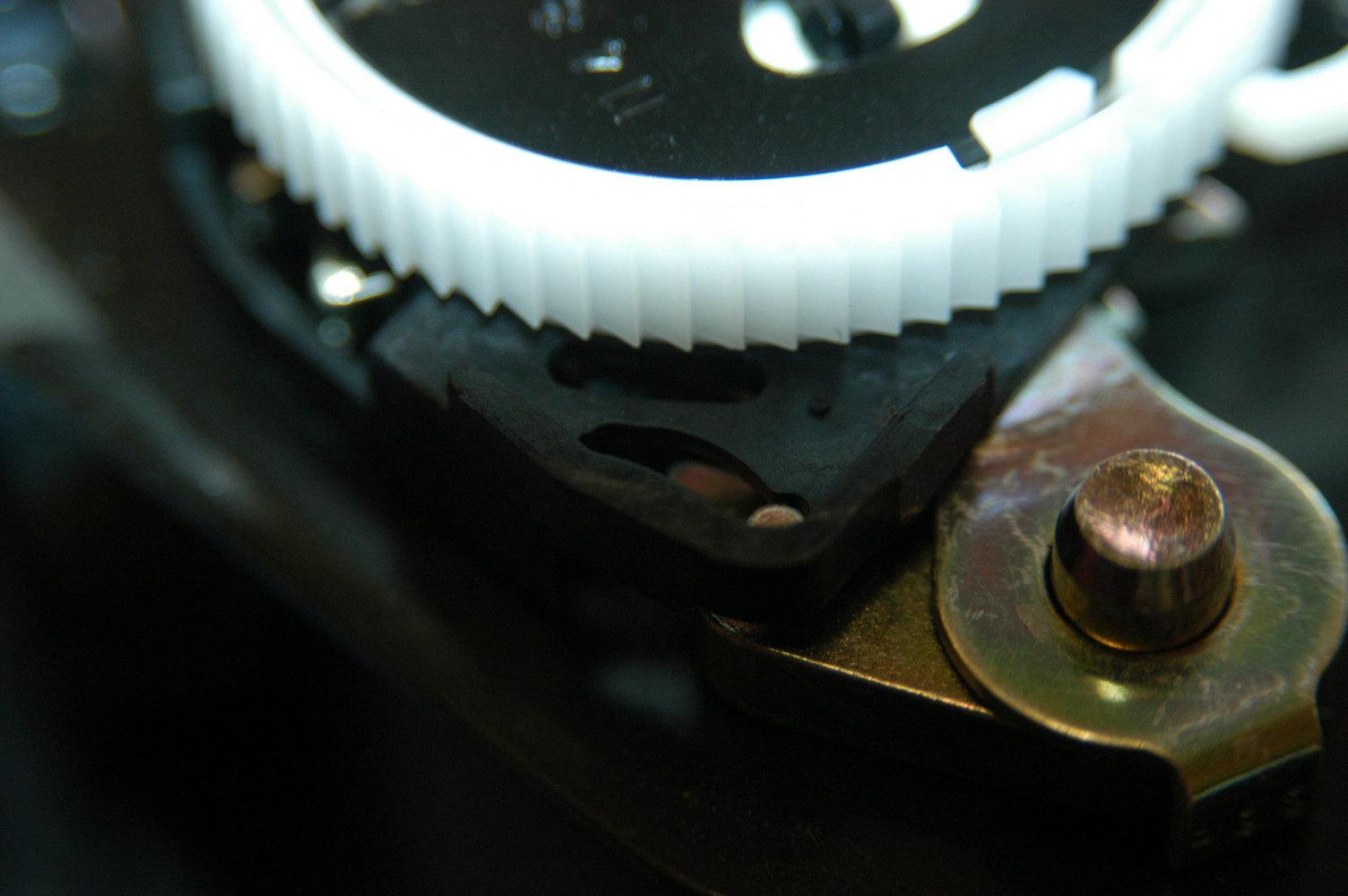

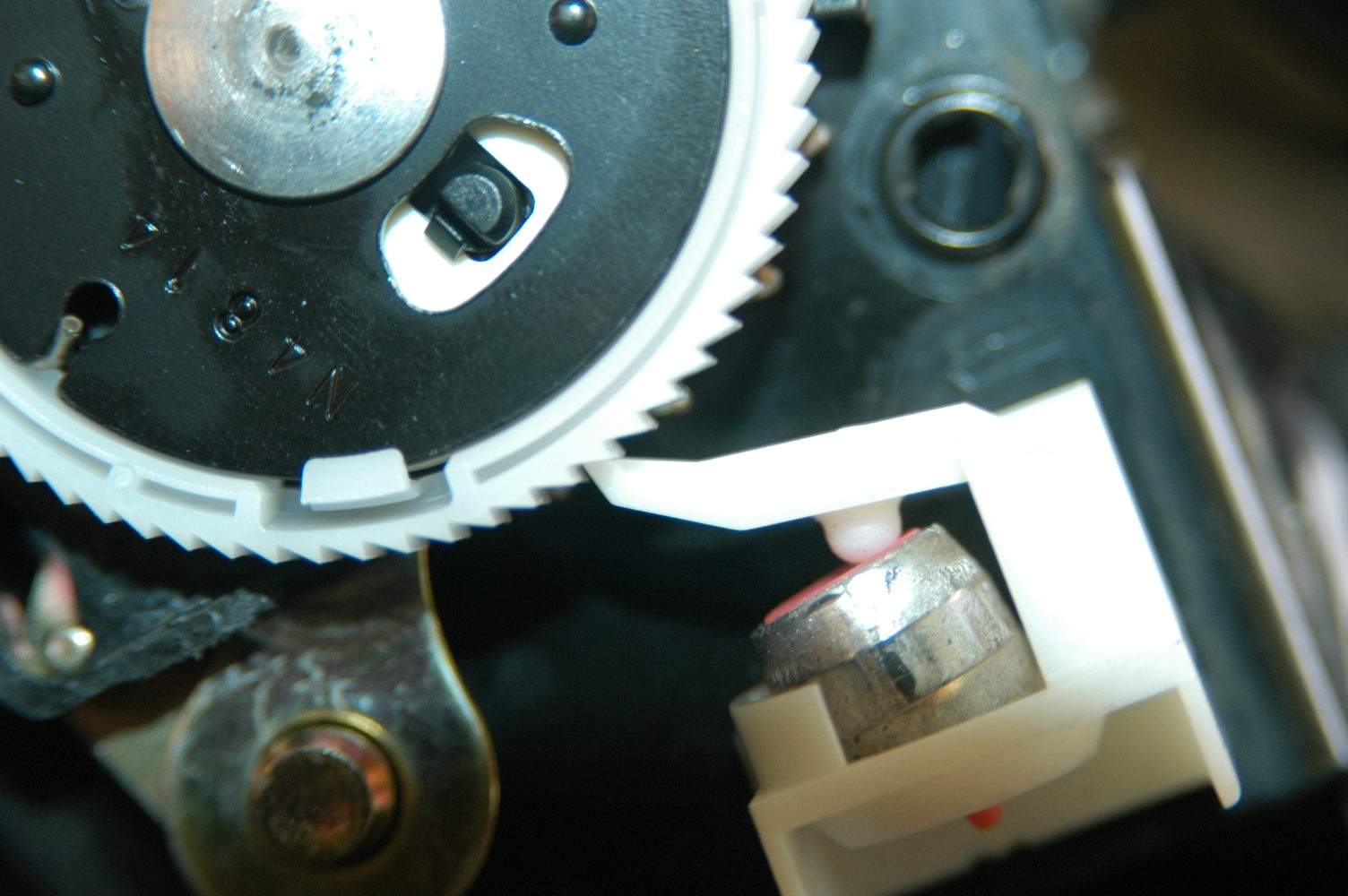

The silverish ball-thingy falls over when the seat belt reel (and therefore normally the car) is on an incline, like this:
This would also happen under acceleration, and causes the white pall to engage the white gear. The white gear is connected via a constant-friction clutch to the black cam-plate beneath it, so that if you try to pull the seatbelt while the pall is engaged with the gear, the cam plate moves which forces the main pall (sort of golden colour) to engage the main ratchet gear, thus locking the seatbelt:

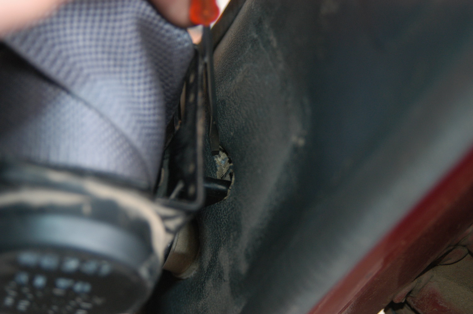

All this was working perfectly, so i put the cover back and re-installed it. By now I had realized exactly what the problem was.
The bolt holding the reel was slightly loose, and the reel had swiveled forward, tearing the trim panel as can be seen here:
I turned it back to the original position, tightened it and viola, problem solved.

By the way, the sensor and pall unit can be removed quite easily, it just clips in, however for obvious reasons I would strongly recomend that it be left in place.
