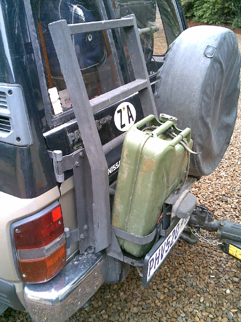

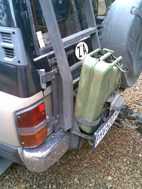

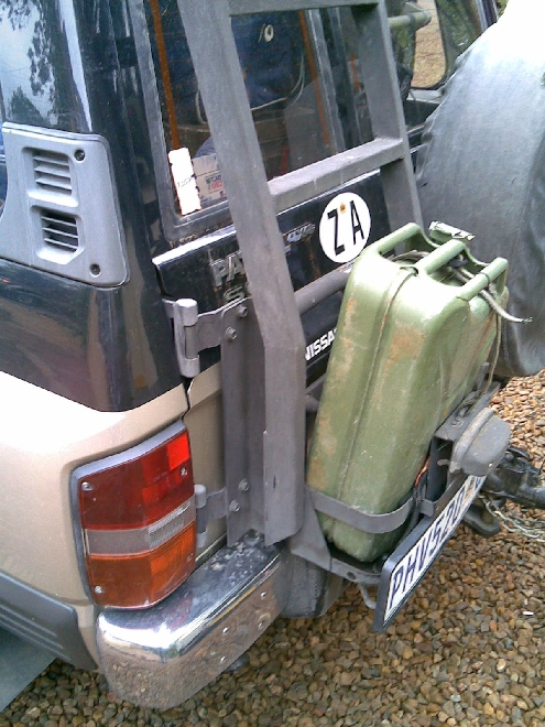

Why you need a ladder to get on Patrol roof? what you wanna do up their, You kids up to mischief again? - Just stand next to the car and put up what you want and take down what you need ...[of i sjulle von die kort oukies?] :lol: :rolling:
I'm looking for the picts, will post it asap - Friend Japie vd Westhuizen has a "home made" on his 'Trol and beats anything else I've ever seen, hands-down
OuuuuKyyyyy - found 'em:
leertjie vi Ptrol.jpg (298.14 KiB) Viewed 3065 times
leertjie vi Ptrol2.jpg (322.31 KiB) Viewed 3065 times
leertjie vi Ptrol3.jpg (327.11 KiB) Viewed 3065 times
leertjie vi Ptrol5.jpg (115.29 KiB) Viewed 3065 times
