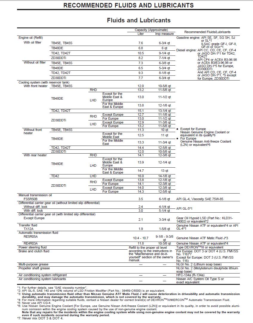

Recommended Fluids and Lubricants
Post by David »
I am always looking for this...
Recommended Fluids and Lubricants.JPG (181.04 KiB) Viewed 9543 times
edit: I changed my front diff oil on my 2006 GU and the quantities varied from above . I used 5.5 liters for the front diff :surprised: and not the 3 specified

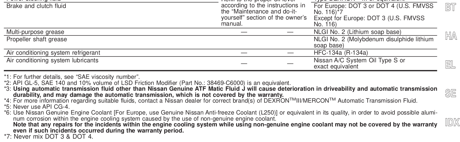

Brake/clutch fluid: If dot3/4 is recommended for europe, what would we use in africa? 3 or 4?
David
Posts: 723
Joined: 17 Dec 2009 12:42
Full Name: David Prinsloo
Nickname: David
Home Town: Stellenbosch
Location: Stellenbosch
Been thanked: 49 times
Re: Recommended Fluids and Lubricants
Post by David »
The manual says: Except for Europe : Dot 3
...but DOT4 brake fluid has a higher boiling point than DOT3 so personally I would opt for 4
Posts: 6168
Has thanked: 1141 times
Been thanked: 1049 times
Dot 4 has a higher boiling point, but is more hygroscopic (absorbs water faster).
So use Dot4, but then replace brake fluid annually...
Posts: 3369
Has thanked: 248 times
How much brake fluid would a tb42 clutch system use?
Posts: 6168
Very little. Maybe 150-250ml?
Peter, what "Dot" brake fluid can we use in our Patrols. I know one shouldn't mix, for example Dot 3 with Dot 4.
ricster wrote: 25 Apr 2022 09:13 Peter, what "Dot" brake fluid can we use in our Patrols. I know one shouldn't mix, for example Dot 3 with Dot 4.
Cedric, the manual states Dot-3 or Dot-4 for Europe, and Dot-3 elsewhere. So pretty sure that either or is fine. However, refer Peter's earlier disclaimer regarding hygroscopicity.
