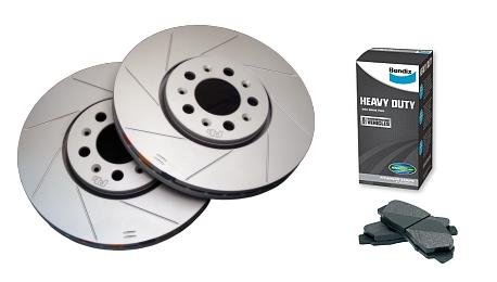

I have invested in a Powerbrake all terrain disc and pad kit for my Patrol. (They are only available for the front). I will only fit it after the holiday, though.

Well, about a month ago I also changed to Powerbrake disks in front (my originals started to wobble/shudder when they heat up when going down a mountain pass :surprised: ).
I was also very impressed with the service and response from Francois. It cost me R4565.70 incl VAT for the Powerbrake All Terrain Series front brake upgrade kit - AT316N1361HD and another R171.00 for courier delivery to Stellenbosch.
The kit consists of a pair of (front) Powerbrake All Terrain Series high-performance slotted discs as well as a set of (front) Bendix Heavy Duty matched high-performance brake pads.
The quality of the kit is excellent and it was quite simple to fit. (Must say I was a bit shocked when I felt the weight of those disks - they are heavy!) You have to do a bed-in procedure after the pads have run in (http://www.powerbrake.co.za/tech_info/tech_02_bedin.htm)
I did this after about 600km's and although the brakes were good they were never as good as my original brakes :think: The Bendix pads which comes with the Powerbrake kit tends to screech when cold and has less feel because they require more pressure to stop effectively. :thumbdown:
I thought this would improve but after more than a 1000km's I decided to change my pads back to the OE spec Hitachi pads and voila my brakes are again excellent! :thumbup:
I can recommend the Powerbrake disks if you need to replace disks but would rather go for the Hitachi pads :mytwocents:

Thats interesting information. In fact the guy I bough my vehicle form had similar problem. Just beofre I bought the vehicle he tried to replace the front pads with Ferodo and found that they were noisy and did not perform well, so he went back to OEM parts, and things were back to normal. I now have the Ferodo pads sitting on my workbench at home.
Has anyone else experienced this phenomena....

Some pads work great from the word go(cold), but fade when they start heating up.
Pads like the bendix H/D need a bit more heat and will perform better when hot and less fade when seriously worked/hot.
I have pads on one of my 350Z's/track toy that sucks when cold but can take abuse and heat and work's better when moerse hot!
:mytwocents:

I agree about the pads but think it is really horses for courses. If you are going to be on the brakes all day then the Bendix compound is for you.
The Powerbrake disks are painted with max temperature recording paints which discolours when a certain temp is reached. I have with normal use (including a few mountain passes) only discoloured the lowest temp one. Maybe I don't brake enough :lol:
90% of the time the Bendix pads only heated up enough to stop sqeeling and perform properly when I have already reached my destination! :confused: I also tend to drive long distances where you hardly ever brake (like going to Namibia) where I prefer having a compound that will react immediately if I have to do an emergency stop :thumbup:
