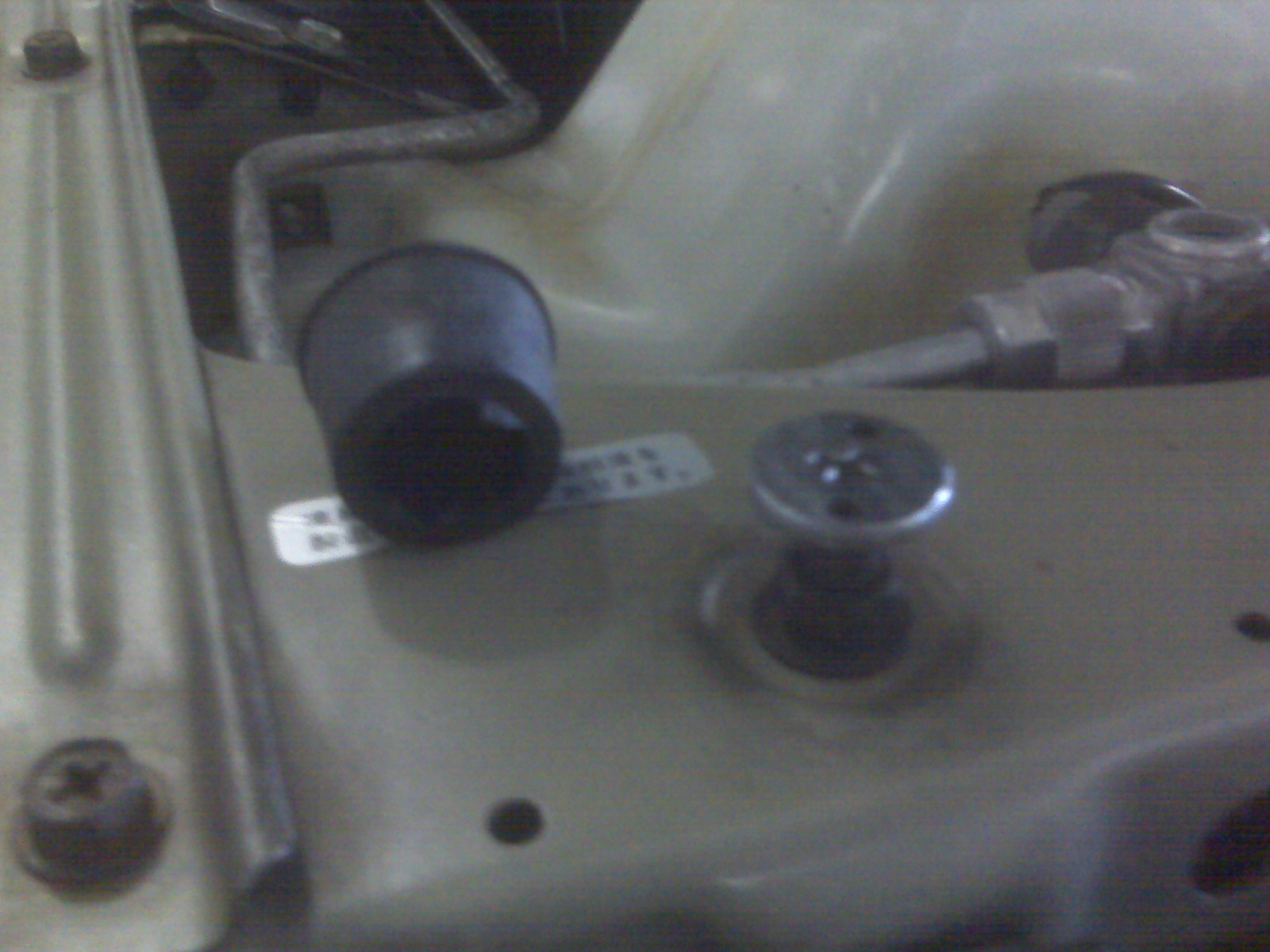

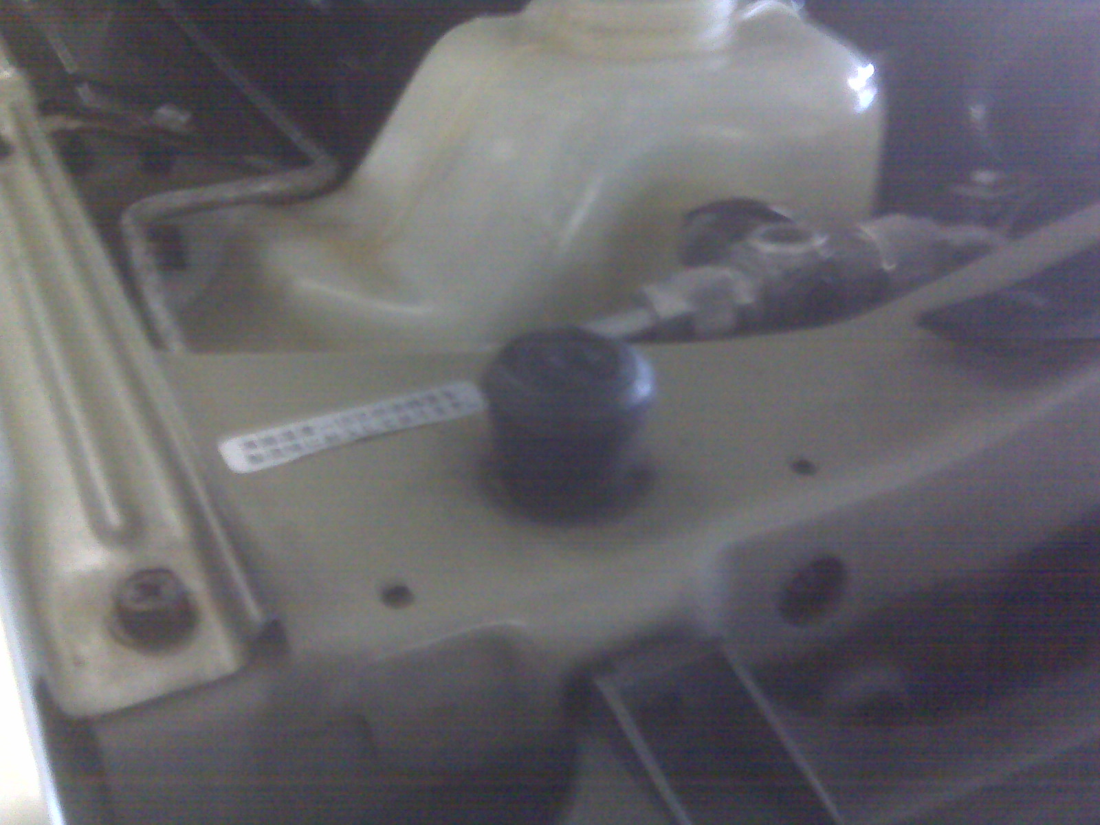

If the rubber has come loose from your bonnet stops you can buy 18.5mm RJK rubber ferrules as a quick and cheap repair. The rubber ferrules fit snugly over the original steel bonnet flange and cost less than R10 for four at Mega Mica. Works a treat!
- IMG00307.jpg (380.07 KiB) Viewed 1224 times
- IMG00308.jpg (367.92 KiB) Viewed 1224 times
