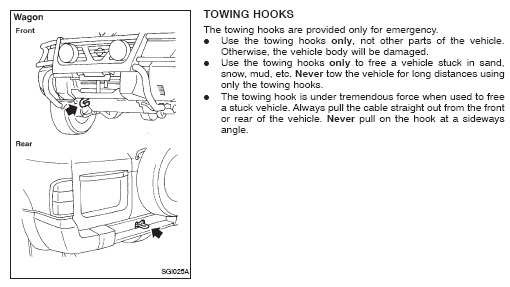

Dis wat die Patrol Manual sê:
- Towing Hooks.jpg (58.55 KiB) Viewed 3867 times

Yes Len, that's exactly the loop I was refering to. I've got a ball and pin fitted to the tow-hitch and I've heard different opinions on that as well, the majority of which relates more to the mounting of it (with High Tensile bolts) than the piece of kit itself.
The loop seems sort of flimsy to me and as stated on the excellent thread posted by John, my concern is its size and mounting orientation.
