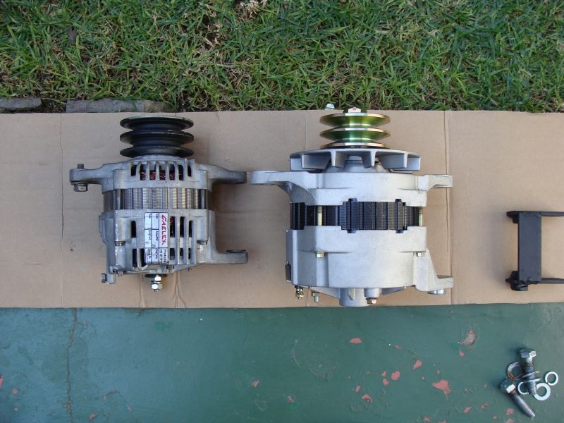

The drive pulley has approximately twice the radius of the driven pulley, so it will run at twice the engine speed which is safely within the design specs. The wiring options are nice & flexible, so that won't be a problem either. Size-wise it seemed OK, even though it was a bit bigger. The only problem we foresee up-front was with the SAE J180 mounting. The standard alternator has an 8cm spacing between its mounting feet, this bloke has a 10cm spacing. It still seemed like an easy task for a Saturday, so I dusted the welding machine & angle grinder off in anticipation. When it finally arrived and I placed the new alternator next to the old one, I realised just how misleading measurements in a spec sheet could be. This thing was a monster!
But it's so big!
But it's so big!

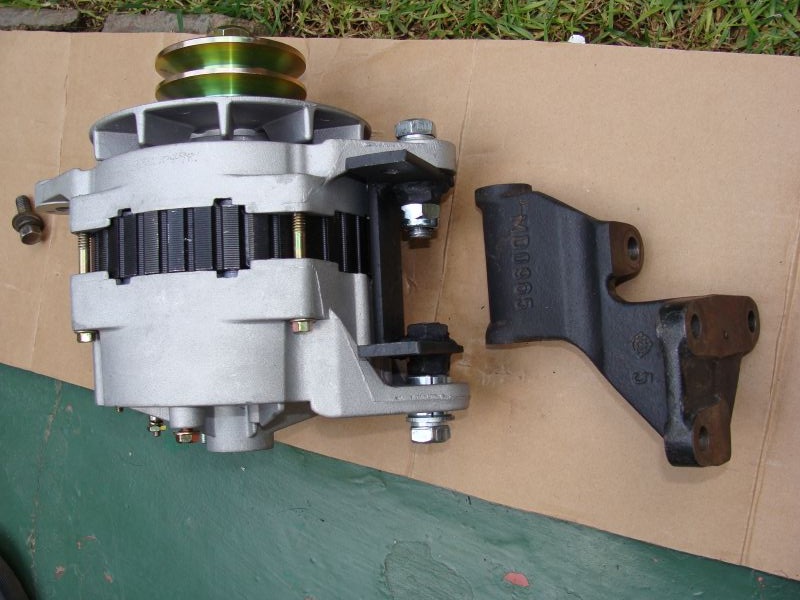

Any way, back to bracket-modifying business! To ensure that the top of the alternator stayed in line with the tensioner bracket, I had to make a bracket that lowered the bottom of the new unit. It also needed to move the alternator further away from the engine block so that it would not catch anywhere. Once I saw the strength and complex shape of the existing brackets, so I decided on an adapter bracket for the bottom.
It turned out to be very simple: some bits of 5mm flat-bar welded together, drilled through, braced with another bit of flat bar welded onto it, and bolted to the alternator gave me everything I needed. A strategically place nut was welded onto the other side of the bracket to give the final 10mm of increase required for the J180 mounting distance.
Here's the final adapter bracket, bolted onto the alternator:
Adapter bracket ready and painted.

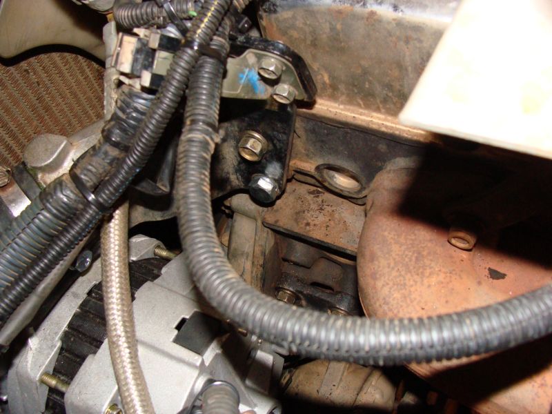

Right... I replaced the bottom bracket (very solid item, with 4 mounting bolts!), then bolted the alternator and its adapter bracket onto that. So far, so good! But when I replaced the top tensioner bracket, it bumped against the alternator body :think:
Again opting to retain old brackets and keep things simple, I experimented with by putting some sturdy washers behind the lower bolt of the bracket. This ended up giving me just that bit of lift (about 1 cm) I needed at the top. It did require the use of a longer bolt so that it still grabbed enough thread inside the engine block:
Spacer washers hiding between lower shiny bolt and engine block...

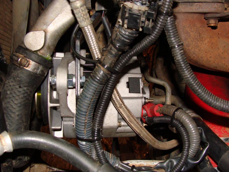

Here's the alternator all wired up:
Still missing it's earth connection though...

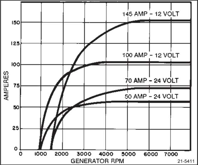

So how does it all work in practice? Its graph (the 145A one) shows that it starts delivering charging current at around 1500 RPM (alternator) speed, but it says nothing of voltage, and we also have the issue of pulley sizes to contend with.
21SI series alternator outputs
I found that it does not supply any voltage at my engine's 800 RPM idle speed - voltage remains at battery supplied levels of around 12V-12.5V. Touch the fuel pedal slightly and it quickly rises to about 13V at 1000 RPM, and tops out at 13.8V (its regulated voltage) at anything over 1250 RPM. So it starts at very low engine revs, even in self exciting mode...
When the engine is spinning at a lowly 1750 RPM I can turn on the brights, all 6x spotlights and the air-conditioner and the voltage will not drop under 13.6V. This alternator can handle heavy loads without breaking a sweat! :woo:
