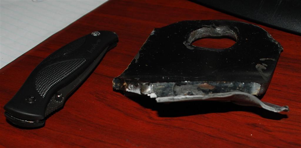

Re: Bolt-on or Weld-on
Just don't confuse it with this:
- 3325086381_6fa21aee14_o.jpg (55.37 KiB) Viewed 2002 times
Stefan wrote:What is that John?
Standard "recovery" points on our patrols.,.....ripped off the chassis during a recovery no doubt......not exactly up to spec. I still cant believe that purpose built 4wd vehicles are not equipped with meaty points as standard.
Why cant one bolt it ....AND weld it!Izak wrote:If it is done well I have never been disappointed in the strength of a piece of steel that is welded together, on the other hand the force on that welding during a Kinetic rope recovery or a winch operation must be considerable.
