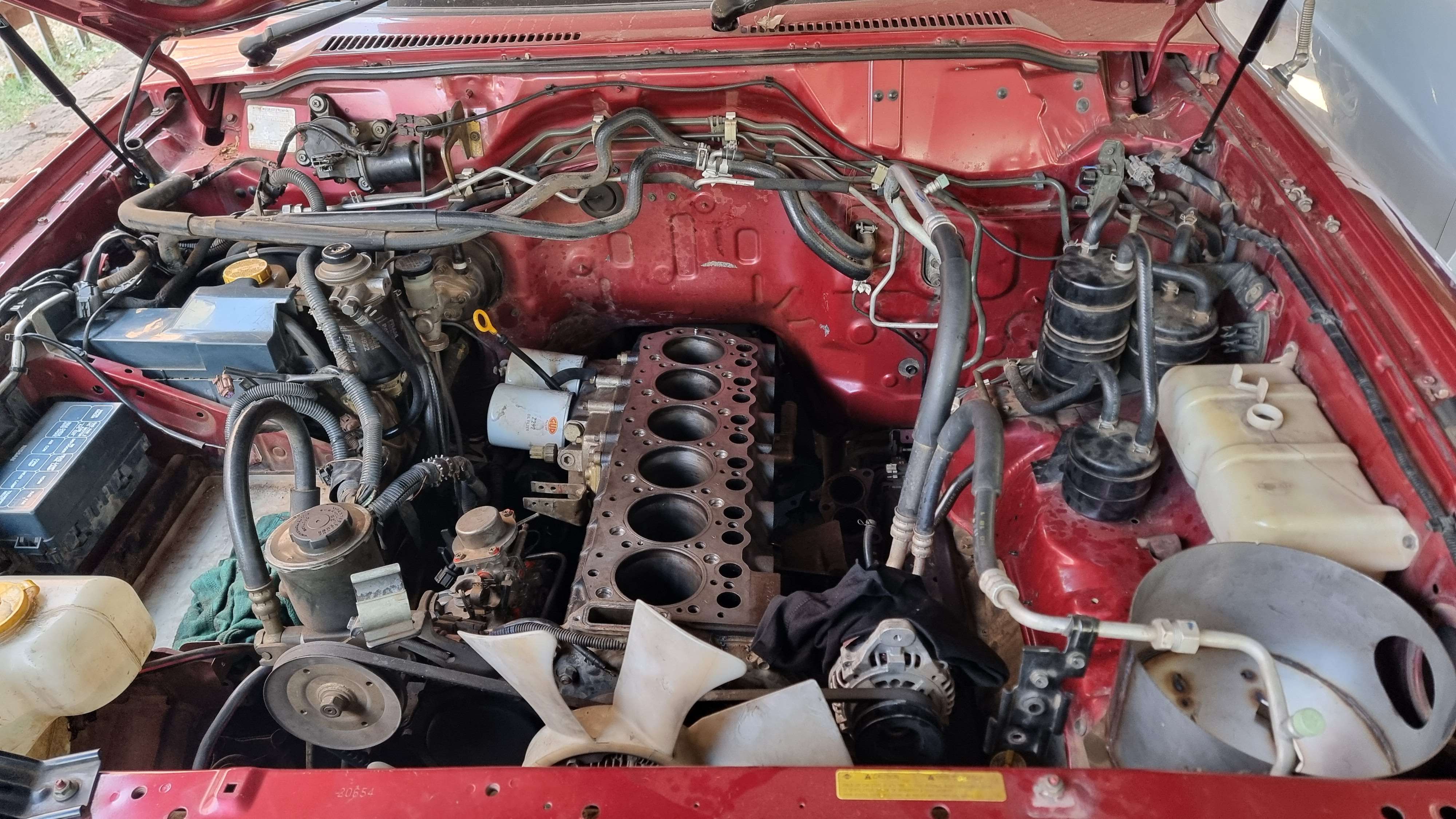

Step 1 we remove the head, drop the sump and remove the conrods with pistons so that we can replace them with the proper turbo spec pistons.
Just a pic of the engine bay with the head off

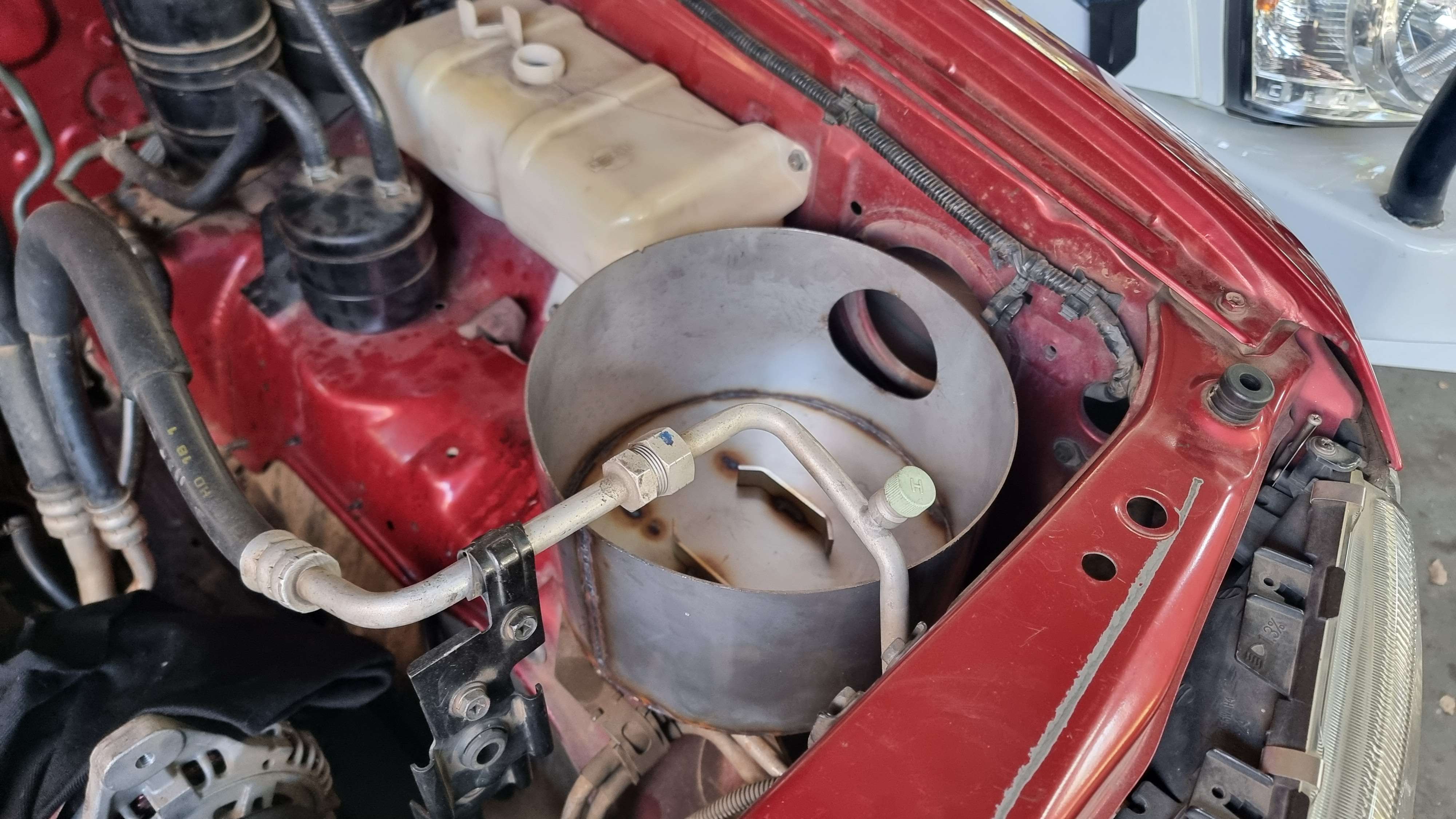

While the head is off and we have some space, it's the ideal time to assemble the air box and install it on its correct location

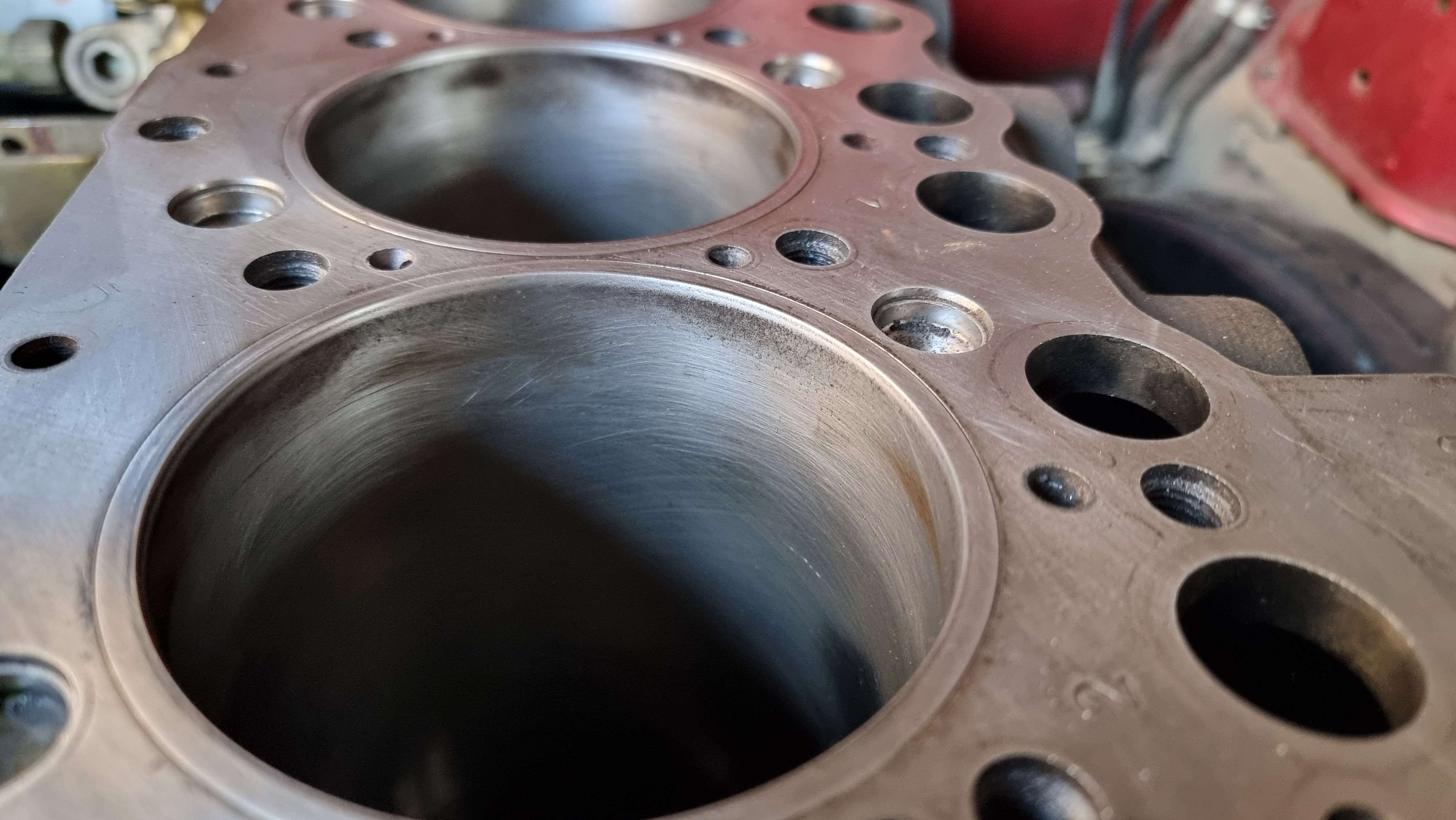

This is how your engine's sleeves should look after 300,000km+ and this is why it is no surprise to see a TD42 go past 1,000,000km. You can actually still see the factory hone marks.
We have just cleaned the carbo off on the top section of the sleeve. There is zero wear on this engine.....

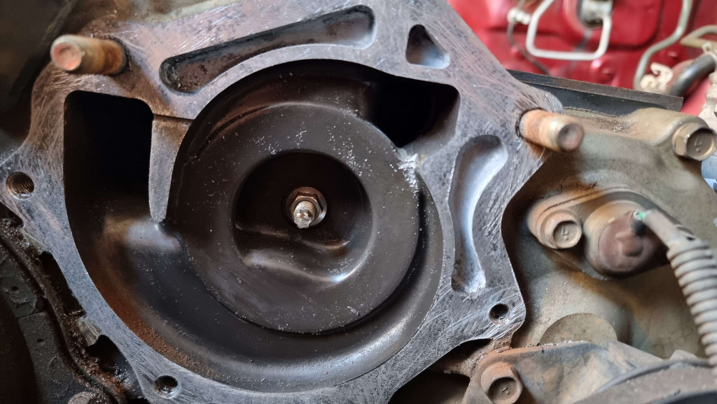

We always check the cooling system and inspect the water pump.
In this case we will be changing the water pump (just because its not expensive) and the fan blade (because it has started to crack, but will show this in the next post).
In the photo you can see very slight wear on the timing cover. To be honest I am not sure what causes this other than cavitation. The vehicle has no corrosion in the water system and was driving with coolant from day 1.
The wear is nothing to be worried about and the engine will not receive a new timing cover.
