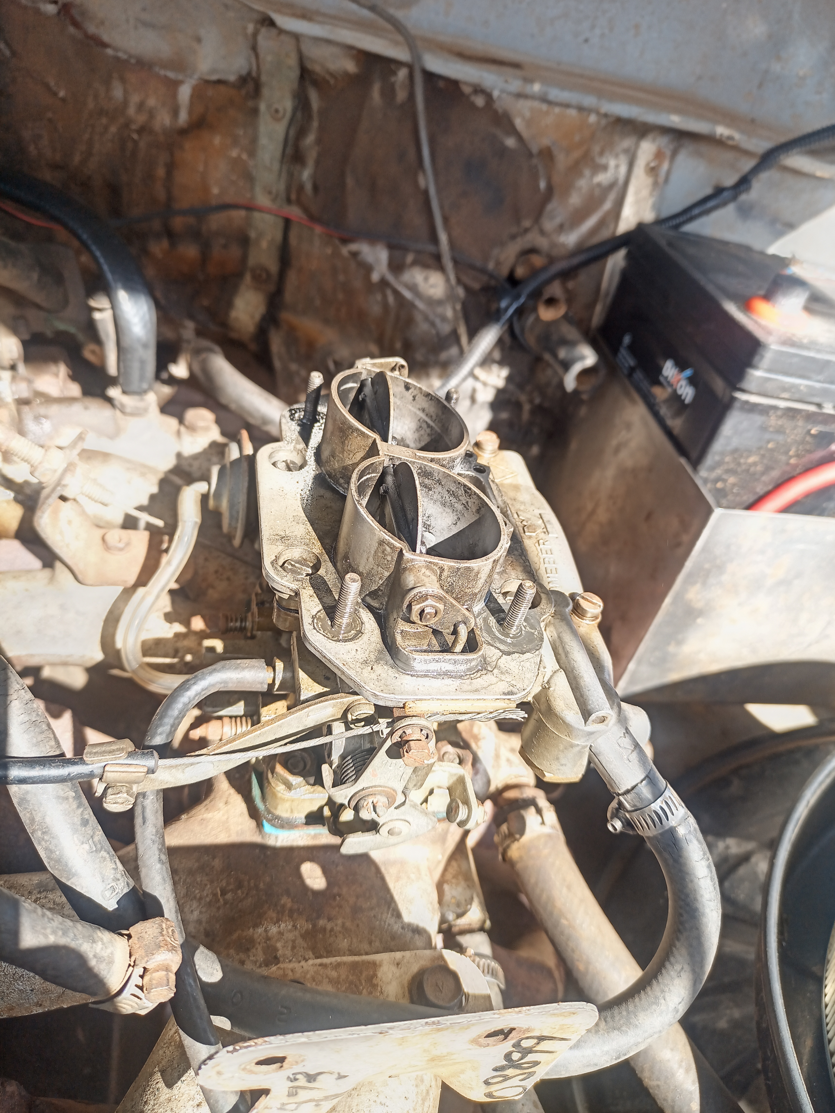

There's no visible float on this car. Also, I don't think it's the fuel. When I put fuel directly into the carb it doesn't start. Starting just "happens" intermittently. Also when I push the accelerator it still supplies ample fuel into carb.
I've checked the points numerous times and adjusted timing to multiple positions, although I still think the issue must be around there.
I can add videos or pictures of anything you guys might want to see.
