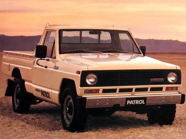

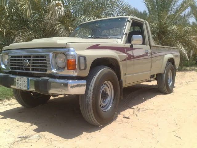

Myabe this help to identify it.
Dewald
Dewald
- GQ Patrol / Safari
- images (2).jpeg (44.55 KiB) Viewed 7574 times
- MQ 160 Series Safari / Patrol
- images (3).jpeg (30.55 KiB) Viewed 7574 times

Hi ,
Many thanks for all the info
The vehicle in the bottom image is the one
I will try and get photos and more detail this weekend

I thought it would be that one, then it should have the Ld28 in if its still original.
If it it has a td42 swapped in its great.
Keep us posted.
