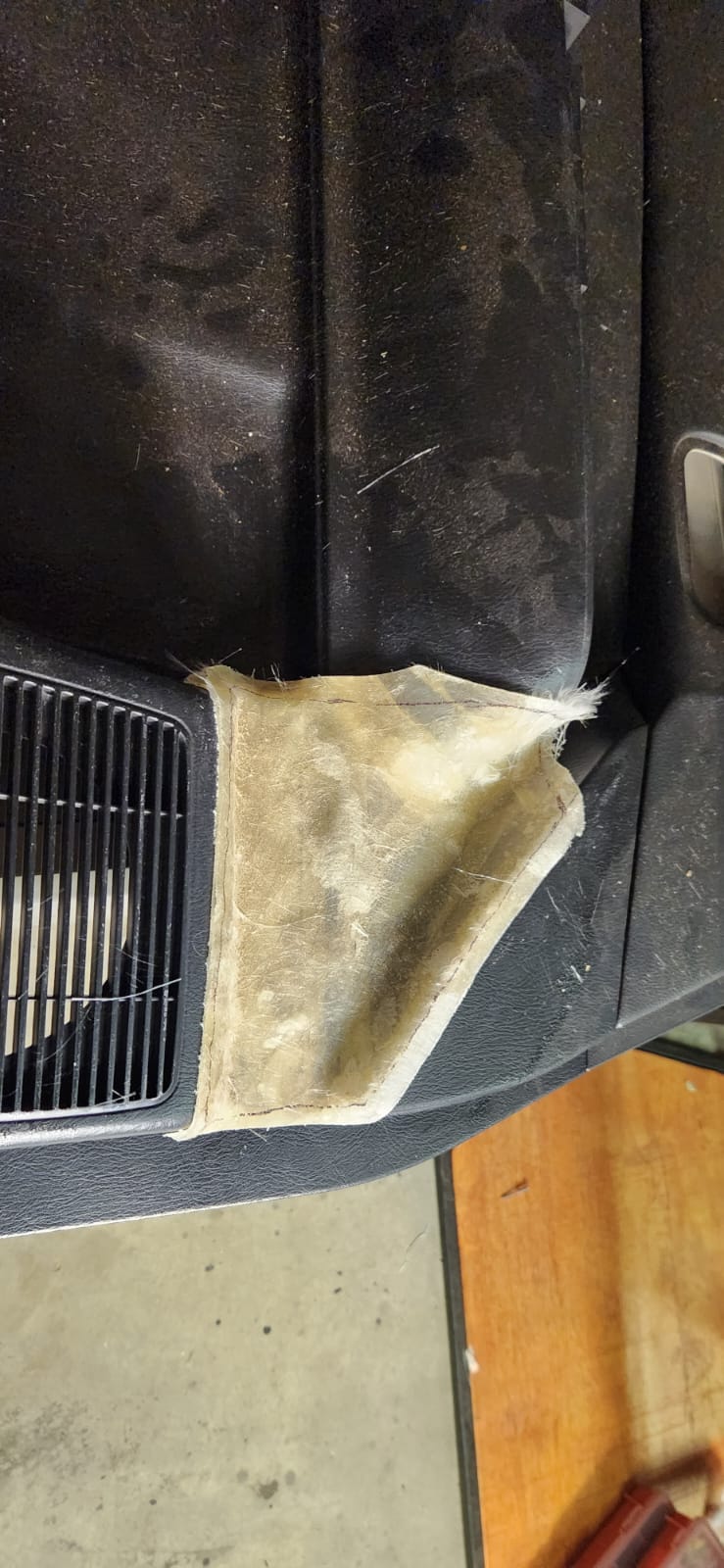

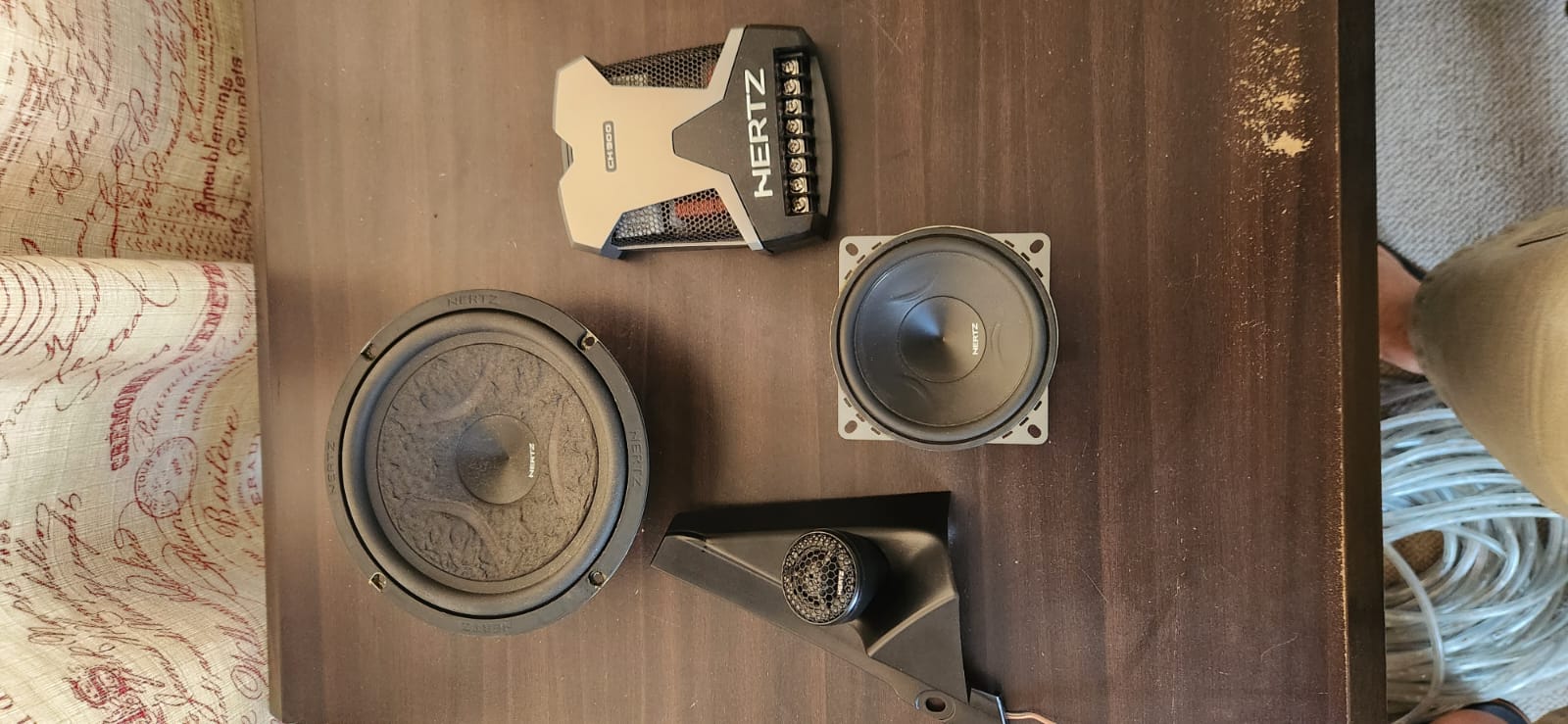

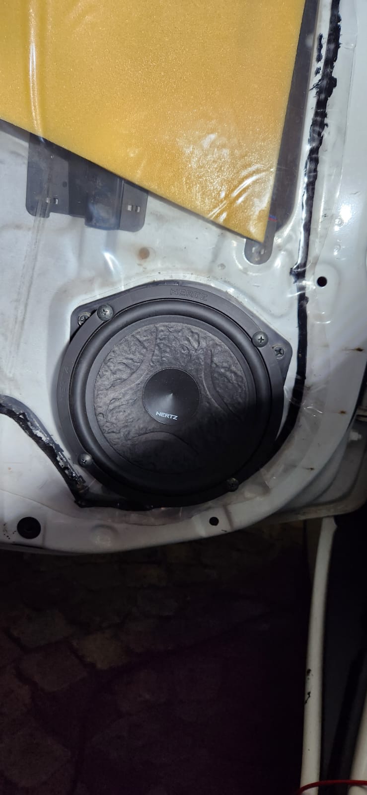

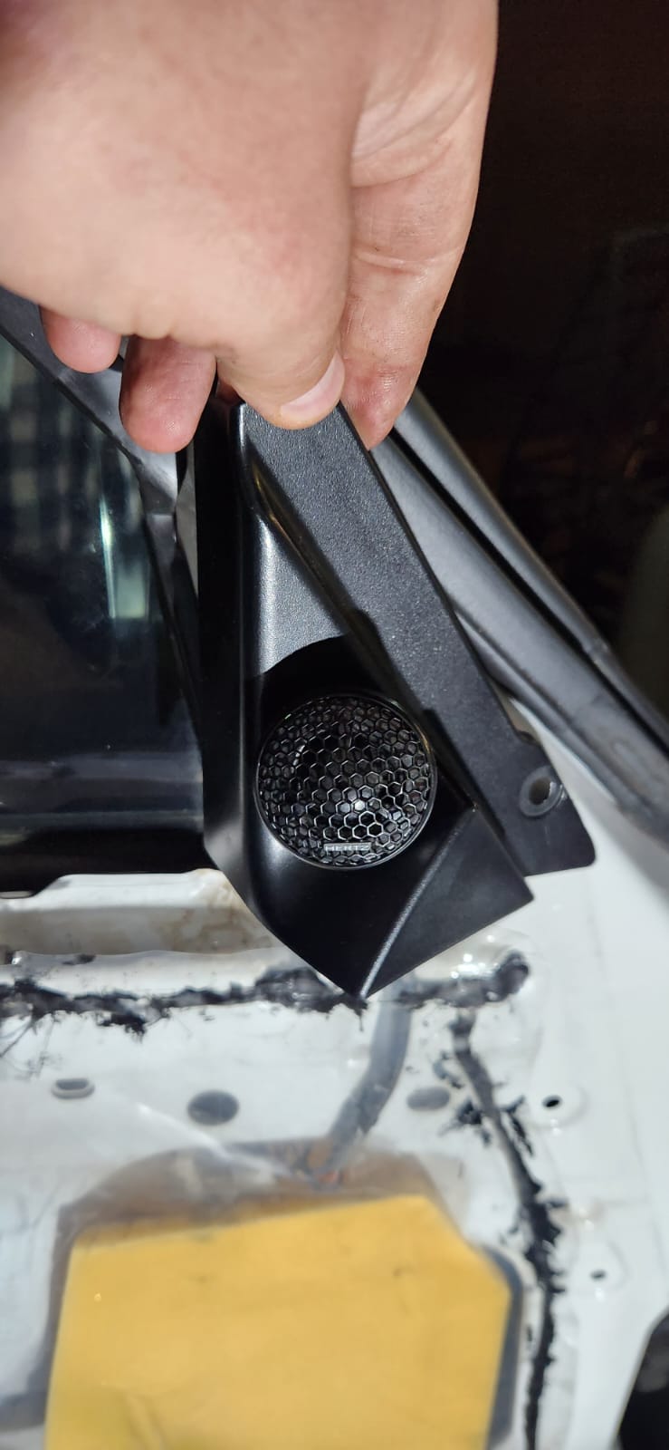

Quick update from my side, I know its been a while now. The biggest fight so far has been the Hertz 3-way mid split system, there are 3 speakers per front door now....

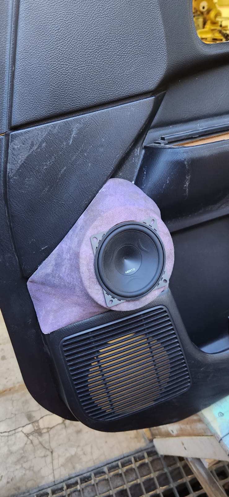

The tweeters are mounted on the door pillar, the 6.5 inch woofer went into the door speaker spot nice and easy but then I ended up with the 4inch mid unit with nowhere to go. So I tought myself now how to do some fibreglassing and have been moulding pods for these speakers that fit in the door.
They ended up purpler now as that was the only material I had lying around the house to do the final cover, Needed to be a stretchy tacksuit pants type material to mold well.

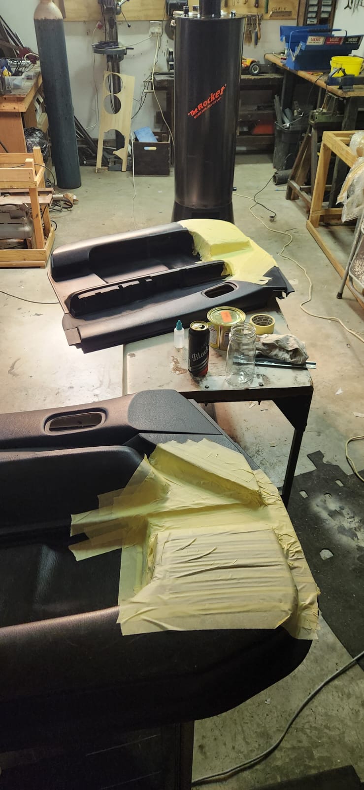

A friend of mine said it would be a quick process but each layer needs 24 hours to cure and it needs 10's of layers depending on what you doing haha. so be warned if you trying to fibreglass. Its not a pretty process.
I have attached some pictures. Sub box, amp and all are still on the backburner while I have been fighting this. will update again asap (unlike last time).
Sub box I have been designing and redesinging so many times to get it "just right" eventually going to have to call it and start cutting some wood.
Start of the fibreglassing
Mid way through the fibreglass mission
Speakers on the table
New Hertz 6.5 inch
New Hertz 6.5 inch
Door Card off
Door Card off
Tweeter going in
Tweeter going in
Door Pod near completion

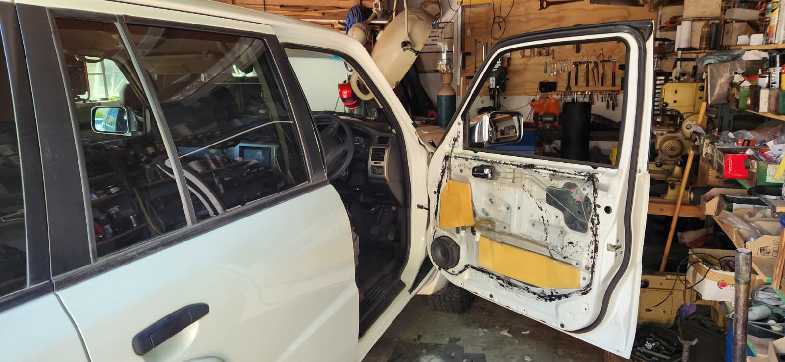

Sorry for going off at a tangent Mike:
That seems a pretty well set-up workshop, what kind of work do you do in there?
And what is "the Rocket"? A furnace of some sort?

I see Mike hasnt answered yet about the "The Rocket."
Its a Wood burning water boiler. You can say a modern day "Donkie"

Correct that is a "Donkie Boiler" thats gone out to a friends farm. Have a super old farm house there with no power, nice place to escape from the chaos, but some hot water is very welcomed.
As for the workshop, a couple of us mates have gotten together to make a "maker space" if you will. Purely for pursuing the hobbies. We religiously there every Thursday after work but obviously some project demand a little more so we end up there quite often.
It is super kitted out, all we missing now is a nice lathe and I think it will be complete, that is until we find a larger space for, car lifts and the like. Then we can really do some serious stuff.
Appologies for the mess though haha, need to spend some time doing some cleaning and organising again soon. its getting a bit out of hand.
Been an awesome experience, have been building it up now for the past 4 years, done many insane projects in there, looking forward for the many more to come.
