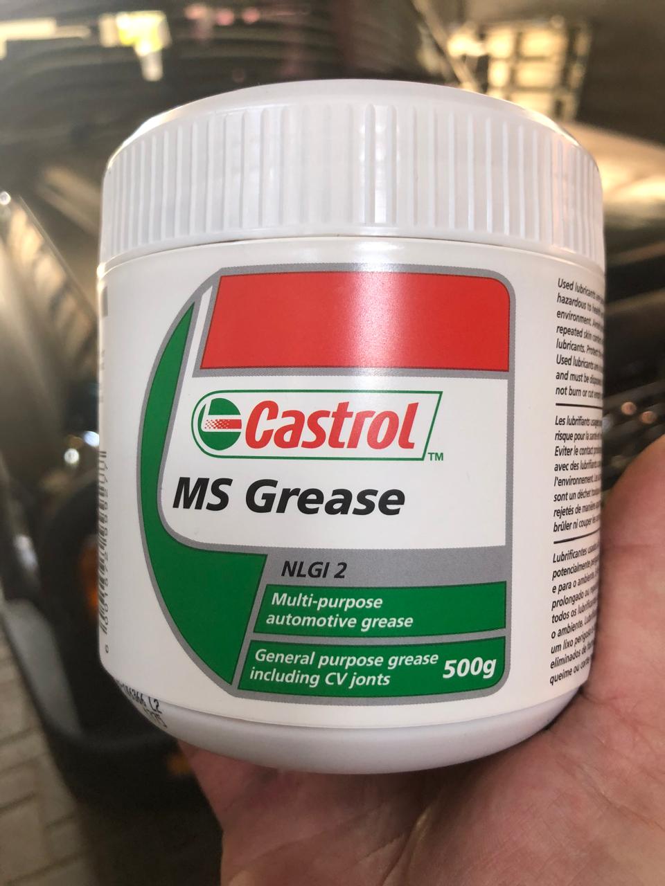

This the correct grease I assume?

It looks correct.

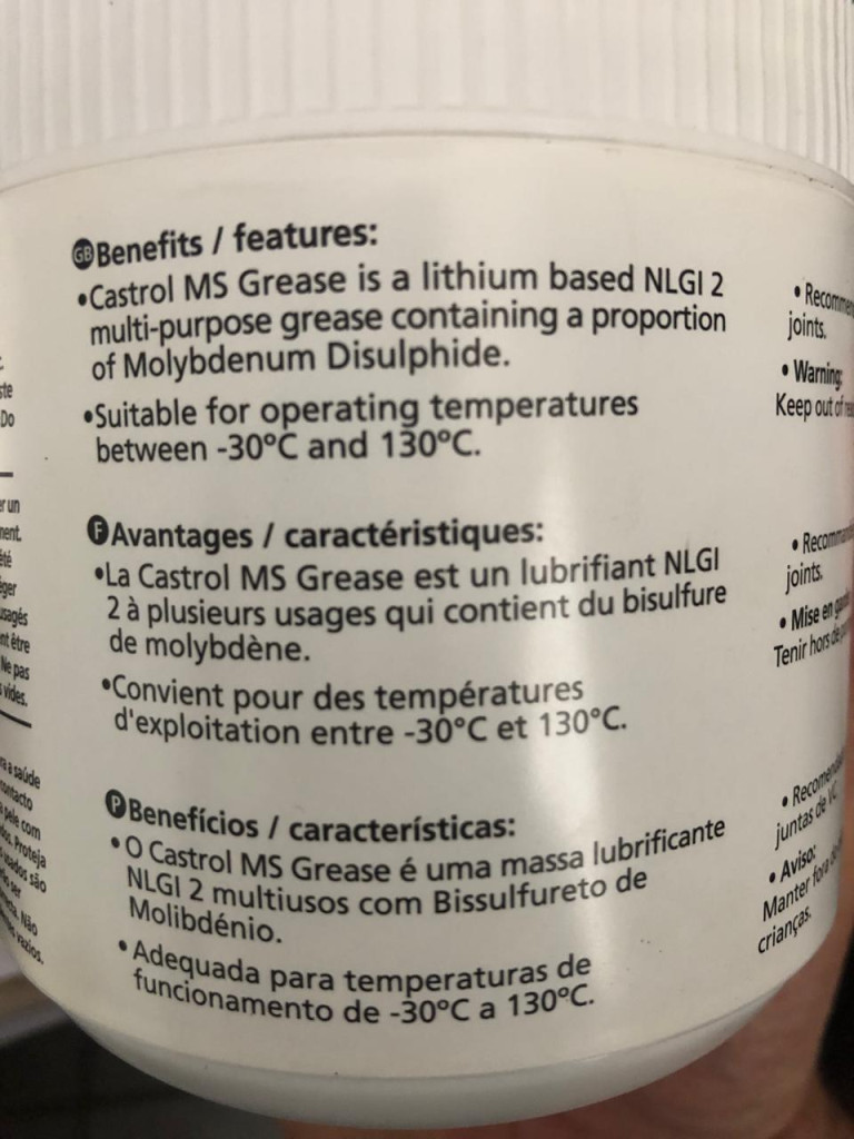

Re: Drivetrain problem?
It's the right spec but not necessarily made from the right materials.
In the fine print on thr back it should say what the base material is. If it's lithium soap, it's the right stuff.
You can also lokm at the colour, it should be quite lighr in colour.

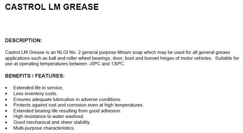

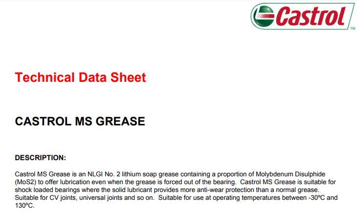

Print on the back of container.
Found this on the internet though:
I was wondering if the LM grease is a better option, but think MS is the correct one?
- lm grease.JPG (58.17 KiB) Viewed 1958 times
lm-grease.pdf
- (40.78 KiB) Downloaded 32 times
ms-grease.pdf
- (41.13 KiB) Downloaded 30 times

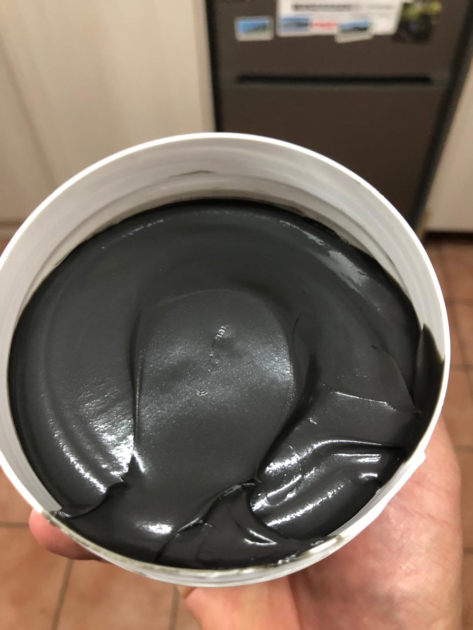

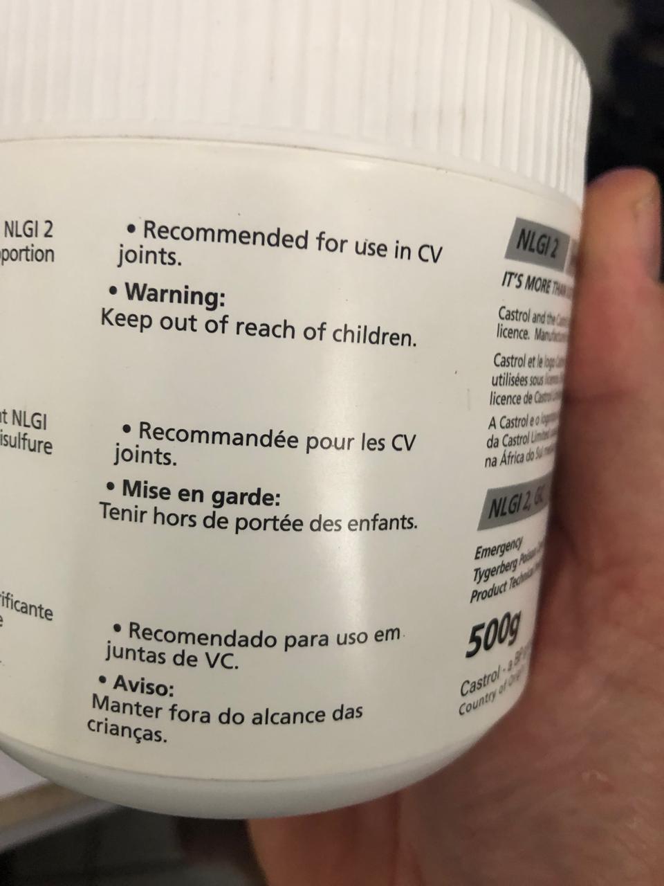

- Posts: 3328
- Full Name: SJC
- Has thanked: 237 times
- Been thanked: 203 times
Re: Drivetrain - correct gease?
dark in color...Peter Connan wrote: ↑03 Oct 2024 06:05
