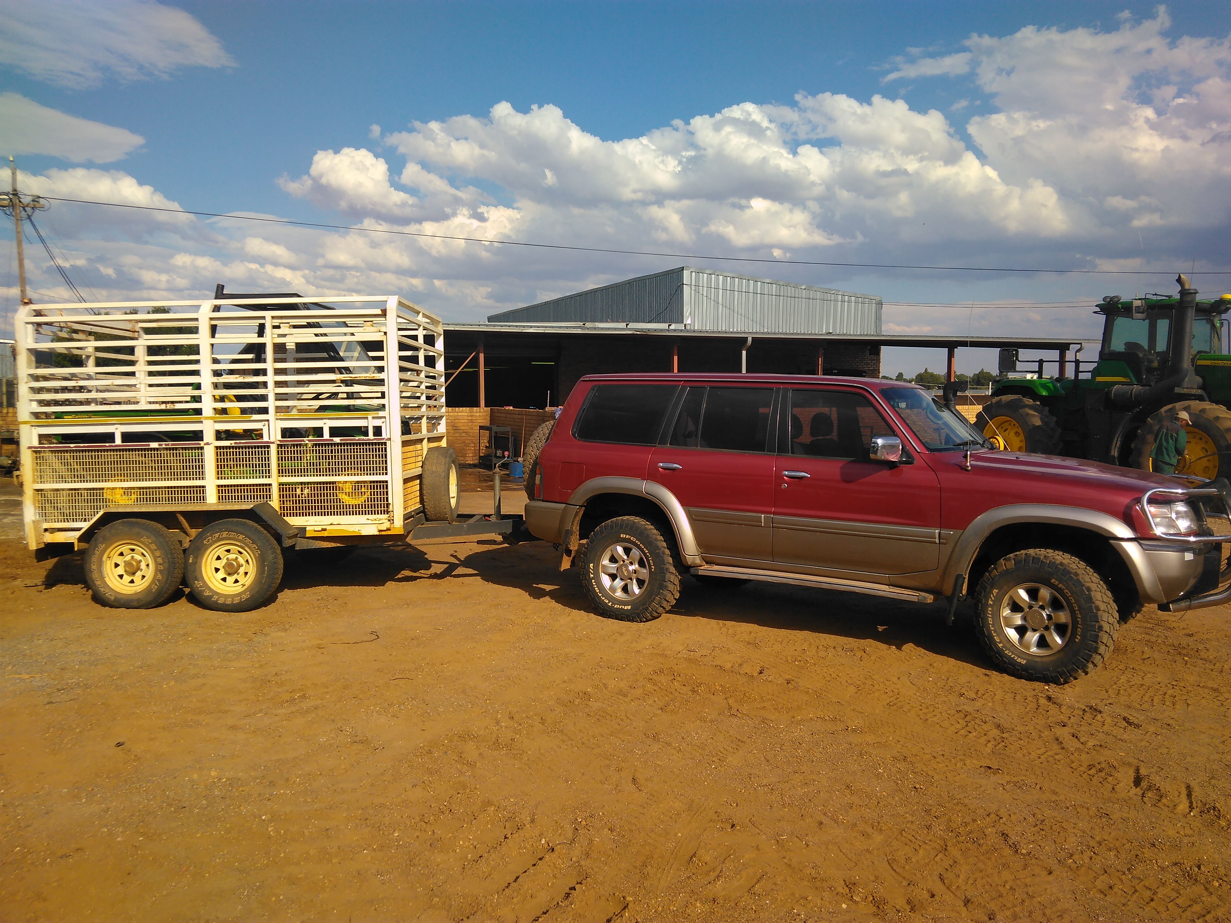

Did a short run to town and back with a heavy cattle trailer. Loaded (700kg trailer+700kg load) the following readings:
4th, 2000revs-2200revs, approx 85-100km/h - EGT 550-600
3rd, 3000-3200revs, approx 65-80km/h - EGT generally below 450
So, according to me that proves what Tinus said about the higher revs and more air. Feels counter-intuitive, but the readings don't lie.
Another thing, this is the same trailer on the same road that I burst a water pipe with in February. Was a bit scary
But, no worries, the water temp touched 100 C only once. Radiator fixed properly!
