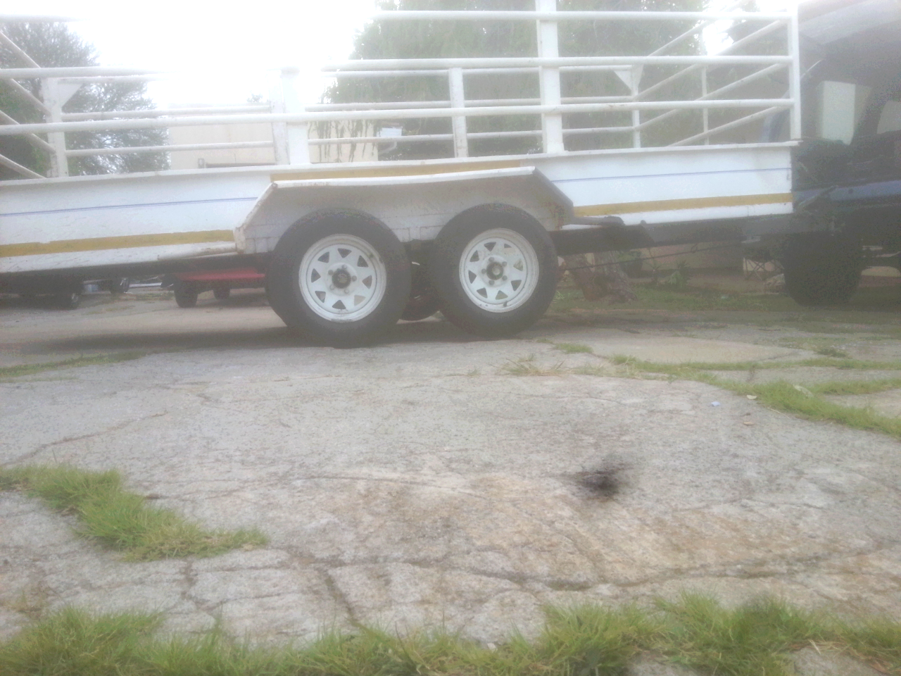

Sani was supposed to start doing duty transporting the bigger stuff for deliveries. Our first problem.....
Towbar tooo high
Towbar tooo high
2015-12-16 22.37.41.png (1.44 MiB) Viewed 6603 times
This trailer probably sits the best behind the Sani at the moment, but you can see that its braked axle is off the ground most the time. I need a drop plate of at least 300mm to get back to a good towing height. The ball presently sits at 740mm

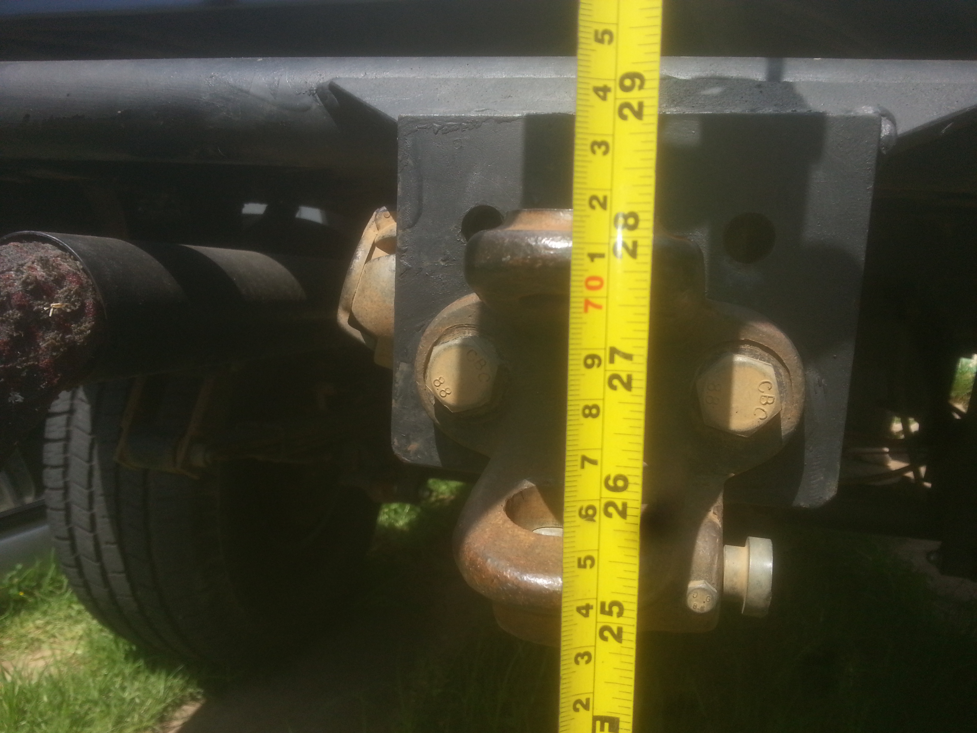

740 Towball height
740 Towball height
I will however only employ a drop plate that long if I can pull supports back to the chassis to support it. Something like the Discovery has.

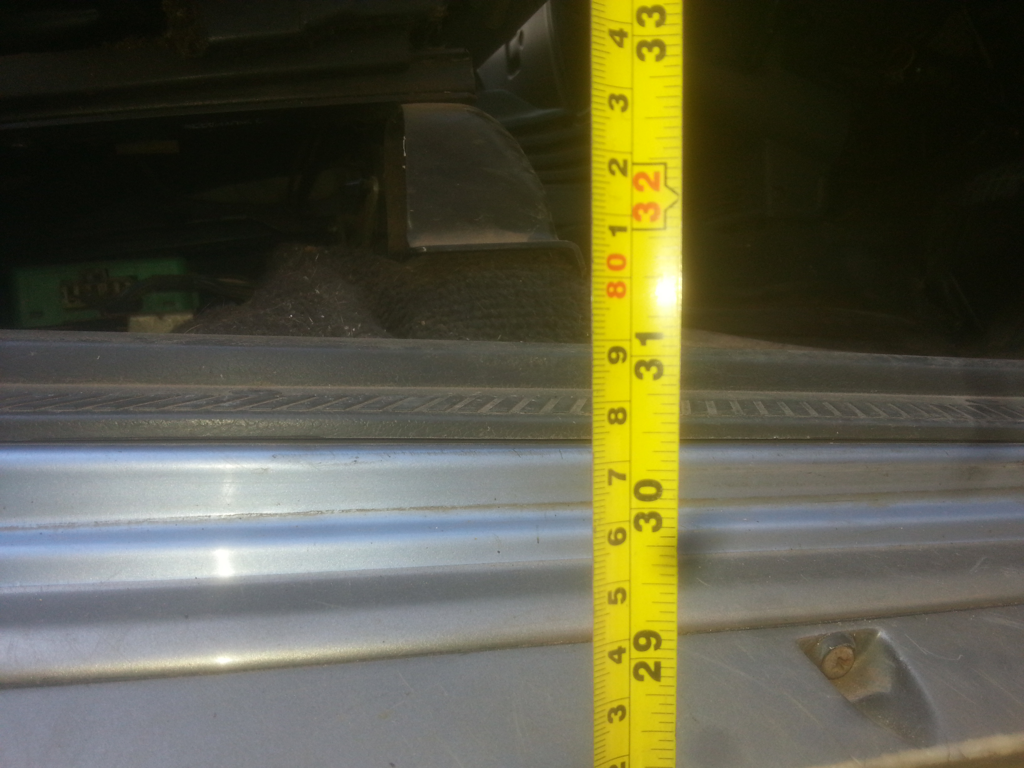

Some other interesting measurements....

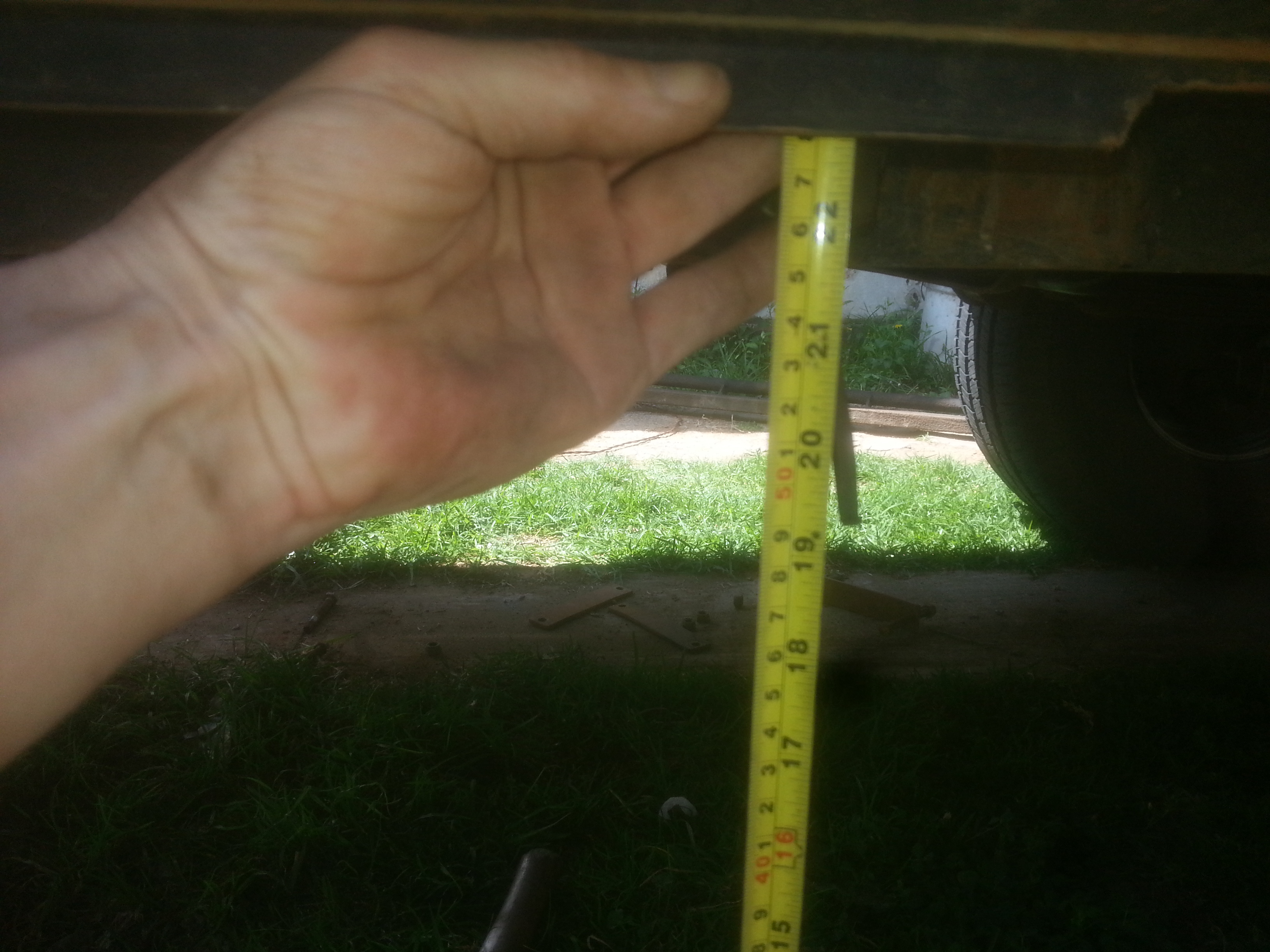

Lowest part of chassis to the ground
Floor height

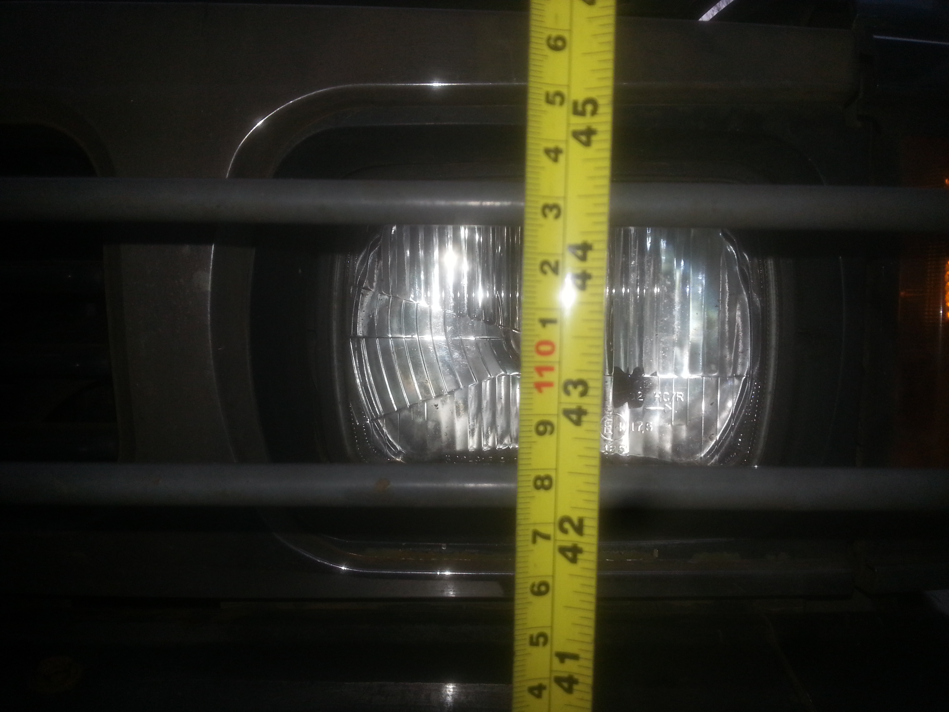

Centre of head light

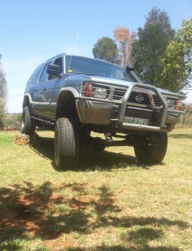

Is this my new wading depth :rolling: :rolling: :woo: :blonde:

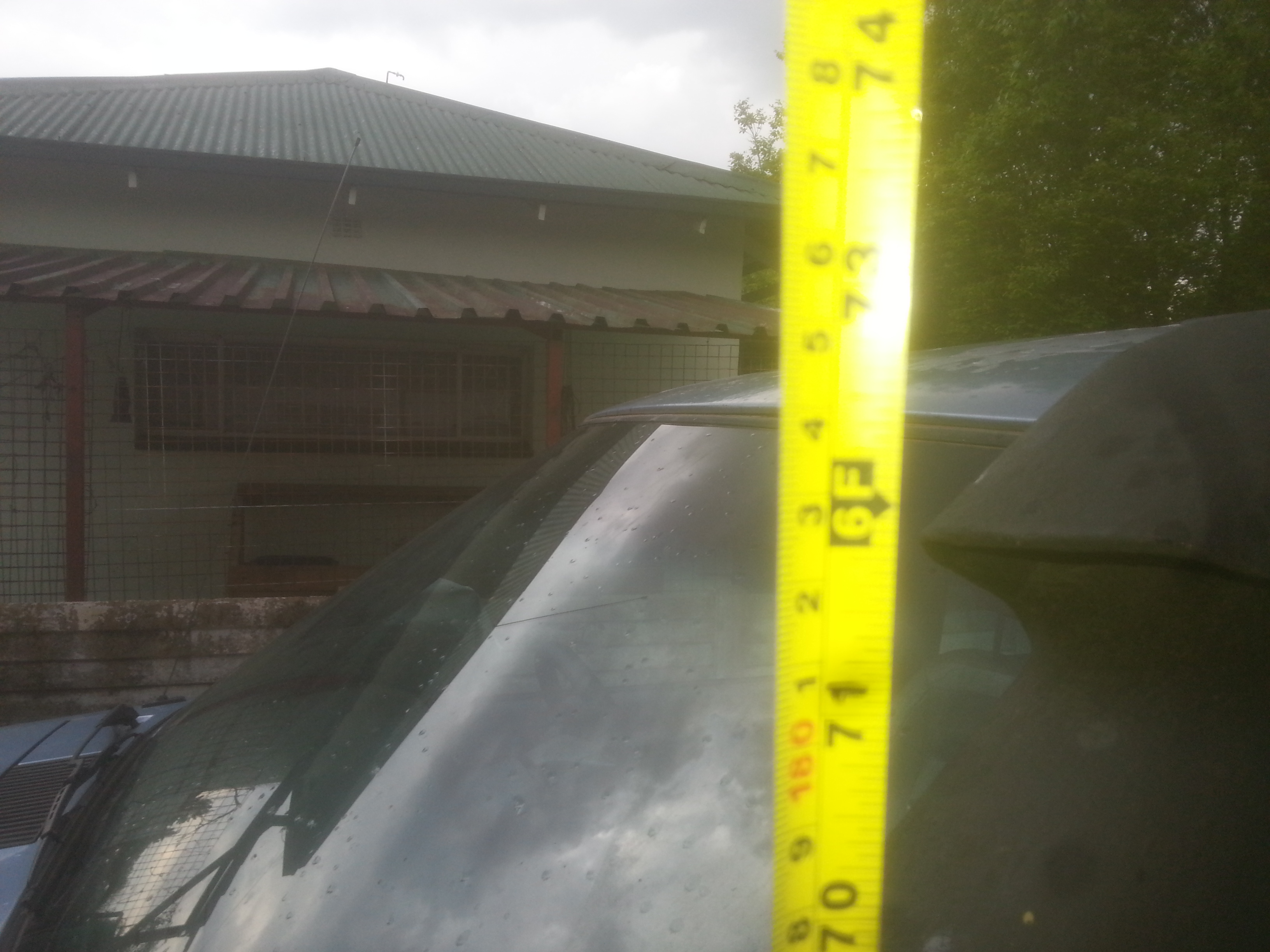

Snorkel head height
Snorkel head height
Its all good fun, but fairly unpractical for daily use at the moment because it still handles like a pig in a snow storm on Dunlop HTs

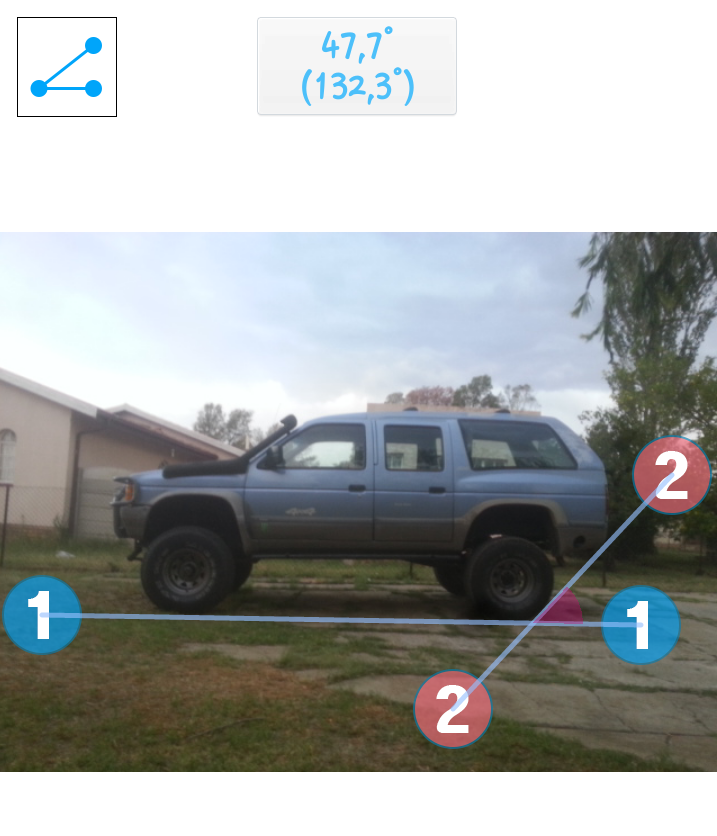

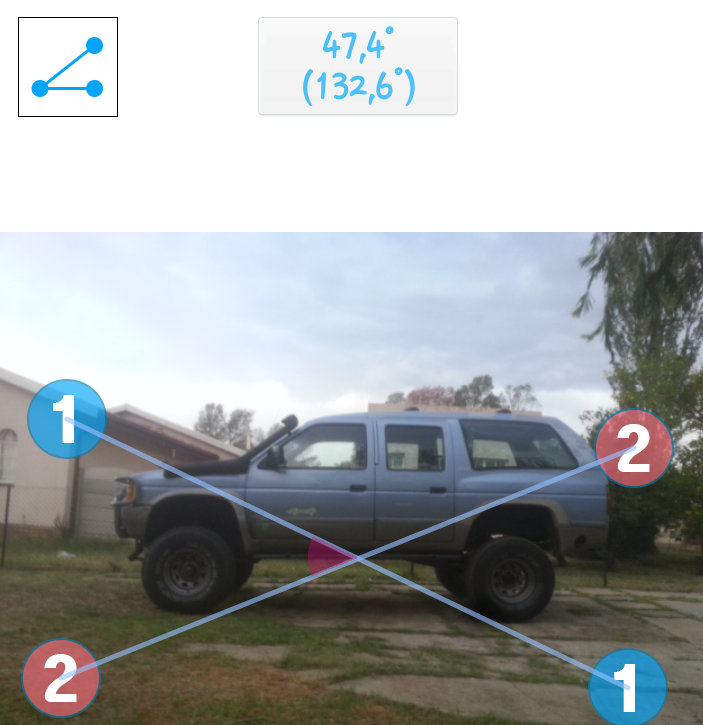

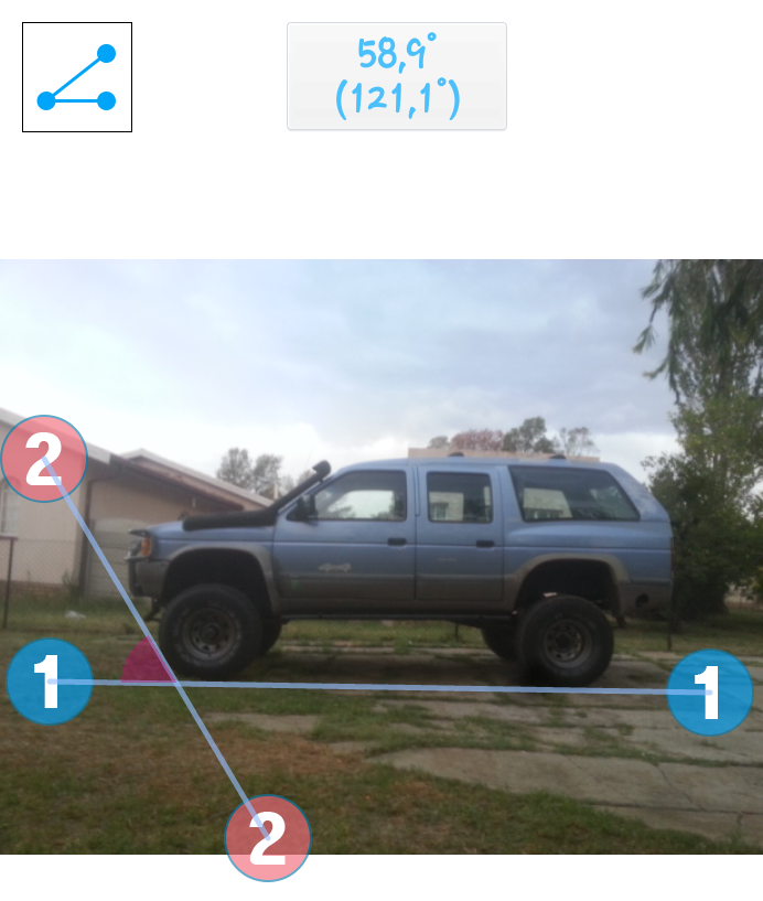

While slowly moving my things between two towns, I find my new house has this little bump in the back yard... Sani still only 2x4, but don't think I got anywhere close to loosing traction.
2015-12-28 11.07.23.png (383.92 KiB) Viewed 6602 times
Drop out
Drop out
Compressed
Compressed

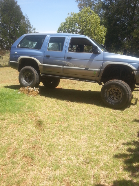

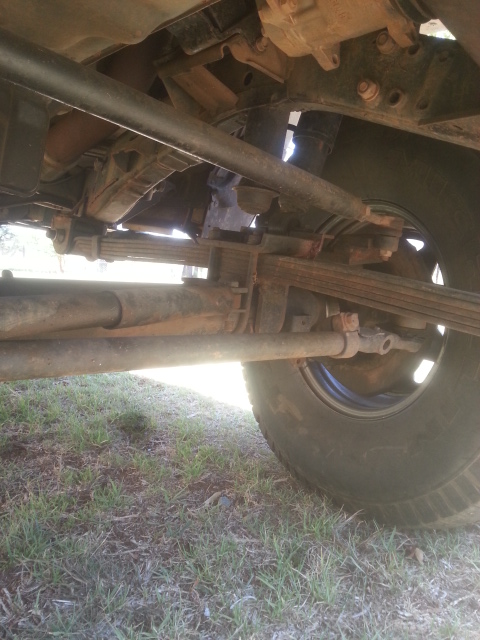

I had pulled the Sani over a bump in the back yard and it looked ok, but I have been wanting to get my garage in a better state to pull out my 500mm high ramps to get things tested in a bit more controlled manner.
This is what happened.
The pics...

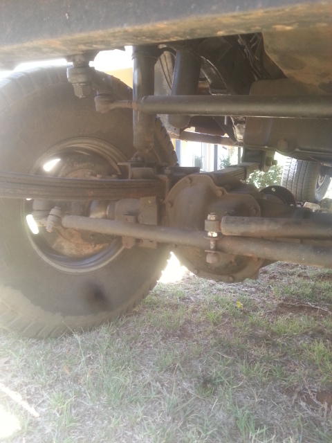

Here is the major problem of getting the MQ to flex under the Sani... Shocks don't have enough travel. These are standard Disco 2 shocks, and with this little flex, I have compressed totally on one side, and fully extended the other side.
Rear end is still Hardbody, so I am not sure how that is going to change once the Patrol Diff is in.
Leaf spring compressed flex on the front...
Rear view
What does make me feel slightly better about the test, is that the left rear wheel ended up in a sand hole of close on 150mm deep. This made the trip up the ramp less successful, but does account for a little more flex than what is initially seen.
Gerrit mentions that there is way to little flex on the rear. Not much has changed that end, besides the 130mm lift blocks that have been added on the each end of the leaf pack, and then a set of Gabriel shocks, from Ians Patrol, has replaced the old Sani shocks while they were moved to new mounting points top and bottom so that they face toward each other instead of being on each side of the diff as it is on the Hardbody.
The leaf springs used up front, are standard Hardbody one tonner packs, with an added military wrap blade to carry the additional weight of the engine.
I have some things in mind for the front end, one of which will be an increase in Castor. Another being the addition of a Panhard rod, and then also a stabiliser. Shock mounts on the diff have been planned below the diff tubes since day one with the use of fleetrider shocks that will give me 375mm range from around 530mm up to 900mm.
The rear end is still a total unknown. The H260 Diff and probably 1,5 times the weight of the little diff that is presently in there. I expect the additional weight is going to change drop out considerably (or am I mistaken). I also wanted to employ revolver drop out shackles to assist articulation, but that’s not a definite yet as I may be running into problems in that the propshaft may not be able to handle the angles already after the nearly 7" lift.
So the question is, at the moment, is the front end too soft, or the rear too hard?
I'm I worried about too many things now when too much could still change by the time everything is complete, and that I should rather just wait until later to "fine tune" these little gremlins.
Keep in mind, this is still my daily drive, so the rubbish handling I have at the moment is somewhat of an issue. I am hoping that the big culprit of the bad handling, is the very small Castor I presently have, and that the increase to around 7 degrease is going to do a lot to fix this. It presently at around 1,5deg.

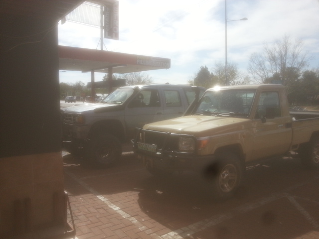

Sunday we had a little get together for the Fathers day thing, and while chatting, one of the guys and I had a disagreement as to the wheel base of the Safari compared to the Sani. As myself and a Safari owner one day got under the two vehicles with a tape measure, I am fairly certain of my "fight".
BUT... while I am fighting my fight, something dawns on me... If the Safari has the same wheel base, the distance from front diff pinion to rear diff pinion through the transfer case, must be the same when installed under the Sani. Suddenly my spirits lift as I am thinking that the costs to modify three propshafts suddenly seems not to be needed anymore.
As soon as I got home, I'm under the Sani with a tape measure.
Now, taking into account that the H260 has a 130mm longer pinion to center of the tube measurement as the C200 diff, and the 4" lift to the transfer case, the Sani needs a total of 70mm more propshaft length with 20mm extension on both the front and rear slip joints on the props.
Damn, why am I out???? I could not figure that a 4" lift would add 70mm, how far do the standard Safari slip joints extend at normal ride height?
Then it hit me, I forgot, that when I turned the leaf pack around on the SFA, the locating pins on the leaf pack were offset to the rear end of the spring. As they are turned backward to carry the front diff, the offset is now to the front of the vehicle. While I was busy with the exercise to locate the front diff, I did some measuring to fit 33" rubber instead of the standard 29".
Nett result was that the Sani ended up with a 60mm longer wheel base than it had on the IFS. Add the 4" lift of the transfer case, and my rough measurements of 70mm longer propshaft distance started making sense.
The placement of the transfer case also works out very nicely through my rough measurements. I wanted to cut the tube out between the two UJ's on the connecting prop between the two transfer cases. But it looks like a 30mm tube will be needed to get the Safari TC in just the right place to use the original front propshaft as is.
This is a major budget score, with the guys quoting me around R2K per shaft to modify. If I can get away with the modification of the connecting prop, and get the Sani running front wheel drive, it does not have to be taken off the road while I sit with no propshafts to drive the thing.
The rear angles are fairly steep, and I wanted to go Double Cardin on at least one end of the rear shaft anyway. To fit the DC into the shaft, they have to cut the length down, so all this can be sorted out at the same time.
Would be a bonus if I could get both front and rear to work as is, but I know I can't pull back the 60mm longer wheel base without cutting body work to fit the tyres in. So that is the price I have to pay. I am wondering about spacers on pinions to make up some extra length, but not sure how far you can push with spacers.
Can a Safari guy maybe tell me how far your slip joints are extended please, and how far you could let them extend before they cause problems. I have not pulled any of mine all the way out to see how long they are, I'm just plain scared I am going to break something.
